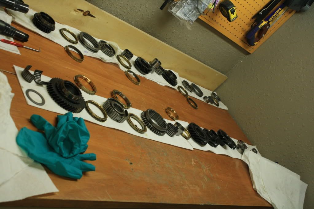

Nice trick with the string to keep track of the parts...Noted for future reference fo sho...

Cleaned all the parts, but the bearings on the diff. Was going to assemble it tonight but I decided I should go out with the nurses instead. Life is hard

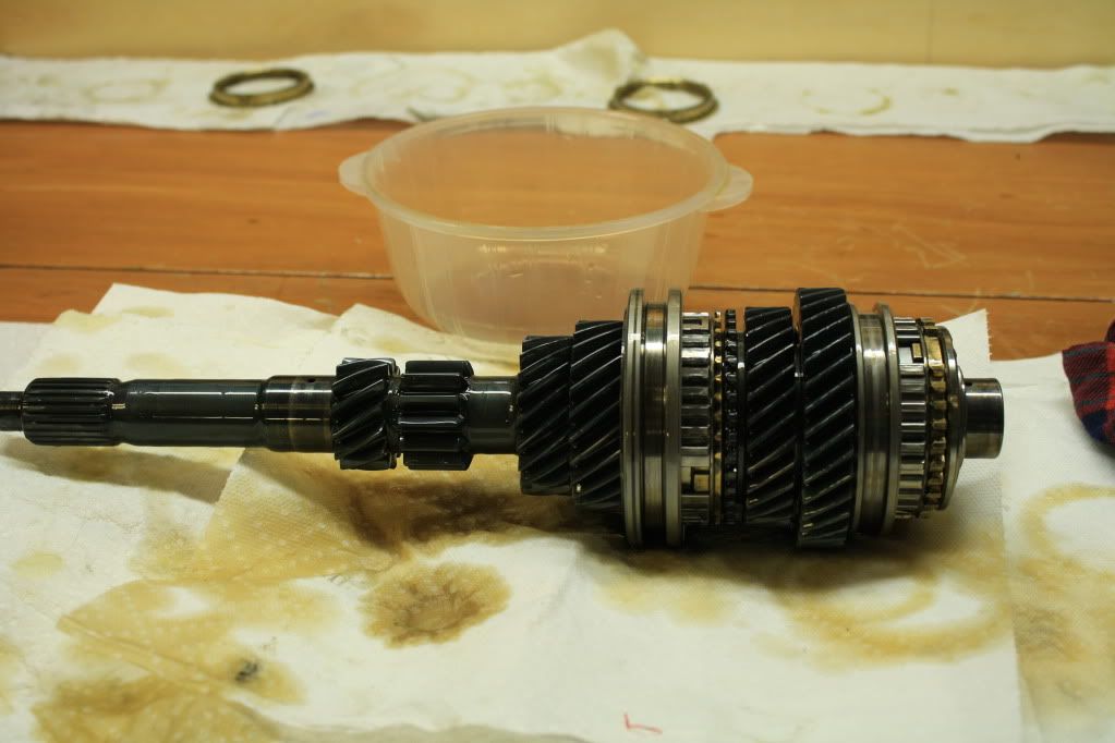

Put together and balling in 2 hrs before I went out.

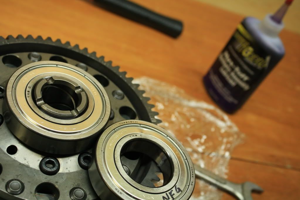

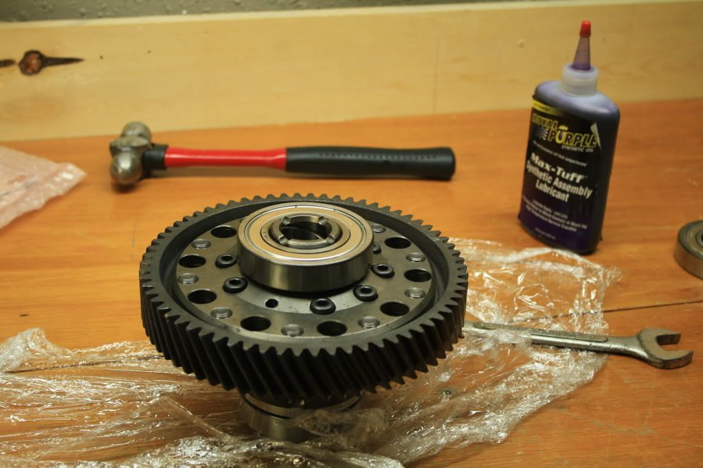

I fucked up the race on the one diff bearing putting it on. I thought it should have went down farther than it did. Now I need to pull that bearing and throw on another one. Good thing I ordered 4  :yes:

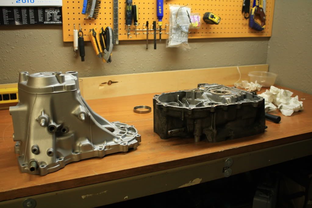

Left is painted cast alum. right is just pressure washed and degreased

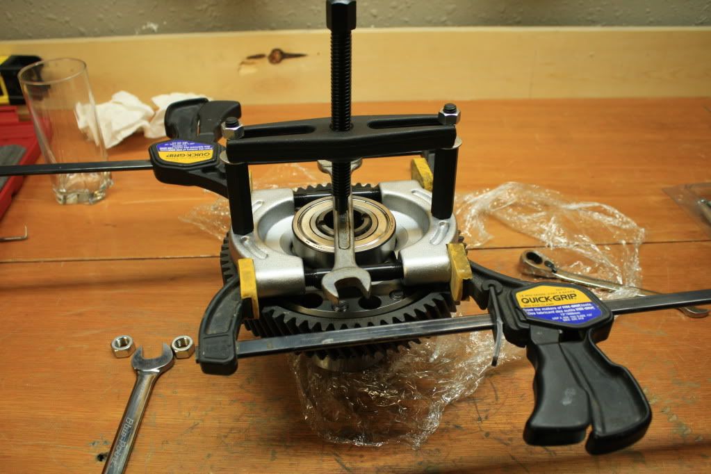

HOW TO USE A PROPER TOOL IMPROPERLY
worked though
Broken race and new bearing

Case actually turned out pretty bitchen.
fucking awsome, I just use two small prybars but watch the speed sensor gear.

And I always just took a grinder and cut the old bearing off, only if it was fucked to begin with....D-Rail I think still has my kit....hmmm going to call the nog and see whats up
« Last Edit: April 11, 2010, 05:03:34 PM by widebody93 »
Bearing press takes 5 minutes
4minutes of that is setting it up
my number will never change. Same number for 8 years
go buy some 6.5" 1/2in bolts.
makes using the puller a lot easier.

Forgot a little something that I need to measure speed................ Put it on and repressed the bearing.
