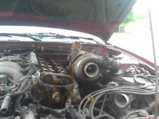

so I sold the miata and made bank on it (3000$ profit) so I bought a semi beater 240 that needs timing chains. ordered a bunch of turbo stuff and pulled a turbo off a 6.5 gm diesel. Going MS for fuel/spark and crank on the stock KA till it blows then build it.
Hoping to rip off a 10 sec pass with the stock motor. Guys have gone 10.80s with 380rwhp and everyone has a different opinion on what the stock motor will take.
Oh and the flux core will be rampent in this build.
Car is auto btw but I have some down and dirty cheap tricks to make it shift like a built turbo 350.

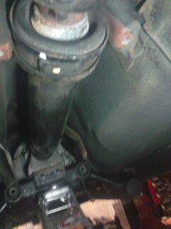

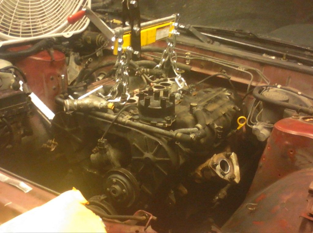

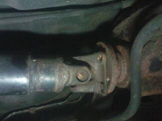

Ok so for an update I get to work on the car when I can but here goes.
I was going to turbo the motor in fact I still might however I have myself a sweet m90/vg30 tbi manifold in minty shape and a machine shop at my disposal. SO its getting a belt and a set of long tubes. Even more bizzare is i am making it carbed. I have learned to love the holley 4bbl and know every inch of its opperation so its going draw thru.
The trans is getting sent out to a local shop at the expense of setting up a draw thru turbo grass drag sled with his son. Full rebuild with "tricks"
The driveshaft pictured is the stock 240sx yup it fits like a glove I was a bit worried but was amazed it slid in.
I had to modify my rear sump pan by chopping about 2.5" out of the sump. I am either going to make kickouts for it or run a big -16 line from a side of it to a surge tank of sorts.

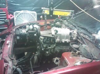

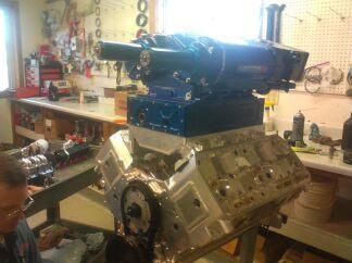

I think this counts as porn. We are building a set at work for a 44ft race boat twin whipple 4L blowers on top of 623ci billet hemi this is an old pic I will snap a new one soon.

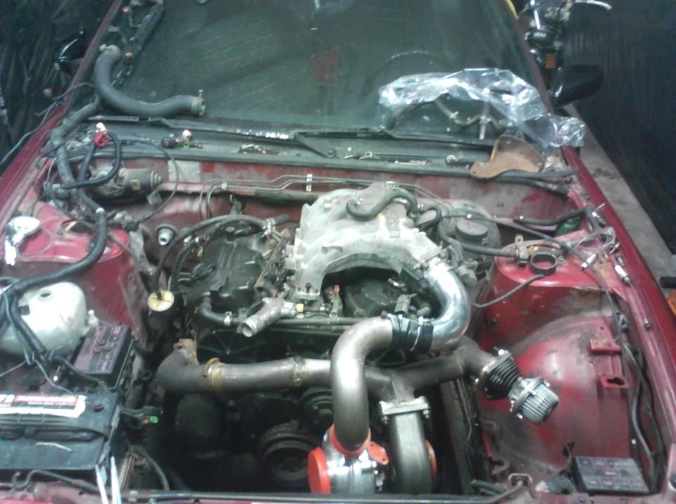

SO enough about the bullshit, I changed directions yet again. TURBO is def the way to go. Its got the best parts china has to offer. I am a cheap bastard so the manifold tubing was a leftover viper exhaust actually. very nice quality. I am hustling to get this done before family takes over so its consuming copious amounts of my time. I still plan to strip all the wiring out of the car and wire it up simple like it should be. who the fuck needs 40 shades of dash lights anyways. Oh and seeing is how gas has skyrocketed and e85 is made 20 min from my door stop you get where I am going.

Re: the new project UPDATE! Vg30e 70mm
« Reply #21 on: September 29, 2012, 04:09:51 AM »
Looking good. Interesting wastegate placement and no overcomplicated shit
Have you tested the hood fitment with that intake yet?
Using stock relays to wire your harness up?  It's better to go ms like you were talking about instead of trying to wire up a stock ecu....unless you have nistune or get a jim rape technologies ecu.  I'm forcing my hand in that direction as of this past week.  *sigh* It would make the swap way easier.   If you need help finding oem turbo and na bin files for a starting point, lmk.
Keep up the good work!!  You're kicking my ass right now but i'm about to catch up suckaaaaaa!
