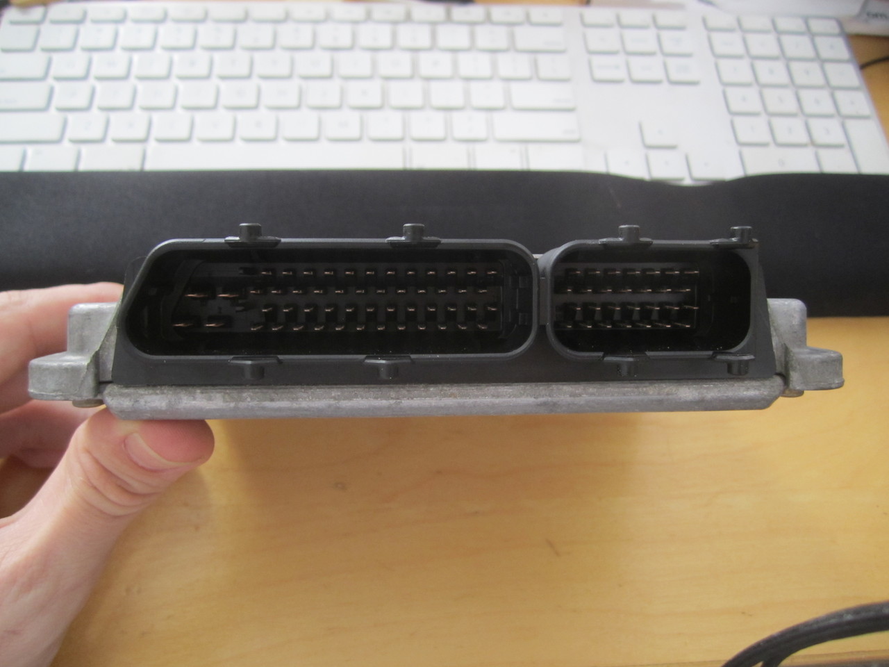

It is there, but doesn't look like that, faces the other way and has two connectors. Or should I say it WAS there! Got it here now! They do hide them under the cover below the windscreen in the LHD driver's side. Access with hands + levering device to bend locking tab out of the way. Very easy once you know where it is :-)

I am/will be. I just need a pin out and connector/case and it's a matter of hours/days. They're very very easy.
New question, though, if anyone can link a euro-diesel noob and save a busy man some time:
Where can I get the pin out for the ECU?
Codes from it are:
038 906 018 FB
DIESEL EDC15V 2170
<barcode>
BOSCH
0 281 010 006 / 0281010006

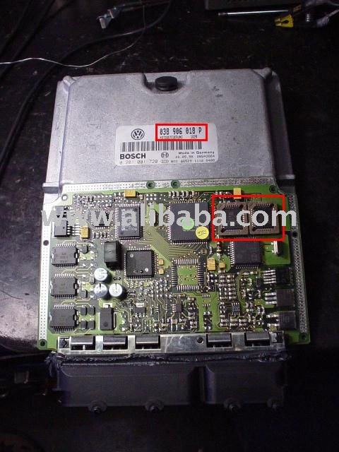

And it looks JUST like this, though I didn't and likely won't open this one:
