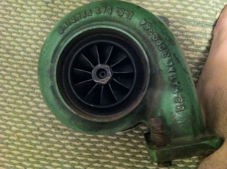

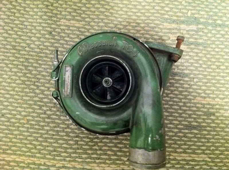

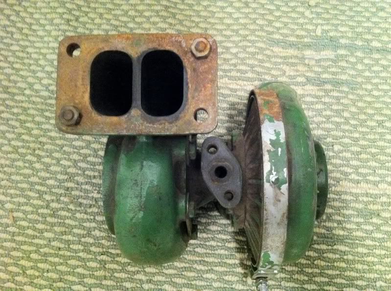

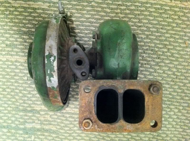

would any of you niggers run this bitch on a sohc d series. probably gonna start on a d15b8/y8 d then built vitara d16a6.
as long as i can figure out the exhaust situation i should be running it. dont know much about this damn thing except it came off a john deer tractor.
divided t4 hotside 1.0AR with a .60AR coldside. should spool by 5-6k im thinking.

anyways, ive never personally seen anything larger than a HX40 on a d series. i think this one might just be pushing the limits of the exhaust flow on the little fuckers. either gonna run it and hate it, or find a t3 instead and swap the compressor housing/wheel and have the bitch rebalanced.

T04B on a D-series = 425hp max.  :noel:
HX40 on a D-series =500+ max, so fuck you.   :?:

It will spool like crazy, when it does. Kinda like hitting nitrous at 6k on a stock sohc, retarded.
Run an ebay T3 with the d15, then use this turbo when you have a fully built (block and head) D16 read to go. By then you'll hopefully find a better t3-based turbo.
