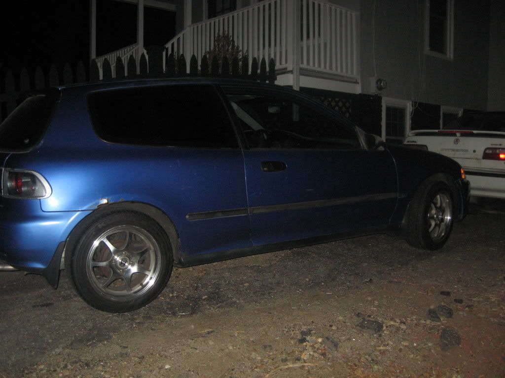

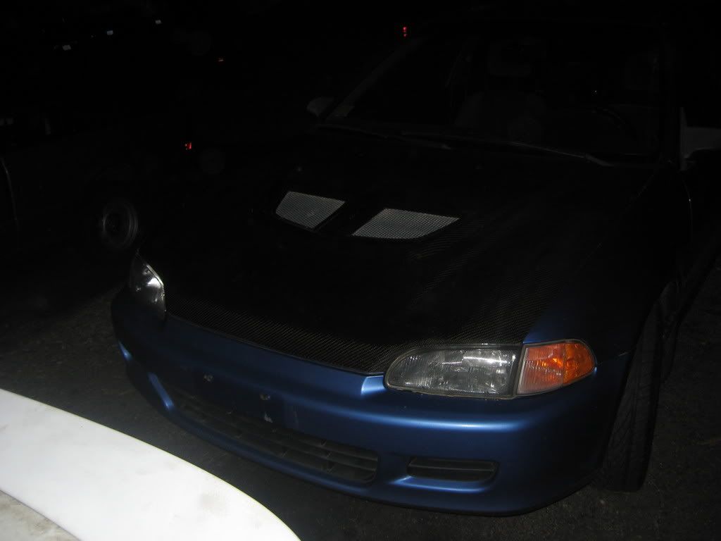

i started with a 99 si now moved on to a 93 dx hatch due to inspection and cracking frame ect  sold the coupe shell for 1500 and bought the hatch for 1400 bone stock except carbon hood and wheels.

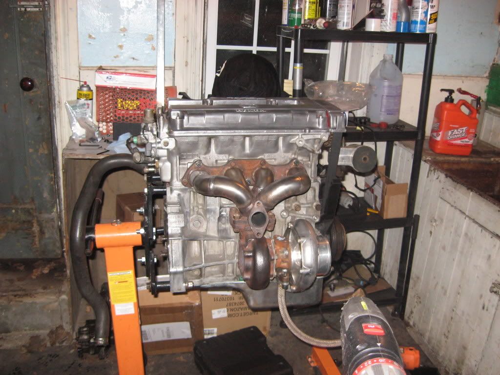

Basicly last year i made 301.9 hp at 16psi street tuned by my self crome pro style
i want at least 350 on pump 15-17psi and 400+ on Race fuel 20+psi this year parts list.

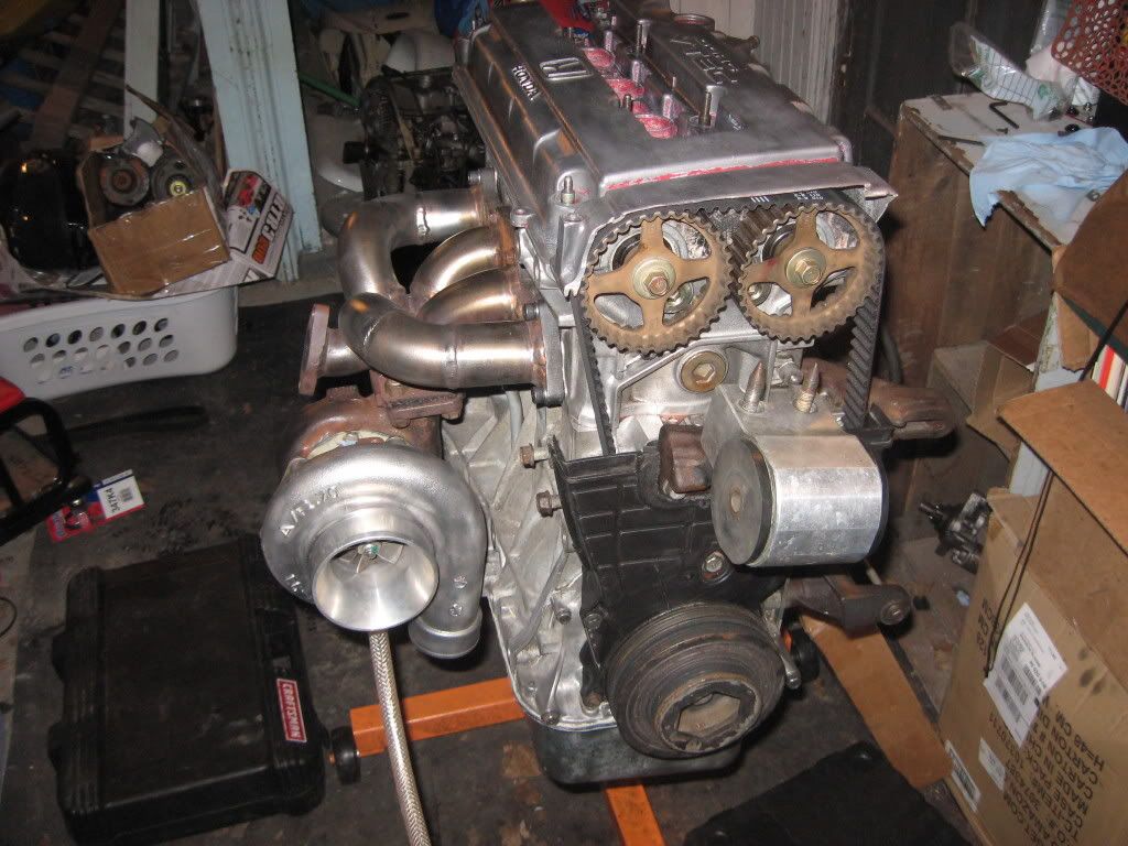

b16a2 81.5mm eagles and weisco
ID 1000cc injectors
GM 3-bar
stock head gsr cams < The fucking Killer IMO
tuner toys mini ram
custom 3" exhaust and downpipe
garrett T3/T4 60-1 stage 5 wheel S.cover w 63 are exhaust
motor street tuned they cleaned up on dyno by me using ECtune this year ;D
This was my first built project motor was assembled by me has about 10k on it from last year best time was 13.1@109 im hoping for 11's this year.
old Whipp
New platform.
The day i bought it.
Dont have any recent pix but now mesh is painted black and is lowerd with ground control coilovers.
Shit ive been working on
ek console climate control will be moved down and guages put were it use to be
Now my bitch new things this year oem timing belt headgasket new front and rear main seals $200 ls tranny turbo and injectors.
now the block can breath.
Will update as new shit happens trying to install motor in 2weeks.

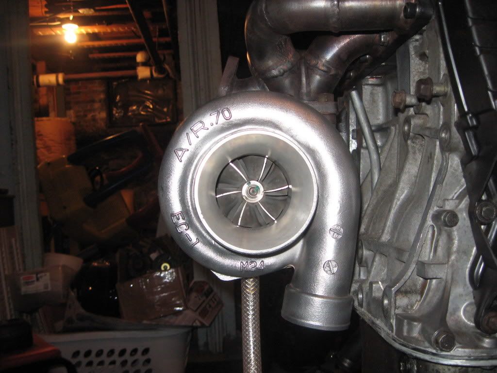

That new turbo is sweet!  Be sure to let me know when this is getting installed,  so I can come thru and help out....

Damn i love the turbo. Man if you need help i could at least be the water boy for you and chuck. By the way whats up with the bumper?
You have to start somewhere
Re: lilpooh's 09 build 56k no-way
« Reply #5 on: May 04, 2009, 01:25:32 PM »

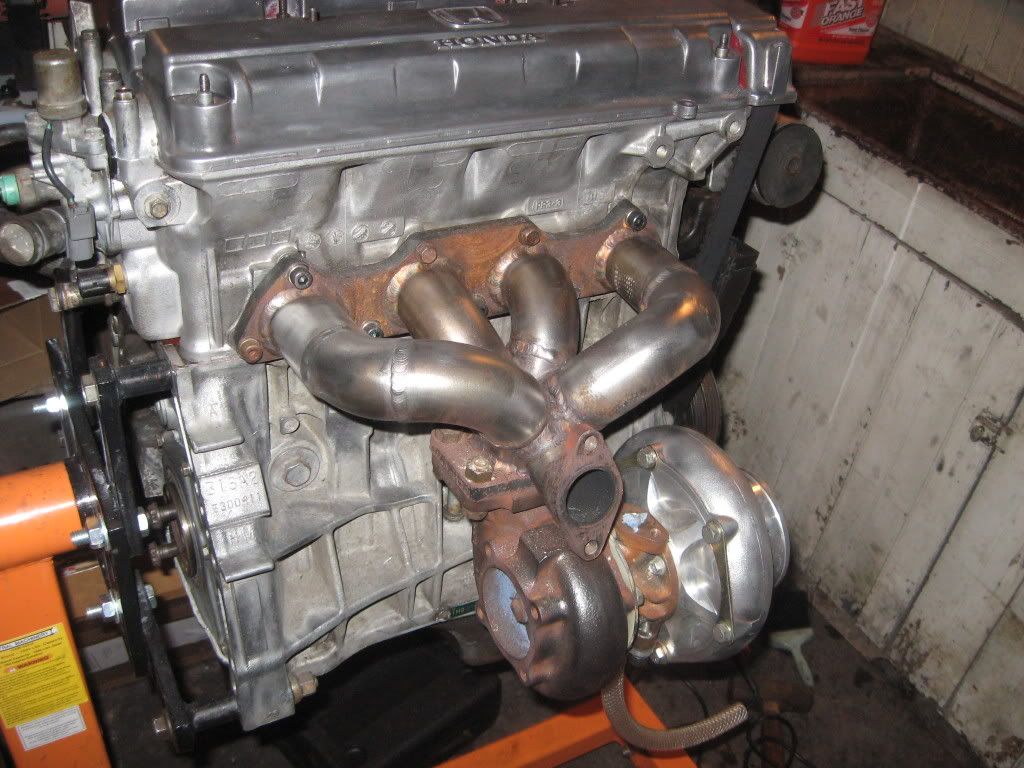

I don't think i'd run that braided nylon hose for oil drainage  :?:
« Reply #6 on: May 04, 2009, 02:41:48 PM »
it looks like he is just using it for a test fit, otherwise your going to burn through that shit in a couple runs mufassa
lilpooh21186
  • Posts: 1801
« Reply #7 on: May 04, 2009, 04:45:41 PM »
i was gunna use it good looking ??? ive seen other builds with it thought bee good to use so i can see my drain quality
Ecu chipping
basmaps
« Reply #8 on: May 04, 2009, 07:59:16 PM »
Get good hose for that shit, those are for refreshing cool water and shit, it gets REALLY soft under all that heat so watch it real close if you are gonna try it... I wouldn't even idle with that bitch on considering you got such a nice build around it. Goodyear red hose from vatozone is like 3$ man.
lilpooh21186
  • Posts: 1801
« Reply #9 on: May 04, 2009, 10:04:01 PM »
guess ill just use my braded will the shit hold up for my catch can setup's
Ecu chipping
basmaps
« Reply #10 on: May 04, 2009, 10:32:55 PM »
absolutely its good for that, and like you said you can see through it  O0

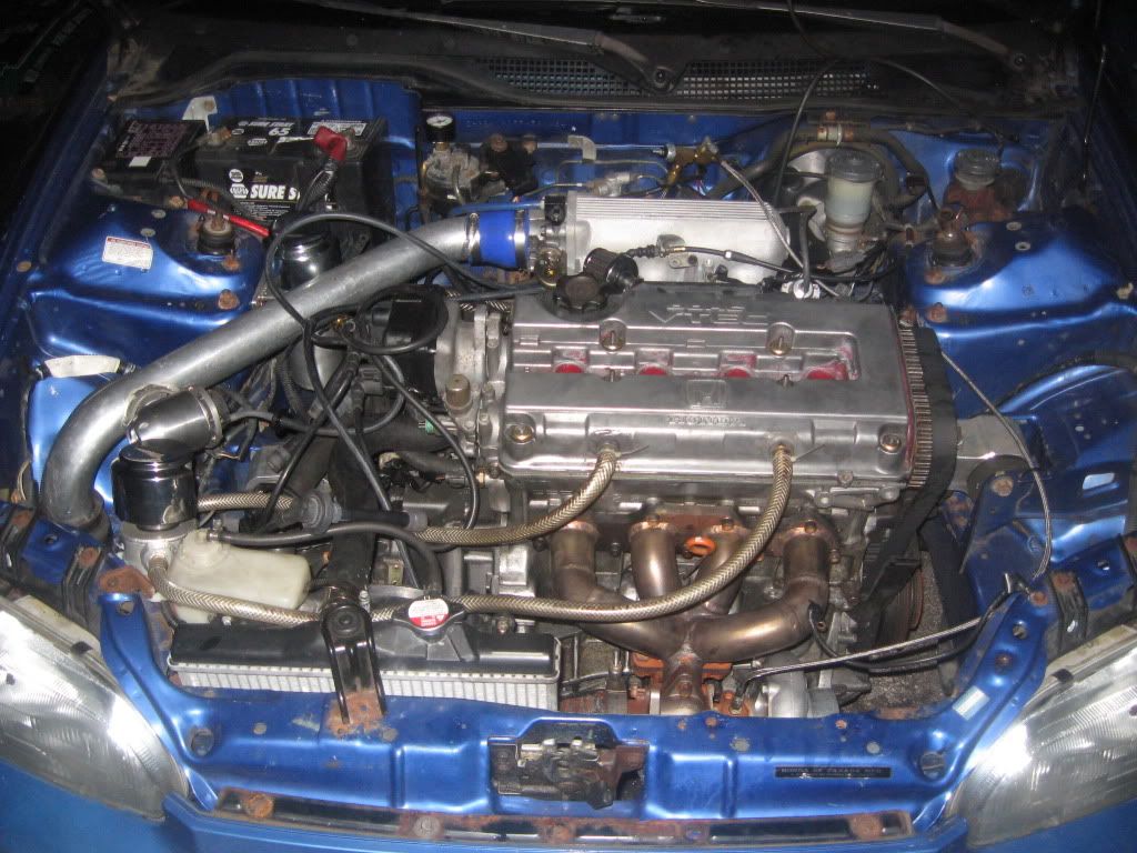

Get off my boys nuttz you homo.....   The motor is in the car.....  Waiting for that laptop that everyone in Rhode Island is waiting for...............I'm next....

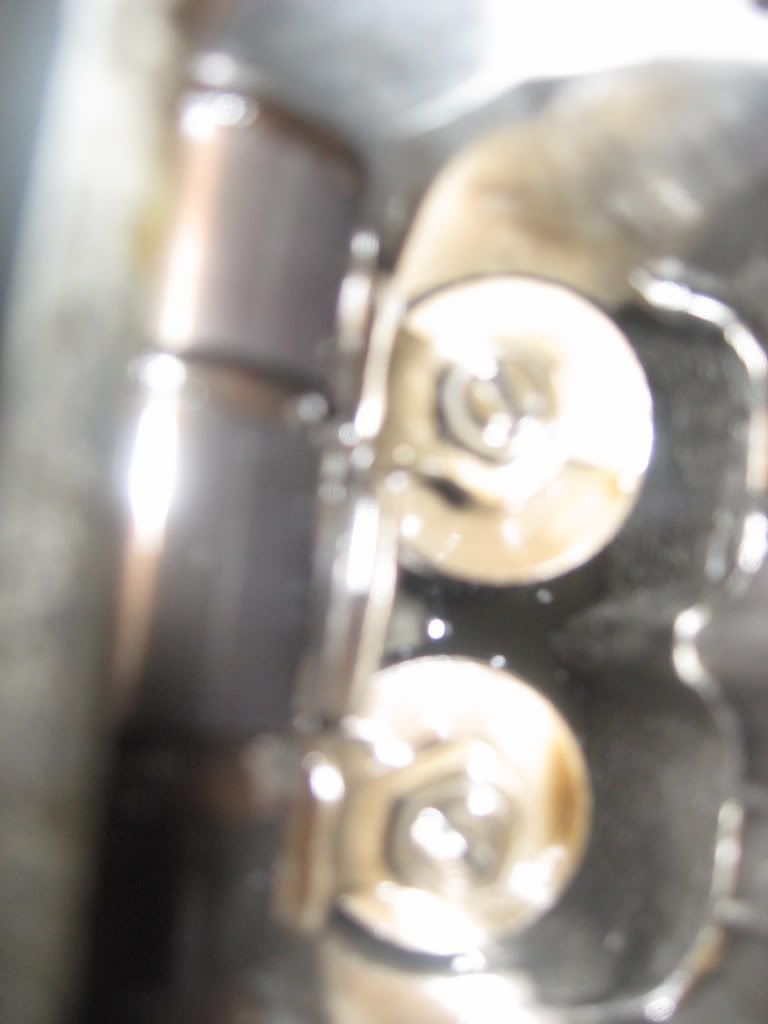

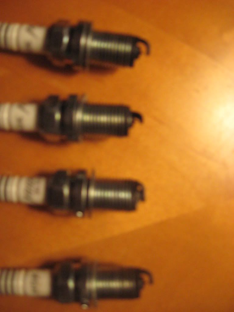

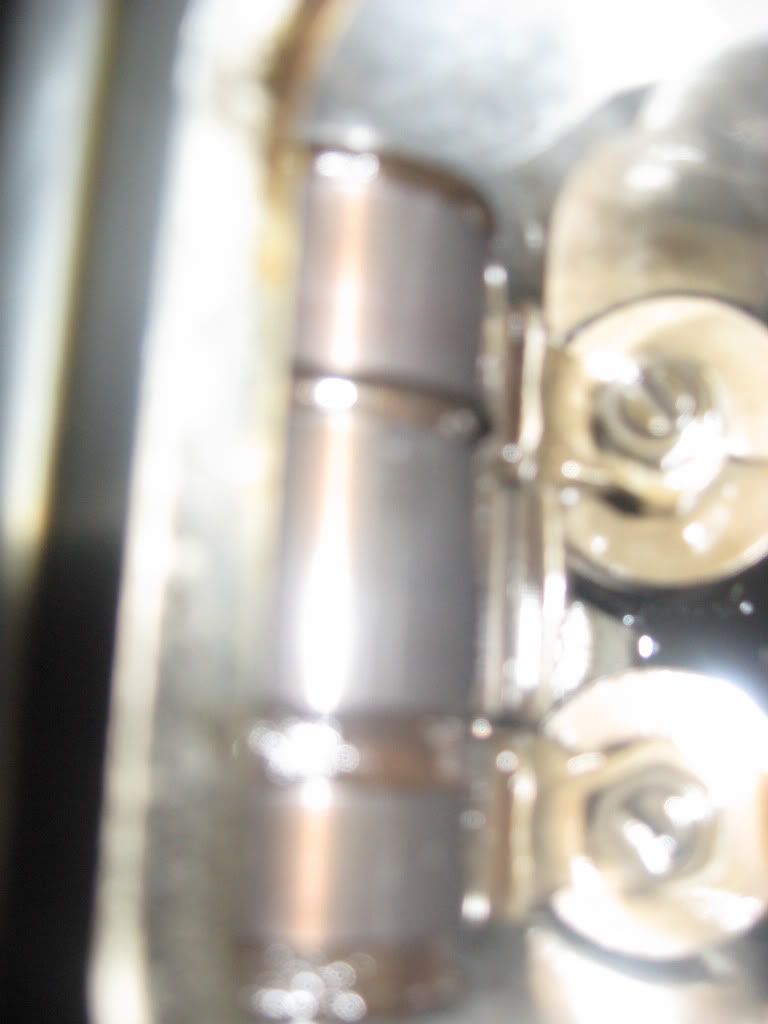

well here pretty much what she looked like all finished up

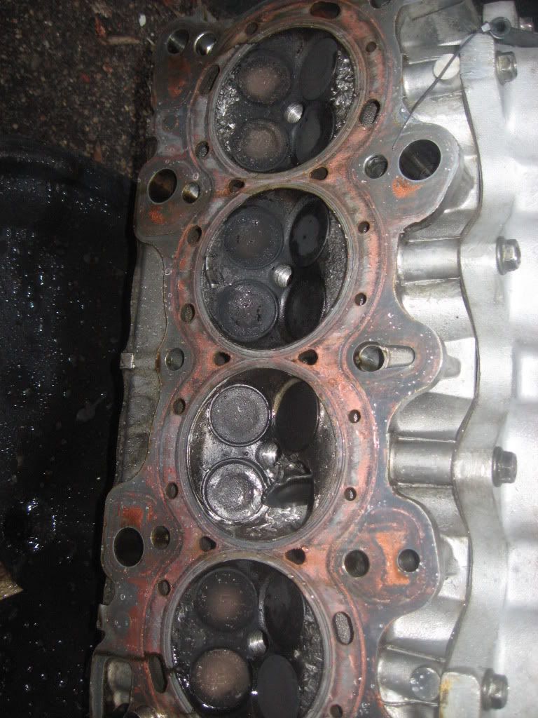

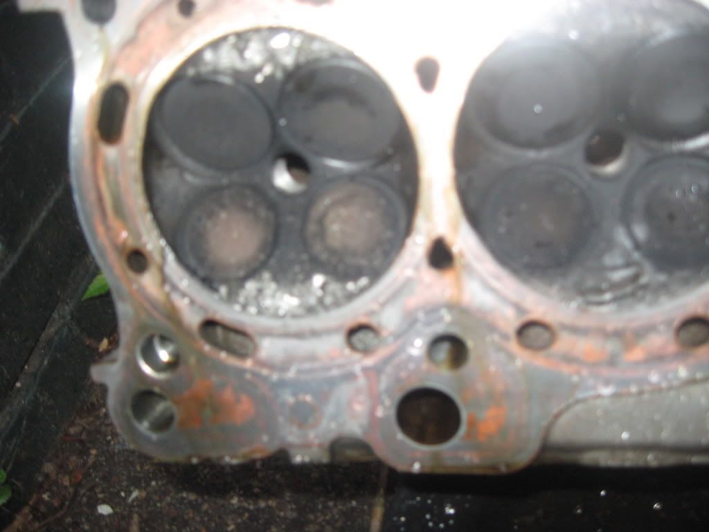

basicly i comes down to doing 3 40 roll's my spinning missed third bouncing off the revlimit 87ish the grab third quick pull loss of power. cylenders from left to right. more pix when the head comes off. kind of hard to see but basicly i pulled #3 the ground strap was pressed flat an intake retainer is split in half  O0

Re: end of game thanks to all who helped *carnage inside*
« Reply #19 on: July 23, 2009, 09:24:10 AM »
I cant make out the pics, what broke?
lilpooh21186
  • Posts: 1801
« Reply #20 on: July 23, 2009, 09:27:29 AM »
not exactly sure yet cylender 3 plug was flattend with a gash taken out of it an 1 of my intake valve retainers is split in half so im thinking a valve dropped and the piston smacked the valve. the car drove for about 3 mi fucked up but it wouldnt idle then i just shut off and wouldnt start back up.

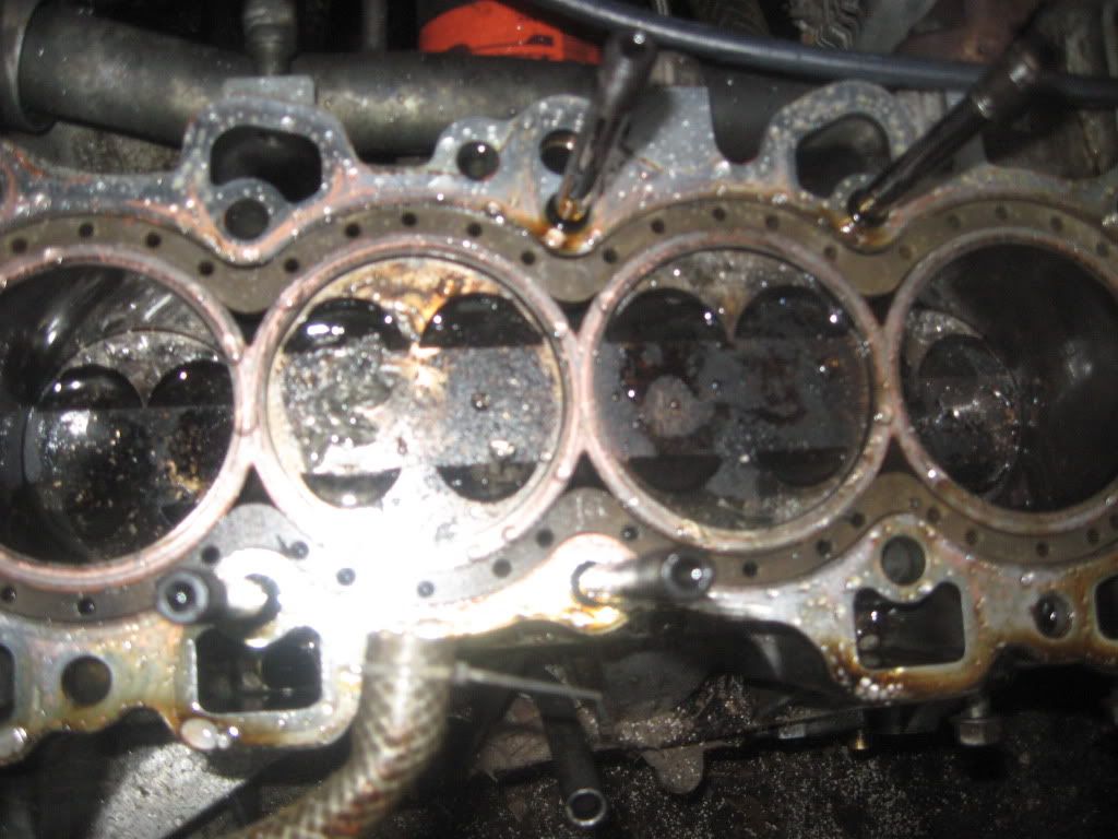

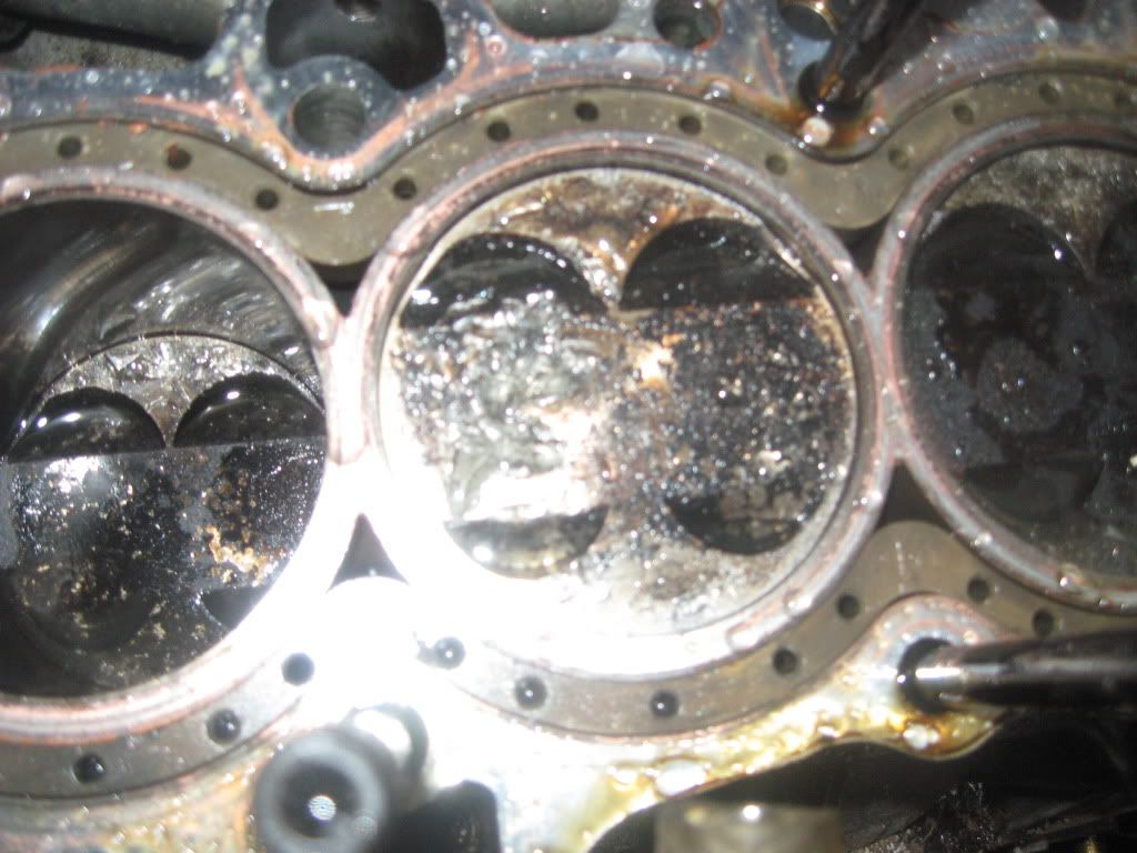

just as i thought a valve took a shit sent metal to the other 3 cylenders #2 got a nice scratch in it. may have eaten some ringlands and cranks kindof rough so probly got some bearing problems too. ;D  JD the block didnt break  O0 :noel: B16 blocks FTMFW

Damn that head is done. What valves where those?
lilpooh21186
  • Posts: 1801
stock valves i revved 9k last year everyday but they only took 8700 this year mabey it was the gsr cam's or ignition cut rather than fuel cut it did get violent at the limit.
« Last Edit: July 23, 2009, 11:31:08 PM by lilpooh21186 »
Ecu chipping
basmaps
AJxr
  • Posts: 159
  • i aint ur buddy pal
stock springs and retainers and 9k will get you that problem. even with b16 cams.
+1
