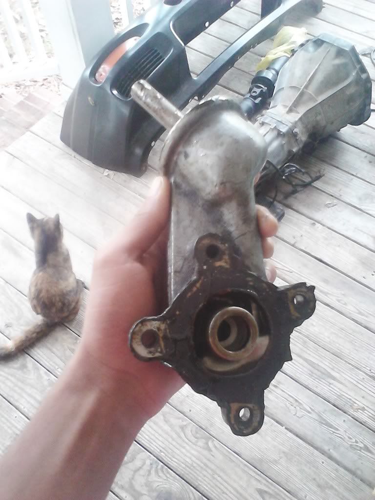

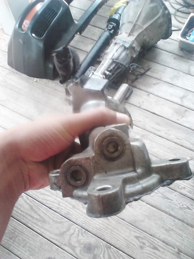

Coil flip not needed.  Center most port is filtered oil.   Other port is unfiltered.....i think.  Sweet.
One less thing to worry about.
Get 90* or 180* adapters, done and done.

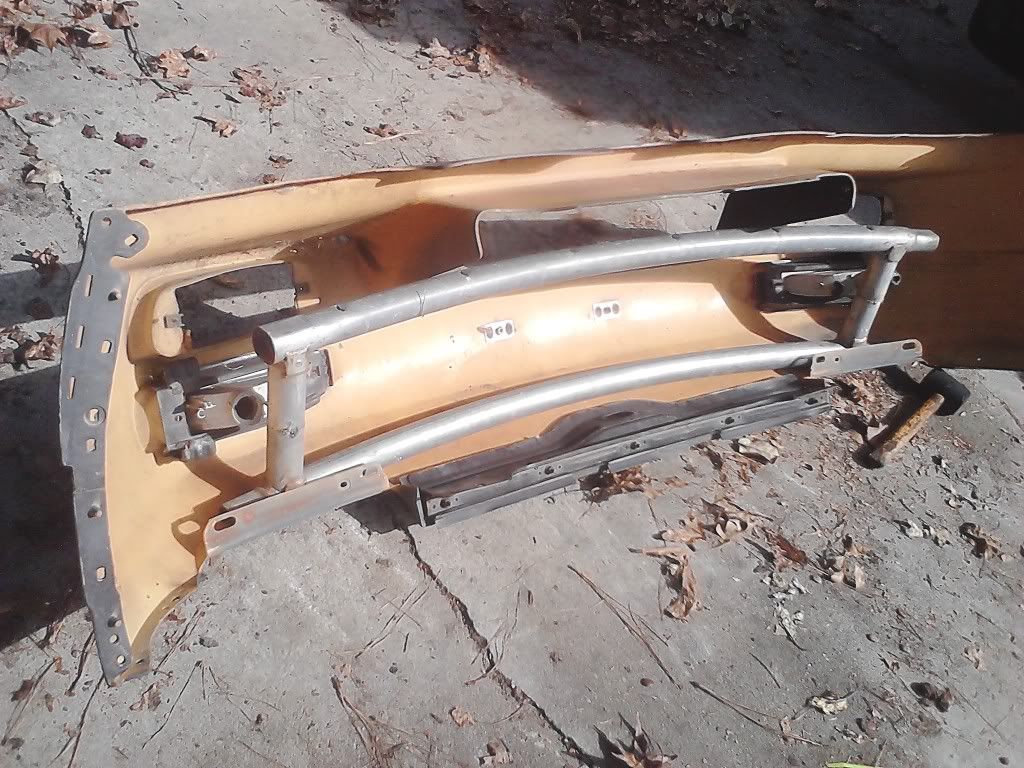

« Reply #212 on: October 21, 2013, 07:23:05 PM »

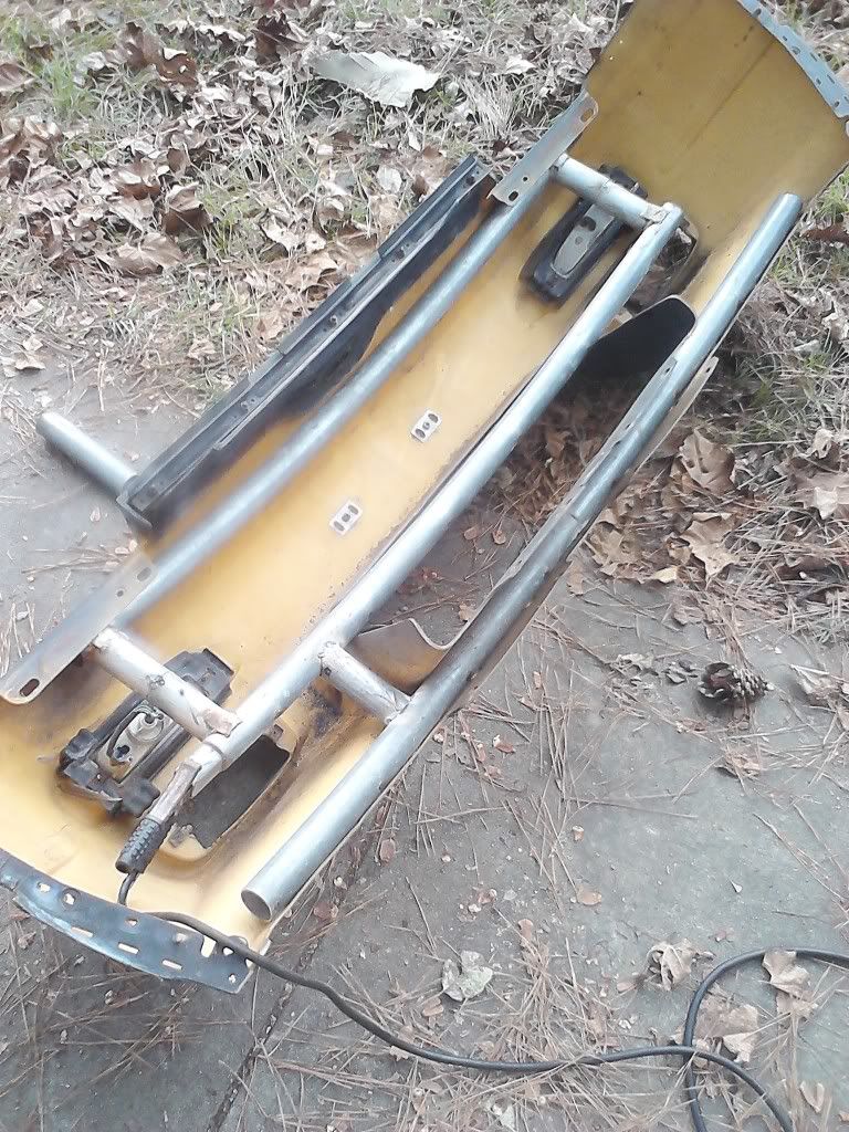

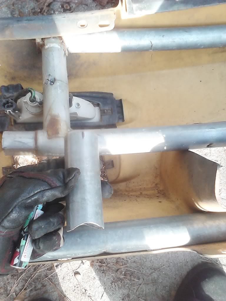

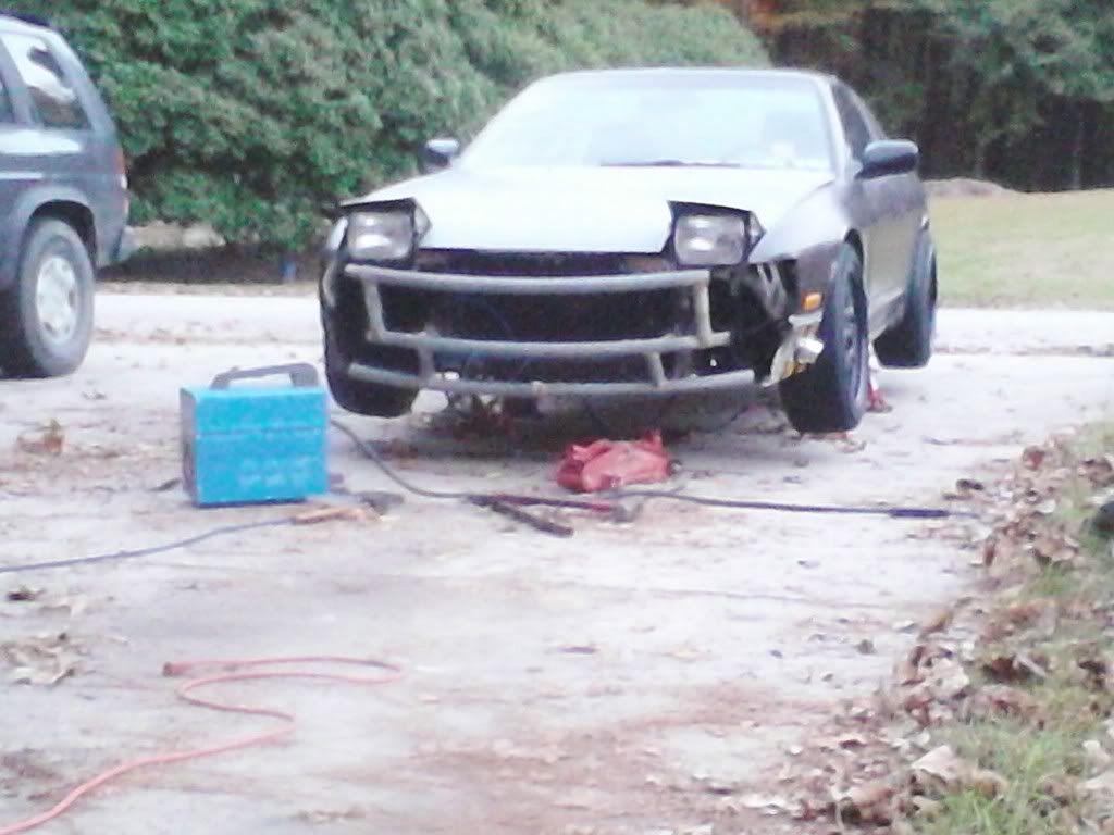

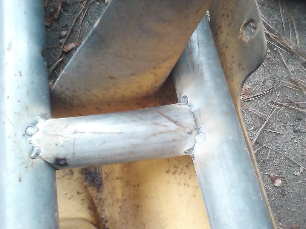

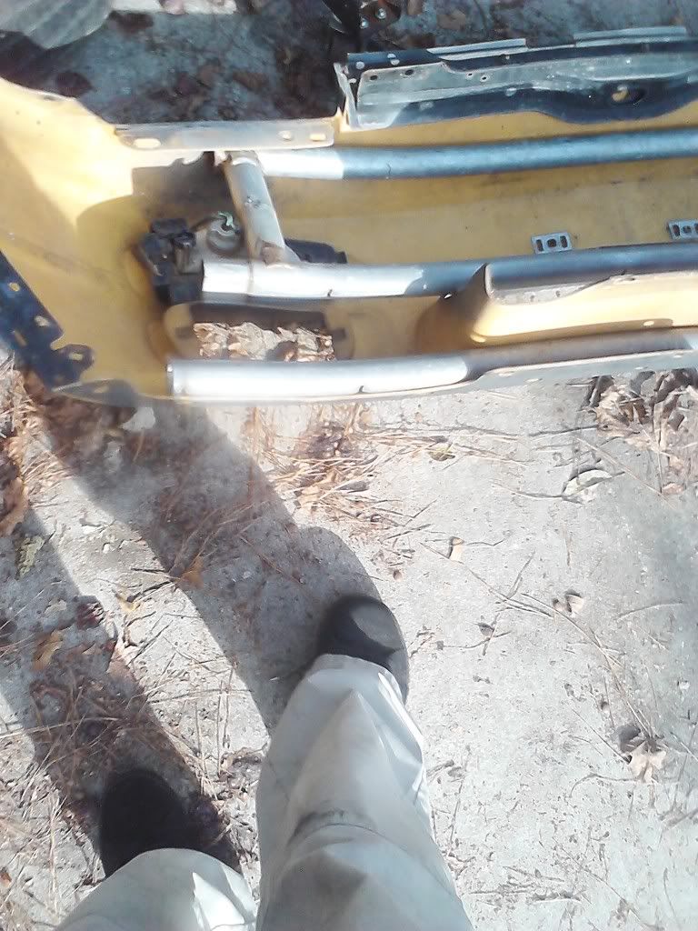

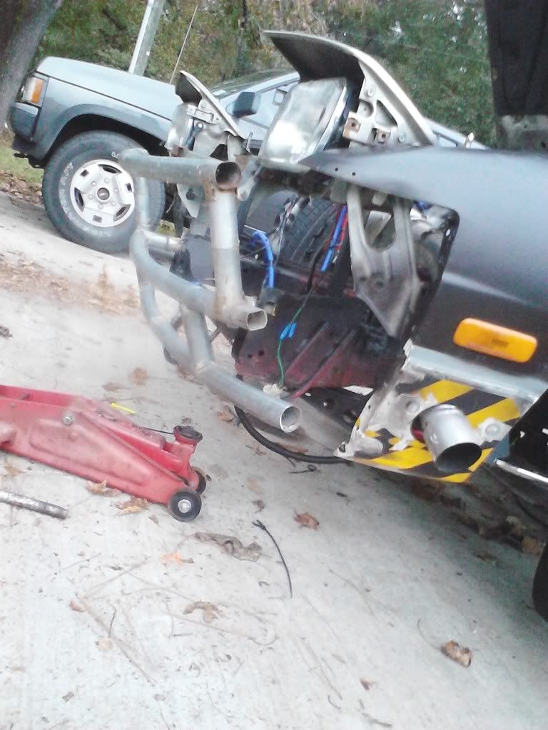

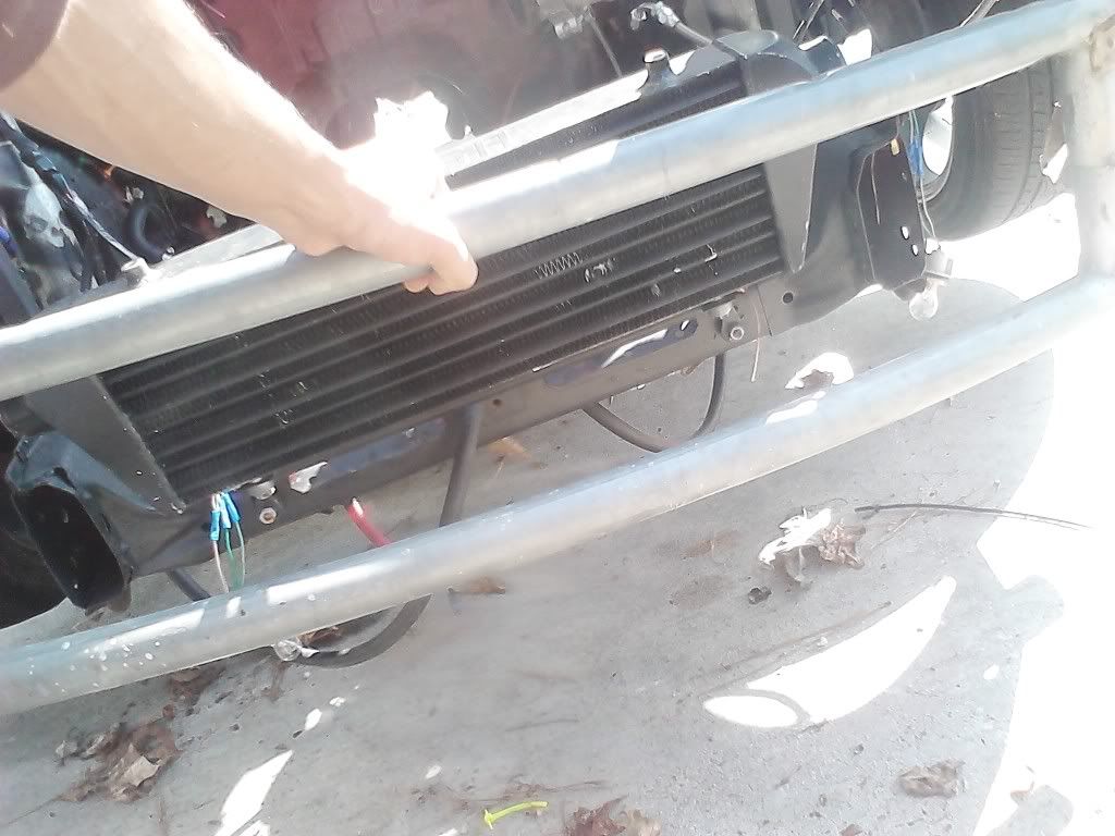

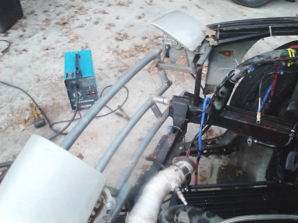

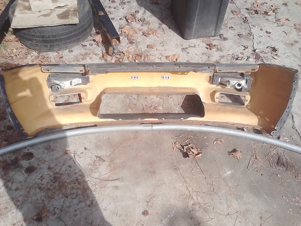

Didn't want to sit around bored on my day off constantly peeking out the window looking for a fed ex truck so i built something to kill deer and other small animals with.  Filling it with concrete when i have time.  =D  Fits nice and close to the bumper.  I have to trim it, cap it, finish welding.  it doesn't unbolt.  Straight welded to the chassis.   I'm stuck running the stock bumper which is fine by me.  Looks good imo.
Luckily this was bent close enough.   Im surprised this all fit without incident.
SUUUPER close.  =D
Like i said, needs some finishing up.  For sure will add elbow gussets and at least a pair of triangular ties to keep it from shifting or breaking during lovey rubbings.

Why didn't you make it bolt in?
Re: Shitty nissan can't lube itself let alone my butthole before rape. Pg7
« Reply #215 on: October 23, 2013, 03:59:30 PM »
This reminds me MadMax  :noel:
NoPistons!
  • Posts: 495
« Reply #216 on: October 24, 2013, 10:48:59 PM »
That was part of the gig.   "If Mel Gibson made a drift car...."
Because the stock bumper support and hardware wasn't included and nobody near me has.   I would have welded the tube structure to the parts that slide into the frame rails after plating them.  Then direct bolt-in using oem with my shit.
Verdict was "fuck it, weld it to the frame and take more time setting your load leveler up correctly for engine moves....."
It's only tacked.  If i welded it firm as is it would probably not serve its intended purpose if i hit something.
« Last Edit: October 24, 2013, 10:56:23 PM by NoPistons! »

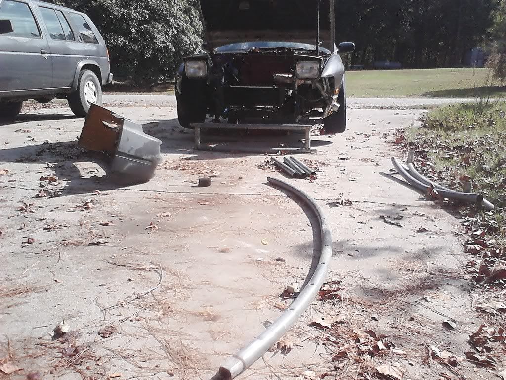

JD, check the date.  That's not my work.   I have a guy down towards the beach who's gonna hook some shit up when i bring the car down there for more tuning.   If i dont have a wastegate by then i'm sure he can hook me up with a used one for a good price.  Very legit dude.

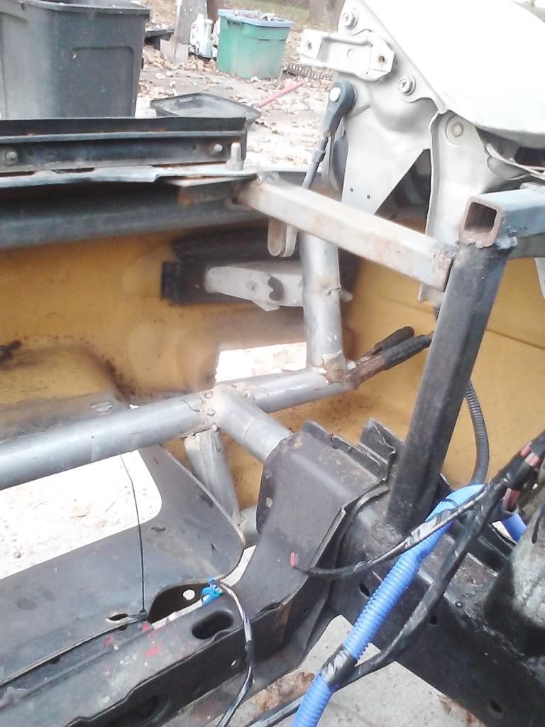

Any pics of the bumper back on with the reinforcement tubing on there? Just curious of the fitment and if it's unnoticeable, looks baller
No sir.  I'll get on that when i can.  It's on the ground in my driveway still tacked up.  The way i was driving i SHOULD have had it welded up and installed.  Lol. I tacked it on the car with my shit bumper on.  Fits nice and tight.  I know after it's fully welded my fenders and shit wont rattle around as much.  2 zip ties and 3 bolts per side is all that's keeping em on the car.....
Edit: bumper is in place.  Nothing from the outside but here's a backside view.  It fits super tight just like intended.  Next go will be with summit ordered .120" wall dom tubing and i'll do all the pipes up on a manual bender. It's a matter of dough to buy tools.  Trust me, i want them but if they dont pay for themselves it's not in the cards so i'll need side work lined up first!

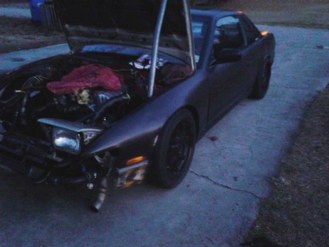

Black friday update:   Drove her again.  Hood off pulling up to the gas station people staring and shit.   I adjusted my wastegate a LITTLE, burnt the fuck out of my fingers accidentally touching the turbine after doing maybe 5-6 pulls around the hood warming it up.  She was at a healthy 177* coolant temp with fan on with that puny ass radiator.  Now she makes 5psi at about 3500rpm.  Slowly cranking the wastegate until i'm making boost lower and lower in revs.
It draws so much vac, check what happens to my volvo couplers.  Fuck these things.  Replacing them asap!
Buddy of mine was like "interesting isn't the word i'd be using to describe that" verbatim.  I dont take this car seriously.  Nobody does and nobody should.  it's all in good fun.   I love driving her.  Few warm up runs.  It's terrible quality.   Hate on my prepaid phone and me not being man enough to steer with my knee while i shift.  She doesn't torque steer.  Just sweatpants on woodgrain aint safe.

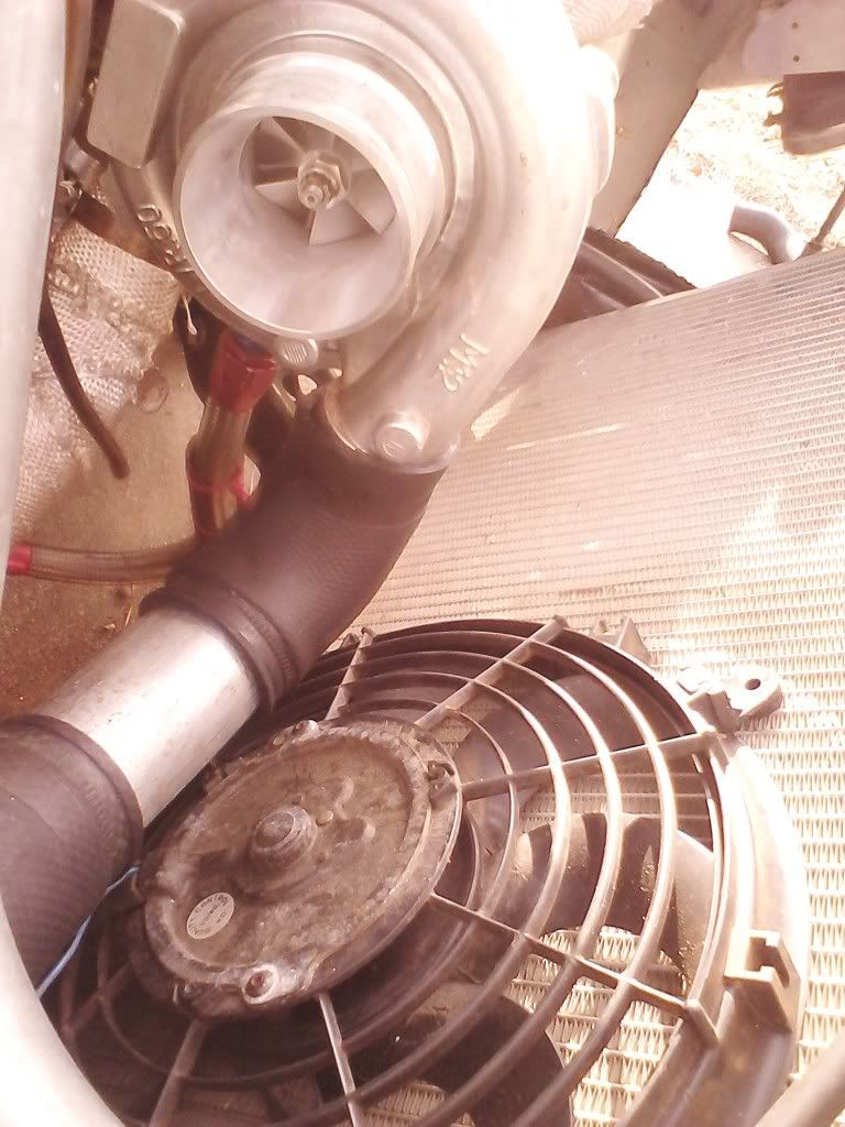

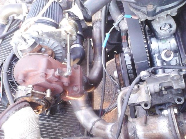

Hose clamp on my compressor housing wore a nice hole in my radiator.
I went to a u pull today thinking a maxima one wouldn't be hard to clearance as well as shorten up the coolant piping.  Nay.  Too wide.
I have to return it before work tomorrow for "store credit" then keep harassing them til either a stock 240sx shows up or an rx7 shows up.  FC radiator would work perfect and i know they cool really well.  Also have angled inlets/outlets for slant mount so i can move it away from turbo heat.   After enough burping my temps stopped getting up there.  Water from old radiator was brown from all the scaling/rust that had been free'd up from the block jackets during heat cycles and cavitation.  Probably didn't help.

Ok, well solutions.  I'm off this weekend and should be back driving then.  Long list of shit to do.  Pulling all 4 wheels and greasing up the studs is a must.  I had plans to handle that, install my new gauges and proper harness install but again, radiator.

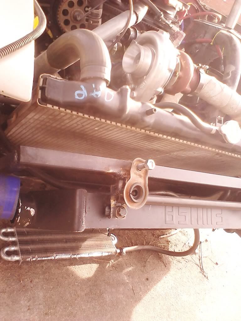

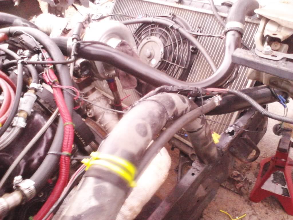

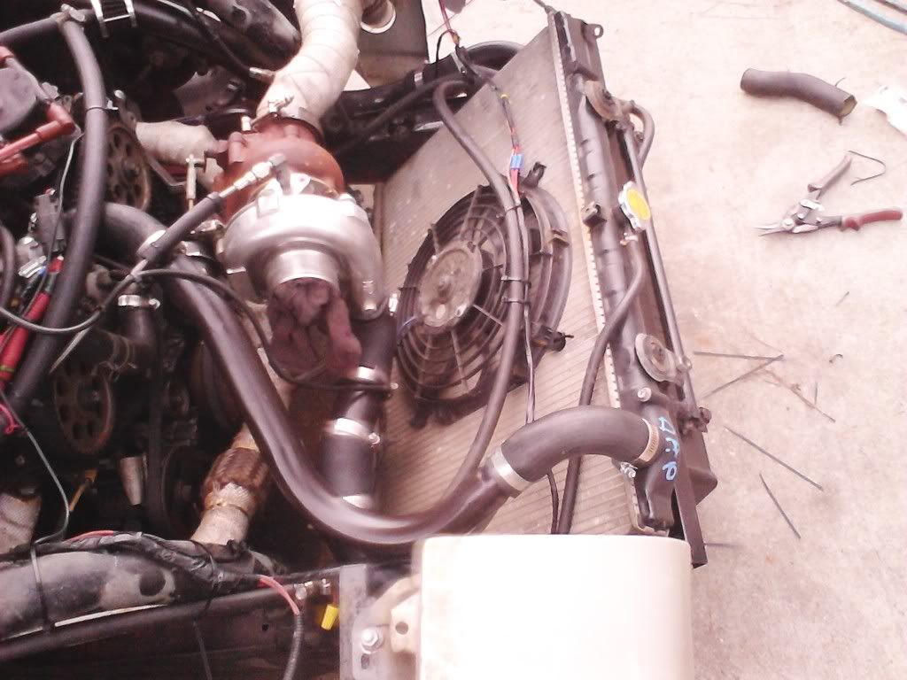

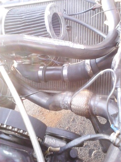

I re-fabbed my upper and lower water pipes into one piece.  Only 8 clamps to worry about.   intercooler pipe parts didn't get so lucky because i cannot weld aluminum.   3 piece hot pipe, 3 piece cold pipe.  Recirc/blow off has been relocated to the cold pipe and i have to leave that bitch on for a few 100 more miles.  Enough talk, picture time.
Radiator was moved forward several inches.  The lower bracket isn't there.  Waiting to order an rx7 aluminum (yes, still) before i tie the tension rods together with a bar and add the brackets to it for the radiator.  Makes sense.
New upper water neck.  It is aluminized steel.  This shit is less than ideal but if i need this stuff fabbed in aluminum whoever does it can go off my original bends.   I like stuff where it is at this point.

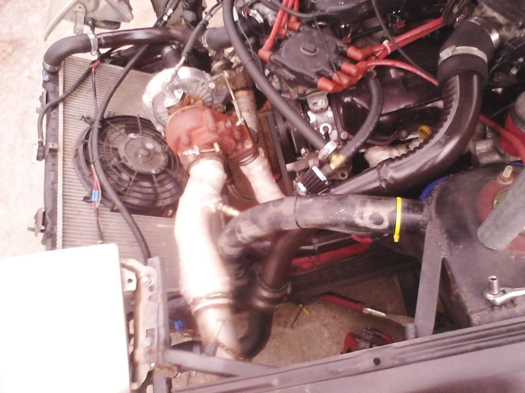

New hot pipe.  BOV is next to the frame rail on that first bend that comes off the intercooler.   Trust me, i wanted this tube patch welded and fuck a bov but extending the life of this turbo is a must for a couple more months....
Pre-paint mockup of the new hot pipe.  NOt too long.   Maybe 2.5'.   I wanted to put the intercooler between the turbo and radiator parallel to the ground buuuuut i was worried about having to cut the hood.  I'm open tub so this angled front mount setup should work ok if i bleed it and duct it well.

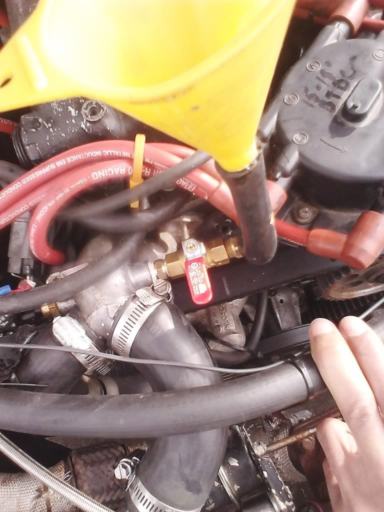

Radiator fill cap ended up being lower than the motor.  Needed my car asap and couldn't do the whole surge tank thing just yet so i removed the oem coolant temp gauge sending unit, tapped the hole to npt and put a ball valve and 90* elbow up in there.
RHMT worthy yeah?
Ghetto bleeder works great.  Temps stayed 2* cooler than they did with the old oem 240 radiator cruising.  175*.  Bout 180-190* creeping around town with the single 10" e fan on....

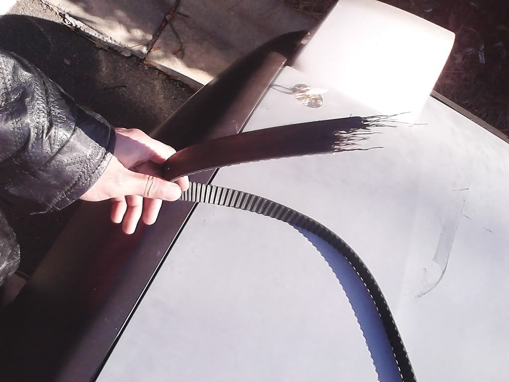

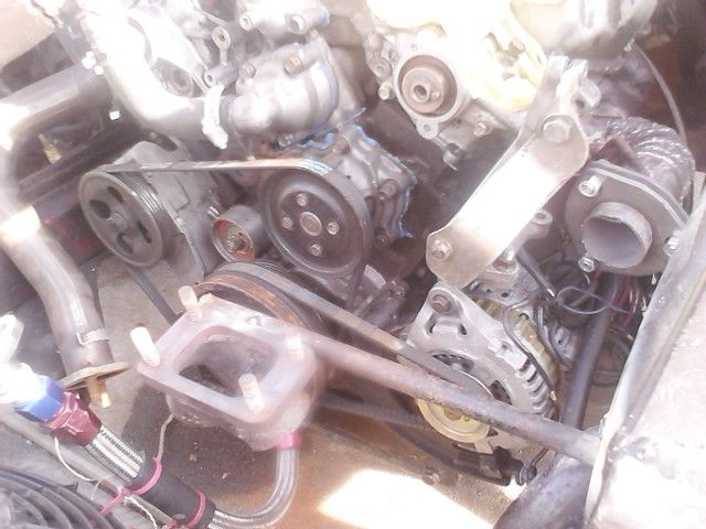

Got a tow home from work two days later.  Belt broke backing out of a spot doing like 8mph

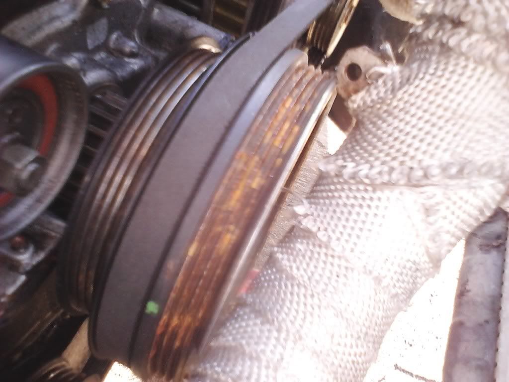

When i started tearing into the car i found this......
Heatshield tab on the mani was milling the crank pulley.  To be fair i did turn my decel fueling time to 2 seconds before it starts decaying.  That means timing is retarded but i'm still shooting fuel to the engine til that timer reaches zero and starts pulling fuel.   In and out of boost was near instant though.  Great throttle response.  Immense manifold heat, enough to warp it.  It was fine before i fucked with my tune for the sake of "lets have some fun".
And now here it sits til the weekend or friday if it's nice and i'm not dogshit tired after work.  All i gotta do is pull the covers and the rockers off and can free the heads to get a damage report.  I have Z cams, not truck cams so chances are good i have to do some piston sanding and order or junkyard liberate some valves......

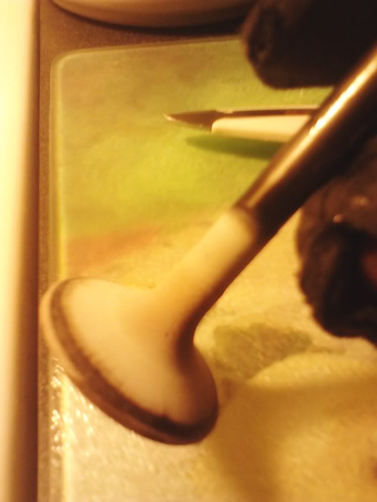

That's it.  Head gaskets had to get ordered obviously so i went ahead and got the whole top end set.  New valve stem seals because i can, new exhaust manifold gaskets, all that fun shit.  I got a garmin gps that's going to get integrated into the cluster i'm building.  I can't afford racepack or stack shit so making do.  Fo sho want the megaviewer one day but first thing is first.  This car has to stop breaking so i can save money for parts i really, really want or need.  Onto pics.

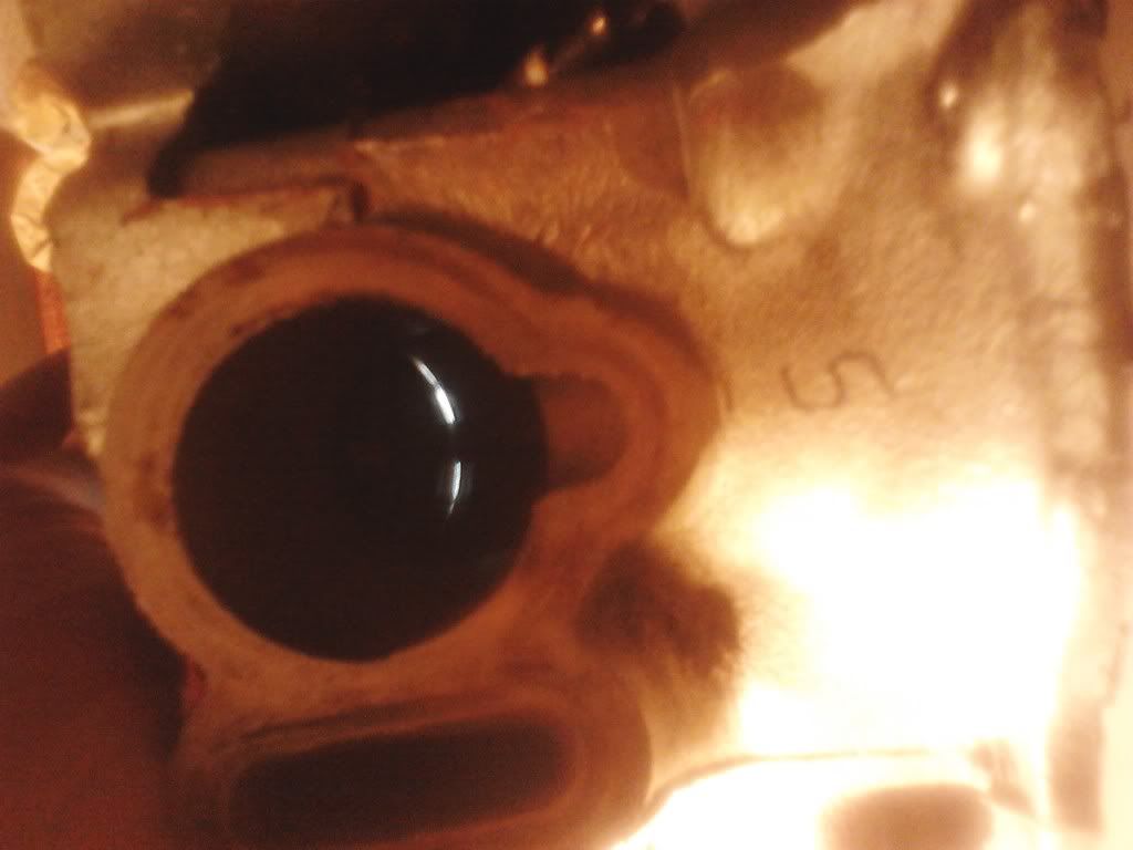

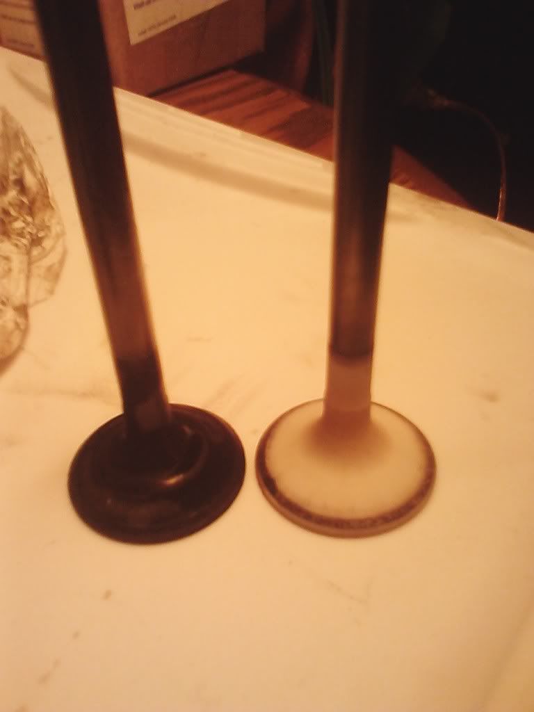

Now i have a flashlight shining on the back of cylinder 5's intake valve.  The gap you see is roughly 1.5mm.  Cylinder 6 had a 2mm gap.  I'm going to scotch bright my pistons when i feel like it to check those to see if they need sanding down/deburring but from what i can see things look fine.
Next up we have the exhaust valves.  The front 4 cylinders have this shit going on.  Explain this to me.  I'm thinking it's an issue with the rear cylinders having the longest exhaust path and the front ones having a shorter path but the pulses anal sexing eachother is causing all this ugly shit on the back side of the exhaust valves.

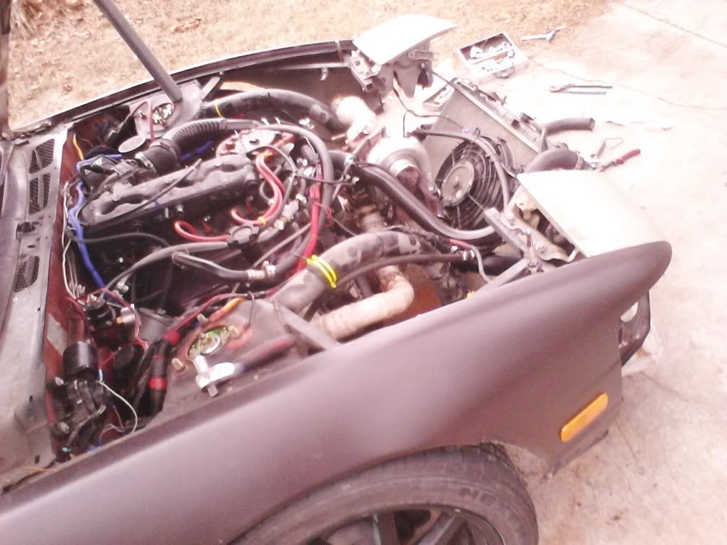

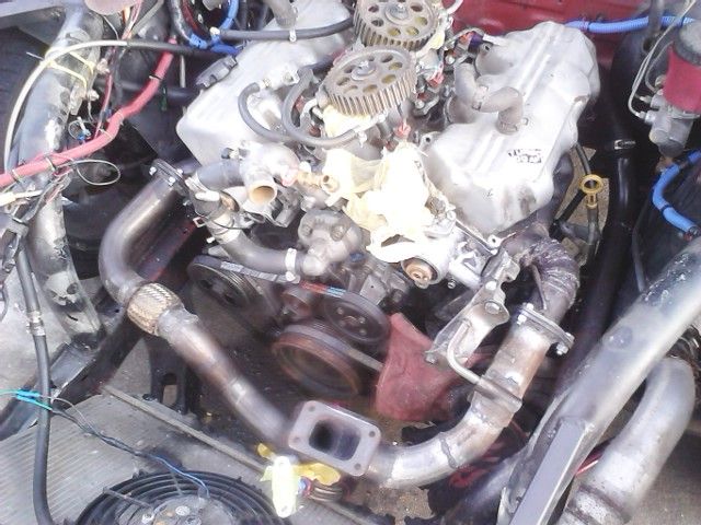

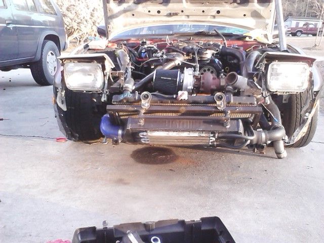

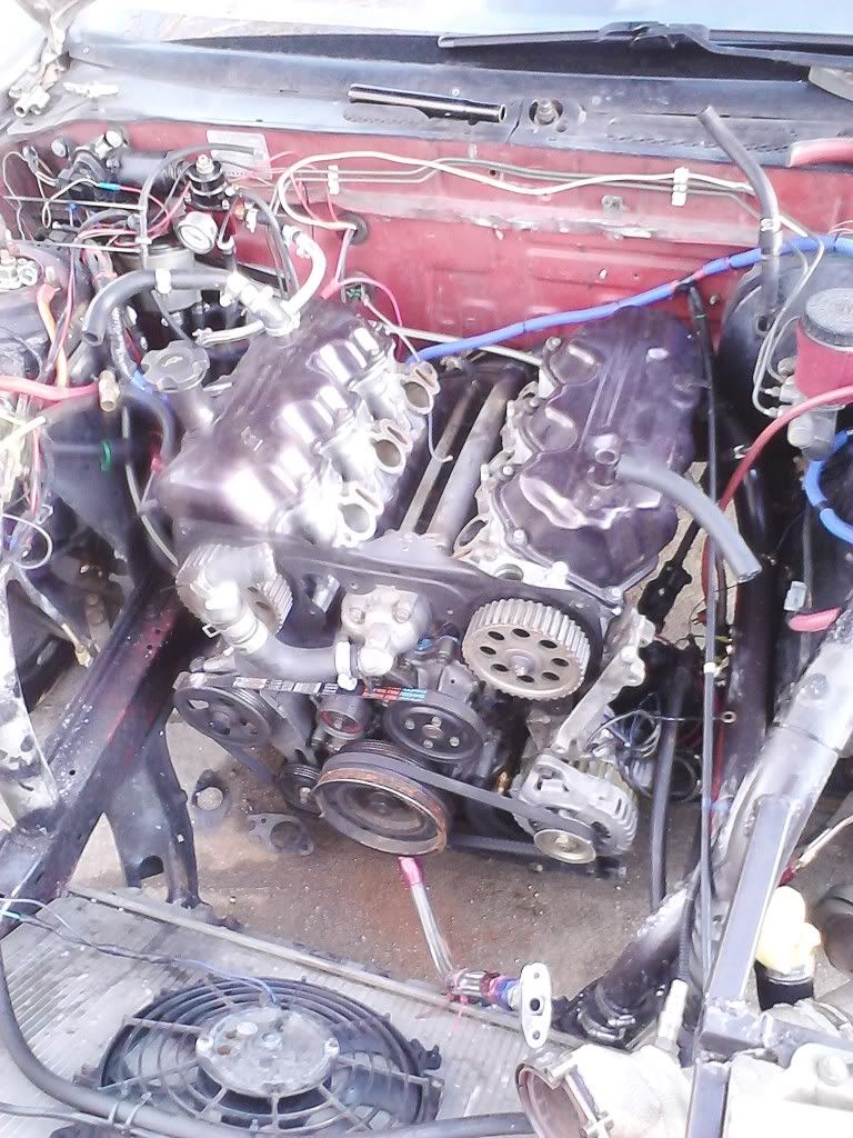

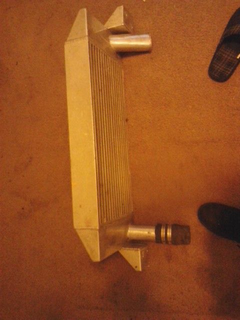

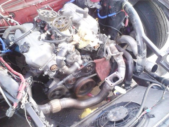

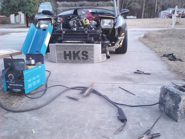

Mostly together....well mocked up.  Clamps and gaskets are missing here and there.  Engine is complete aside from torquing the harmonic balancer and 2 bolts in the alternator bracket...    Think i got the belt tension right this go around.  Had it right the first time.  Fucked it up last time i tore the motor down due to oiling issue....  Full retard.  Never go there.
I got a pig nose bumper for this.  Another on the way.  Hopefully a lip to follow.   As much as i need to go aftermarket front bumper (for room/proper dom tube crash bar) i can't at the moment.  Dont have the puzzle pieces nor funds...
Hacked the mani all the fuck up.
Ended up with this.
Gonna figure out how to mount this.  inlet/outlet are in line with my frame rails and strut frame tubes so that's a problem.  Might hang onto it for another project.  Current fmic works fine, even configured like this....
