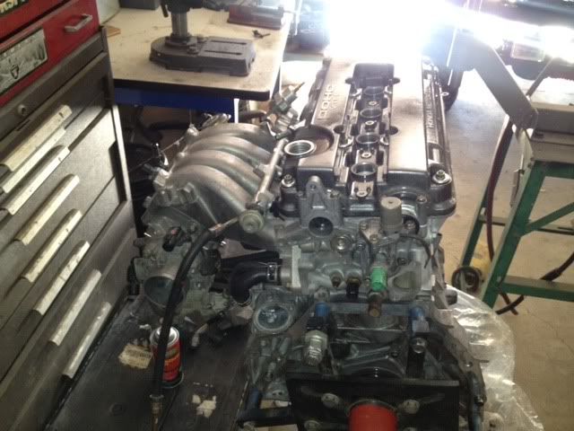

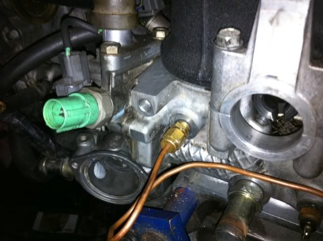

This is the Z6 port location I use.
On a P72 head you can see the OEM port plug at the lower left of the head.  Just above the engine stand bolt.
Whichever port you use;  just use a port if available with 10PSI to keep shavings out of the motor while tapping the threads.
If you try and cram a 1/8NPT fitting into the OEM 1/8NPST, you will only get 2-3 threads of contact;  the NPST is a more tapered thread then an NPT.
