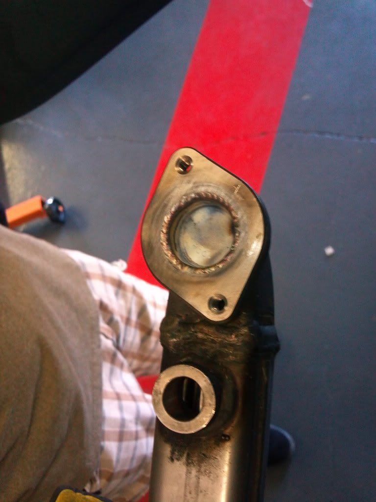

Its not a bad thing because the coolant still circulates, but blocking off the stock up pipe is dumb, because you are just going to have to pull it out later.  The 05-07 up pipes have a scoop inside of them to direct gas to the heat exchanger, which means they blow the fastest when you plug them.
The dumbest thing is when guys actually remove the egr valve itself, which makes the rad fan run less frequently and the engine run hotter.
Re: diesel fags 6.0 halp
« Reply #29 on: December 02, 2012, 10:13:52 PM »
explain
