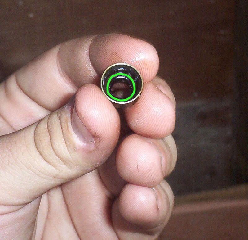

Re: help--- how do i put my new valve seals on THE RIGHT WAY?
« Reply #7 on: May 07, 2009, 03:24:36 PM »
another thing to look for is when you take the old ones off sometimes there is a little ring of the rubber that breaks off and stays on the guide, the new seal cant seat all the way down and it leaks. here is a pic off my toyota, same style of seals
jhonda
  • Posts: 384
  • BOATS-n-HOES
« Reply #8 on: May 07, 2009, 10:43:14 PM »
hmm ok cool,, im going to buy another set and try it again... and yea it only leaked oil out of the valve seals i replace but only this time it was worse...but yea this time im going to take the old ones off again and clean everything real good and then when i replace them im just going to push them on by hand....another thing i was thinking about was would it work by putting some gasket sealer on the new valve seals before i put them on just to get a better seal or is this a stupid bad idea....
