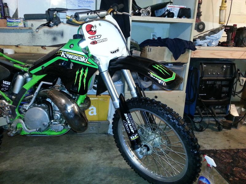

Only thing left to do is bleed the front brake better (That or it needs the master seal replaced)  EDIT:  Ended up replacing the MC with a CRF 450 master with an ASV lever on it I got off Ebay. Bitch stops on a dime.

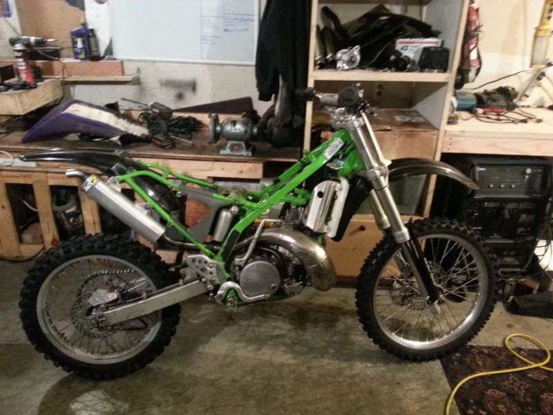

Got it like this
Pipe was beat to fuck, so welded the small end shut, made a coupler with a compressor fitting.... filled it with 50 PSI and blew the big ass dents out with some heat via MAP gas
https://www.facebook.com/photo.php?v=10151081715645378&set=vb.639350377&type=3&theater
Fab new Pipe bracket:
cleaned up and good to go.
Im in it under 500 with new plugs  I bought
Currently full of Q16 and castor 927 Smells better than sex.  Loves me a 2 stroker smoker. Bitch is fast.

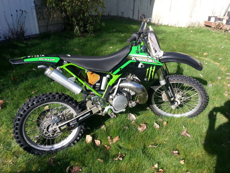

Put a new GRFX kit and gripper seat cover on it, new side plastics and a USFS spark arrestor... Also took the stock silencer since it was fucked up and shortened the can to FMF shorty length and perforated the core a bit more and repacked it. Noticable difference, comes on the pipe harder than the arrestor or Stock muffler but since I always ride somewhere I need a damn arrestor...  I just leave this one on  :O)
Also had to replace the clutch cable. Im in it under 780 total. Runs as good as it looks. Hasnt gone through a plug since I got the air screw and idle dialed in.

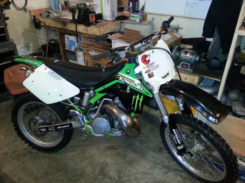

Stripped down new ANSWER SA PRO-2 installed
Graphics slapped on
Gripper seat cover done:
HMT/GFI SHORTY :O)
White sides:
LIttle startup vid... Just came off the choke so not all the way warmed up... Smokin like she should LOL. Decided to ride it to an AA  meeting a couple miles away since it was so nice out  :O)
96 KX250 FMF Fatty, Answer PRO SA 2 Arrestor, Boysen reeds
