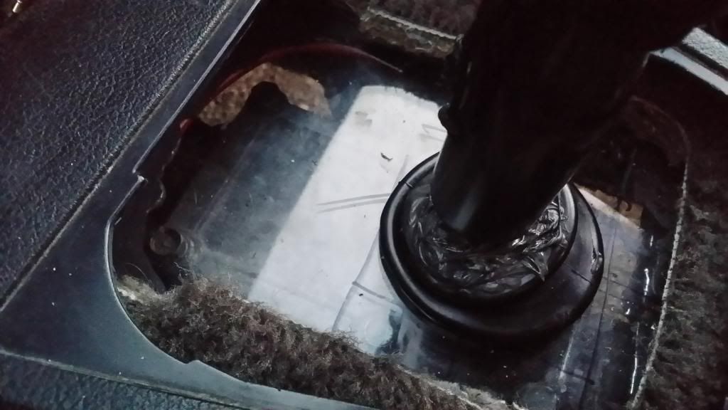

Forgot to show the cover I did for the shifter tunnel.  Had some lexan laying around and used some plus a generous amount of rtv
It's a cool little window to the rushing road under me.  Still going to be a while before I figure out a shifter boot setup
It's helped some with keeping the exhaust smell out of my car but it's only a minor fix.  Damn poisonous exhaust gases

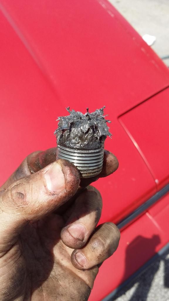

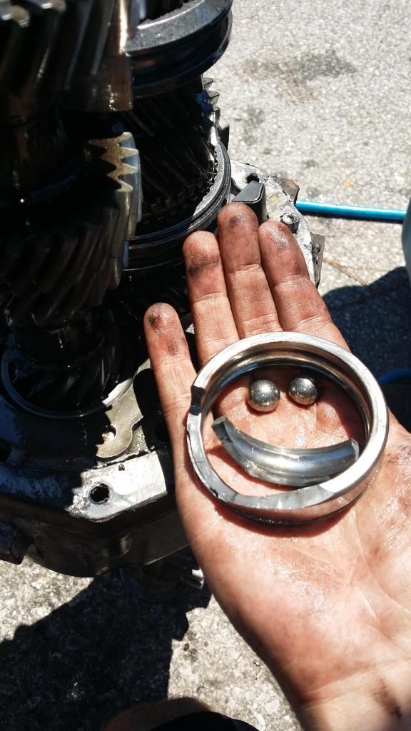

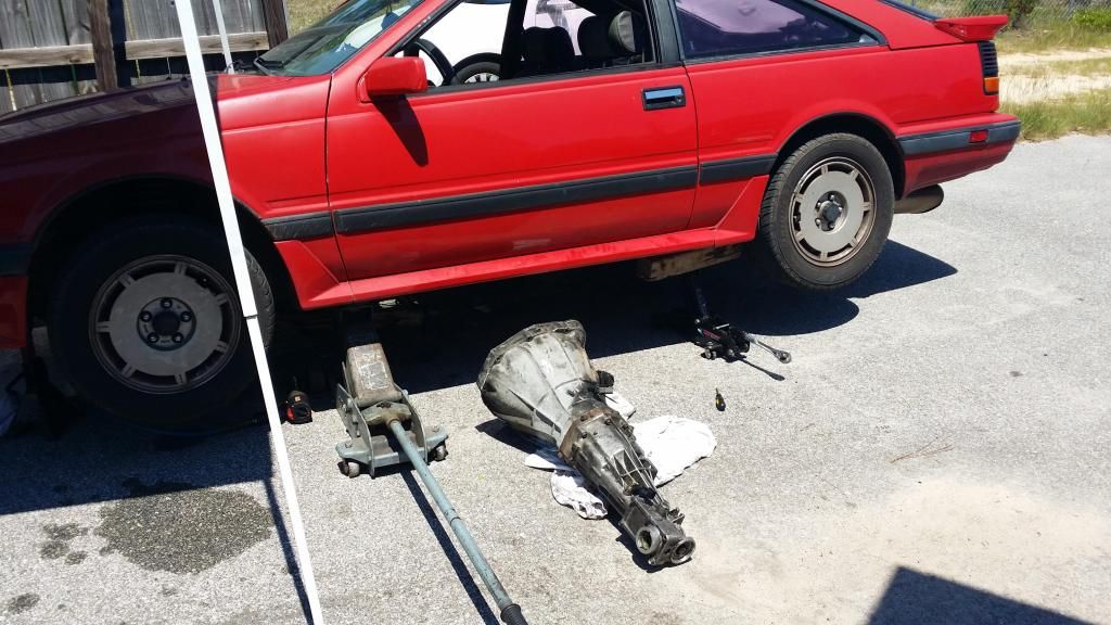

Replacing transmission now.  I would be done with it but a few hold ups along the way.
A real pain in the ass to get out.

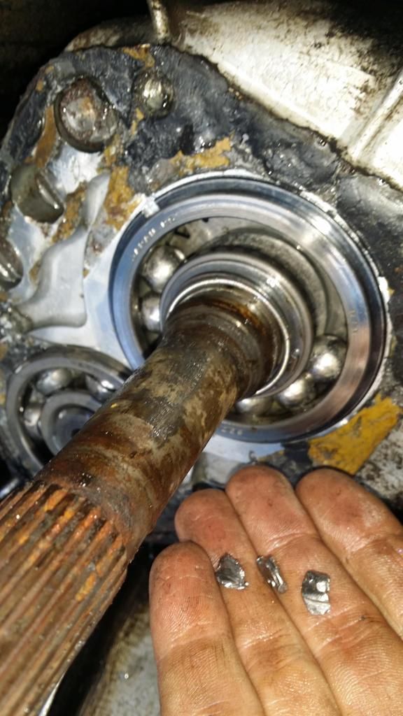

after pulling the drain plug I can see I'm in for a nasty surprise once I open it.
Well then.  Free floating bearing chunks.
That's a shitty failure there.
More bearings were missing in other locations and there was scoring marks EVERYWHERE!  So this transmission was toast and after  dealing with it's shittiness for a while now (and the huge pain it took to remove it) I felt like I need to do something to make myself feel better.

Not to be a debby downer, but hopefully you used jack stands before getting under that thing.
Last summer two guys got killed and one put in the hospital in the local 'scene' all from assorted jack mishaps.
This year a friend of mine almost lost a finger and is out of work for a couple months when his jack kicked out while he was sliding a jack stand under the car.
His finger looked like a bloody set of stairs haha. first surgery put a plate in that snapped on the first day of therapy.  Then he had to wait a week before they could go in and replace it and add a second.  It will be a long while before he can use his hand normally again.
Re: 1988 Nissan 200sx build thread redux
« Reply #37 on: July 11, 2014, 02:38:18 AM »
I use lots of jackstands.  I already took out the ones on the side when I had remembered to take a picture.  You'll see one still under the front.  I always make sure there are backups.  I do not want to go out like that.
