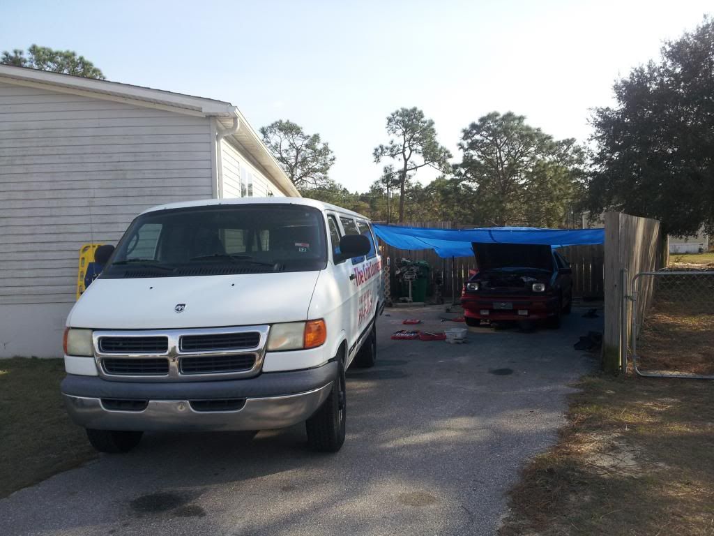

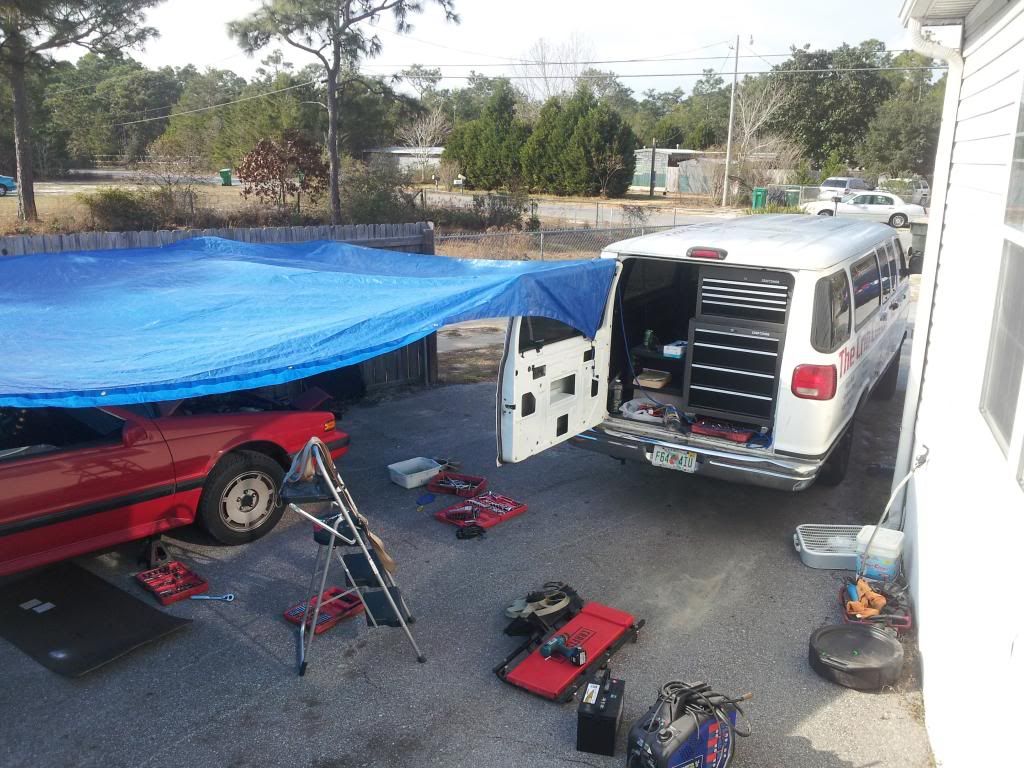

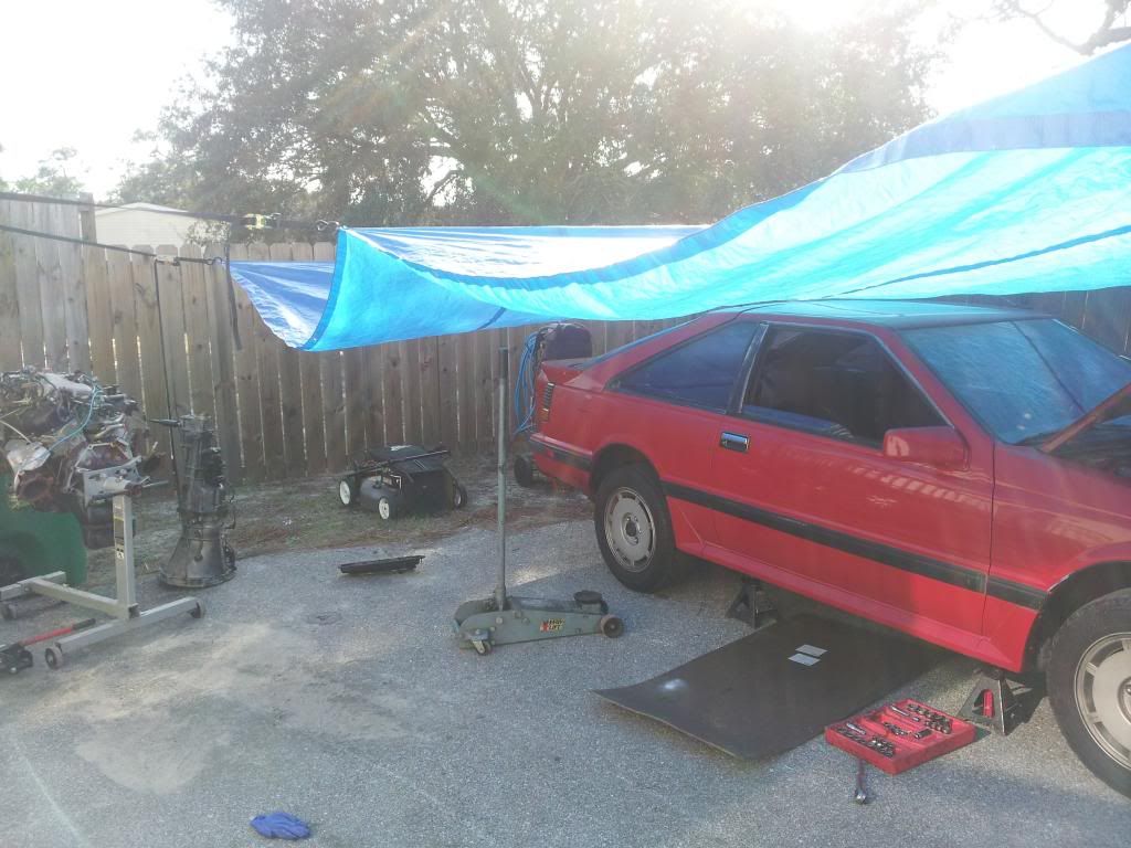

Today after setting up shop rhmt style with a tarp held up with nails, straps, a fence, and the van holdign a corner, we set to work.  There were several hold ups but we managed to get the motor pulled out.  Pain in the ass cause the bottom side was dirty as shit, old school vac,setup so it has to have a million vac lines and other shit, plus its been like over 2 years since I've done serious engine work.

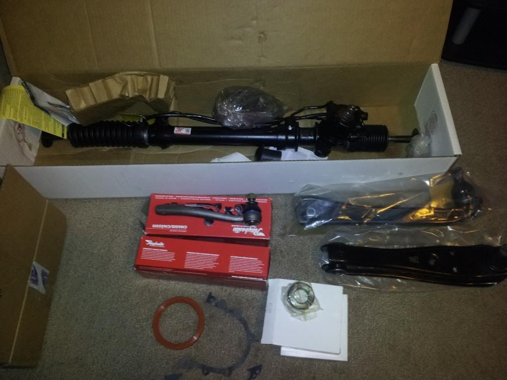

-Rebuilt rack & pinion

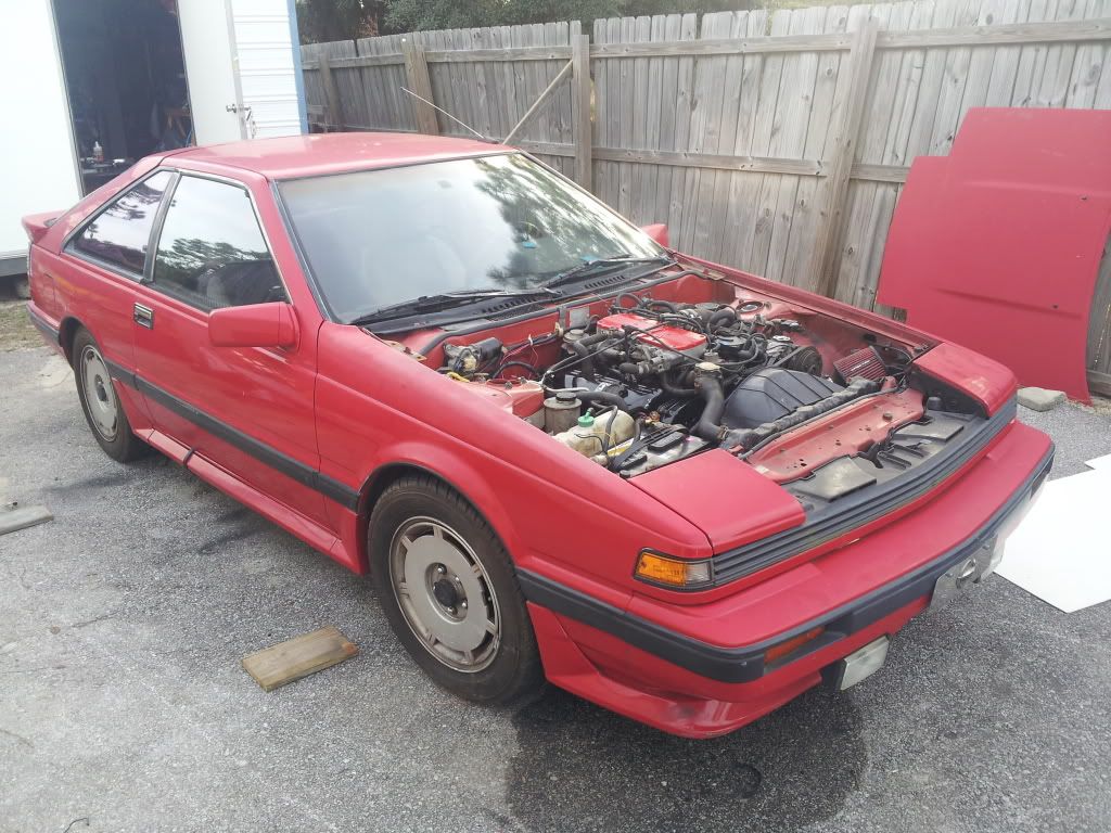

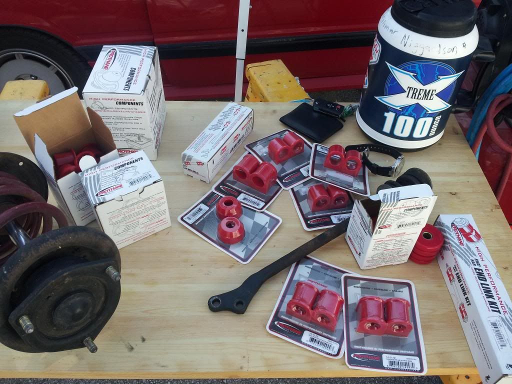

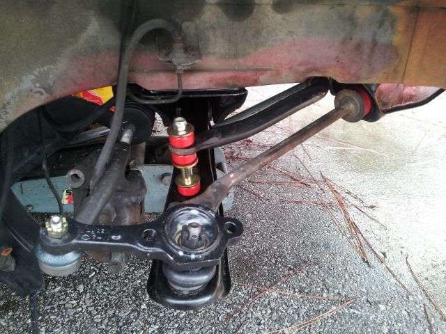

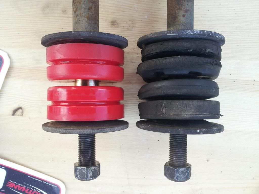

I used a 280z/300zx master kit which just so happens to fit 90% of the bushings on the 200sx.

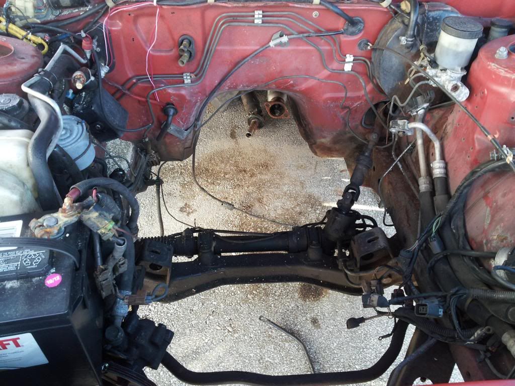

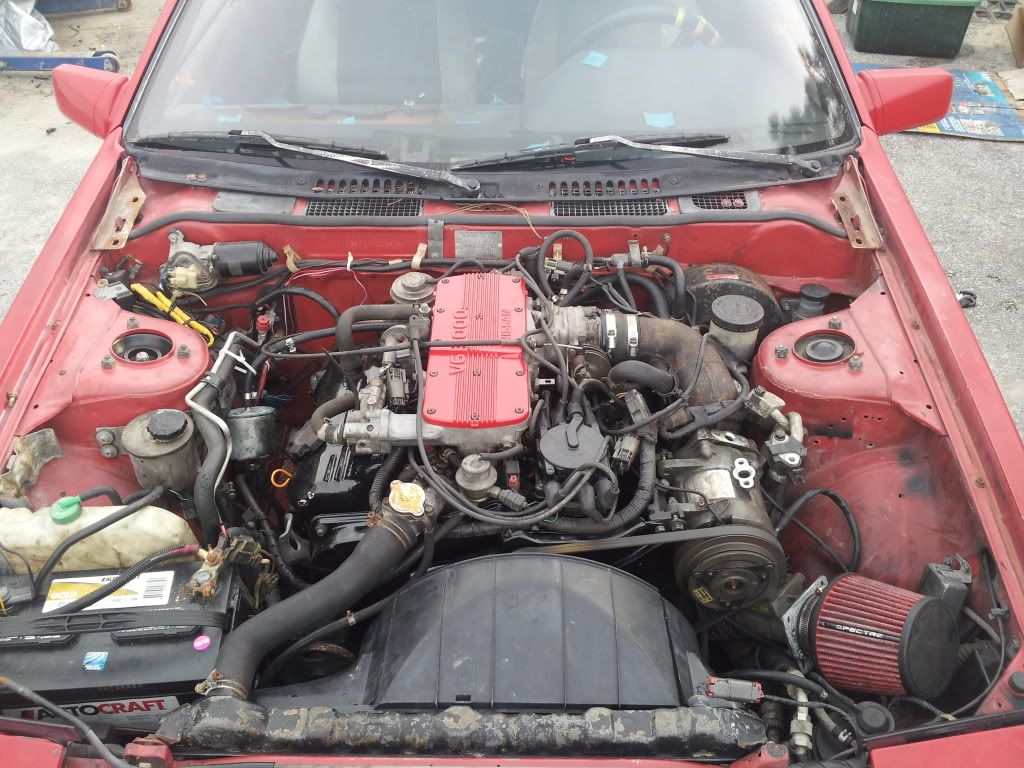

Engine bay before I cleaned it

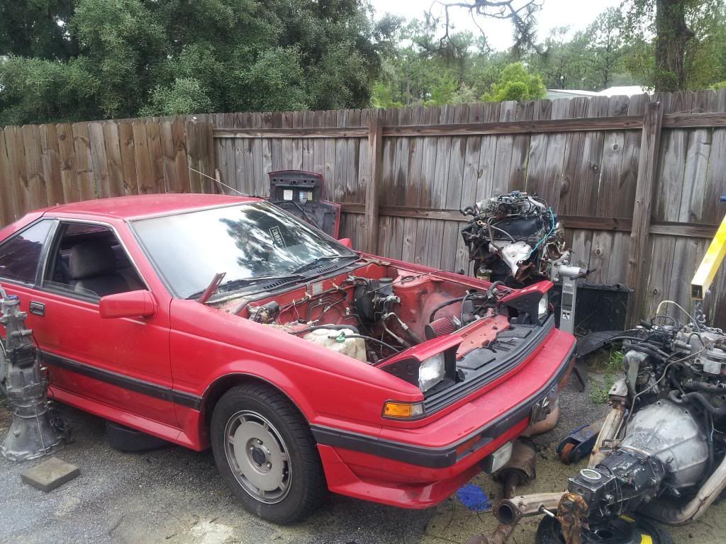

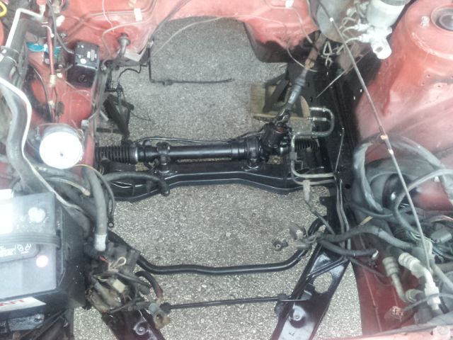

Pictures. This batch sucks because my phone was on some shitty setting. Pictures in my last post were from same phone.
Engine bay after cleaning and patch work

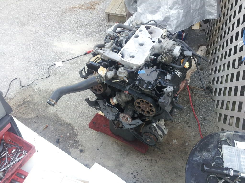

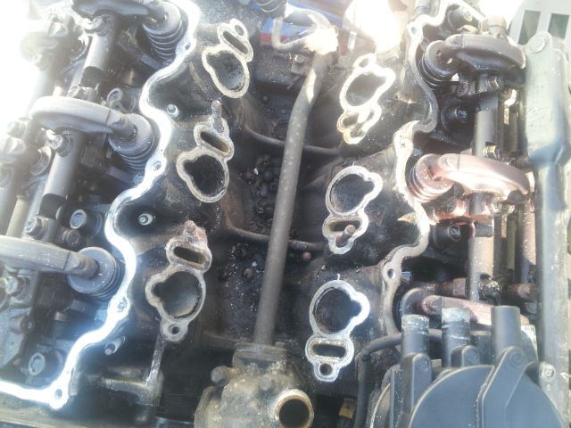

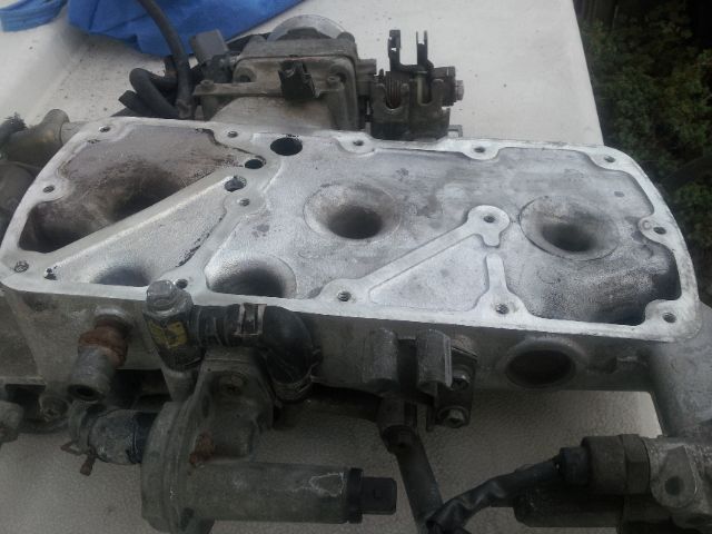

Top of three block with intake plenum off. There was 1/2" thick grime and enough acorns to plant a small forest.

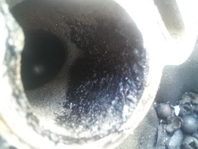

This is a shot of the worst/dirtiest intake. Not bad at all. All the others look much better. You can see how wonderfully clean the valve is :)

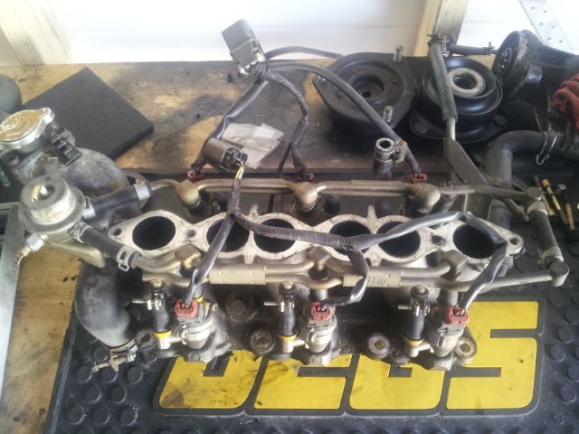

Fuel rail and other half of intake. Still needs to be cleaned.

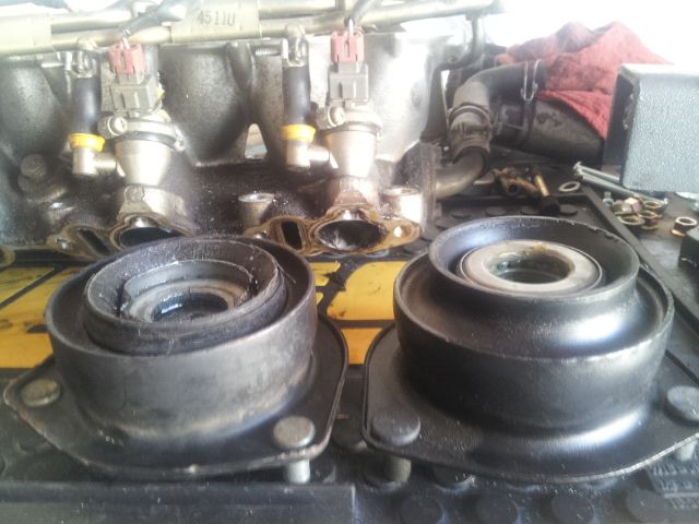

Comparison of old suspension top mount vs new. Suspension is going to feel much better

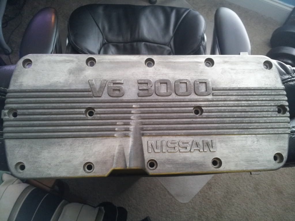

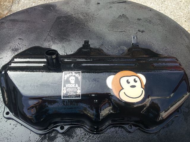

Valve cover when I got it all cleaned.  I don't have a close up of it painted but its a nice red.  I didn't do anything fancy

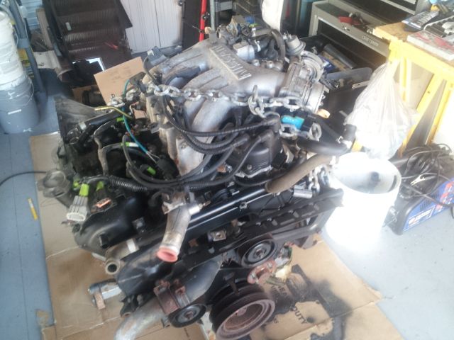

motor mostly together.  This is where it sat covered mostly

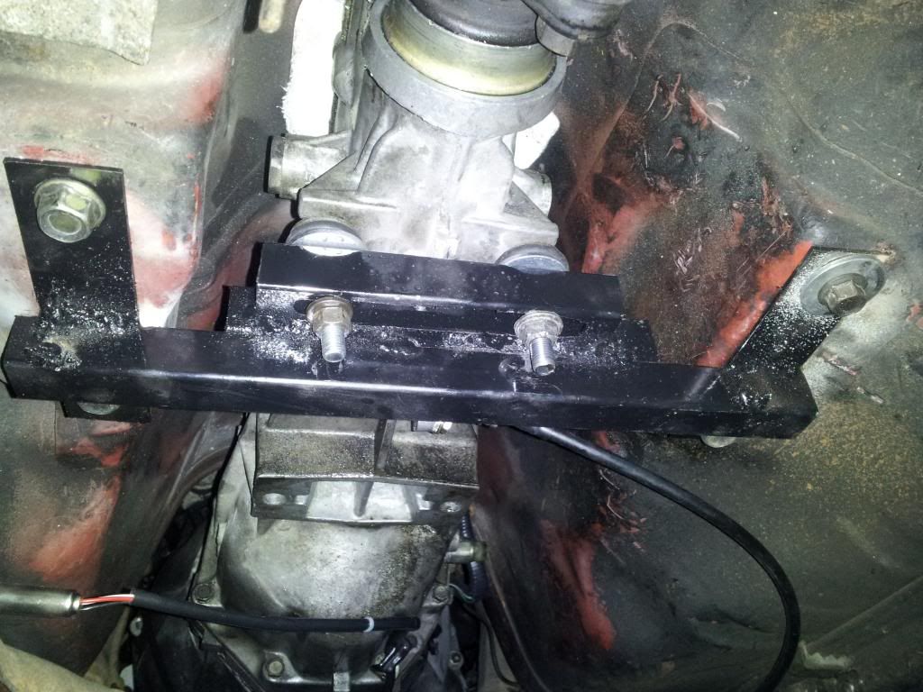

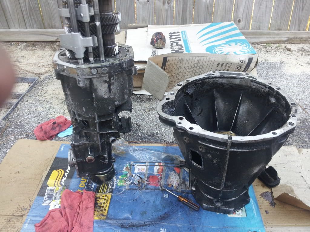

Frankensteining a transmission.  VG30 bell housing with ka24de gear box

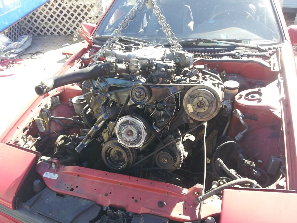

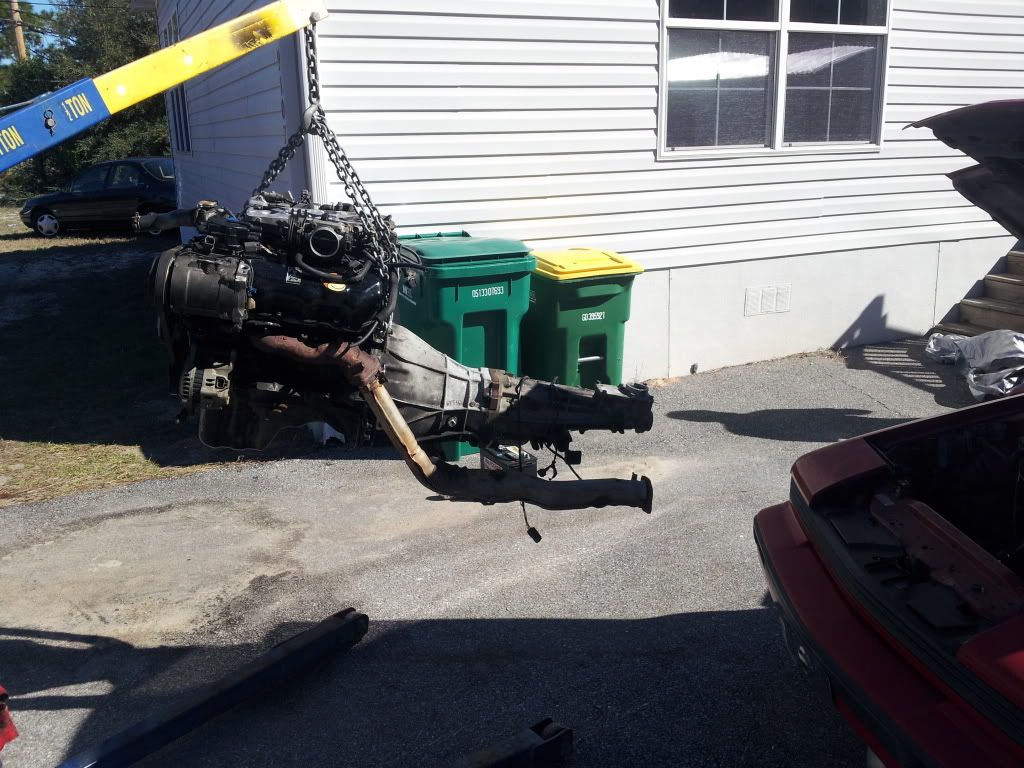

Soaring high
Getting it in took time and proper use of angles but went smoothly with exhaust up to cat and trans included
All hooked up

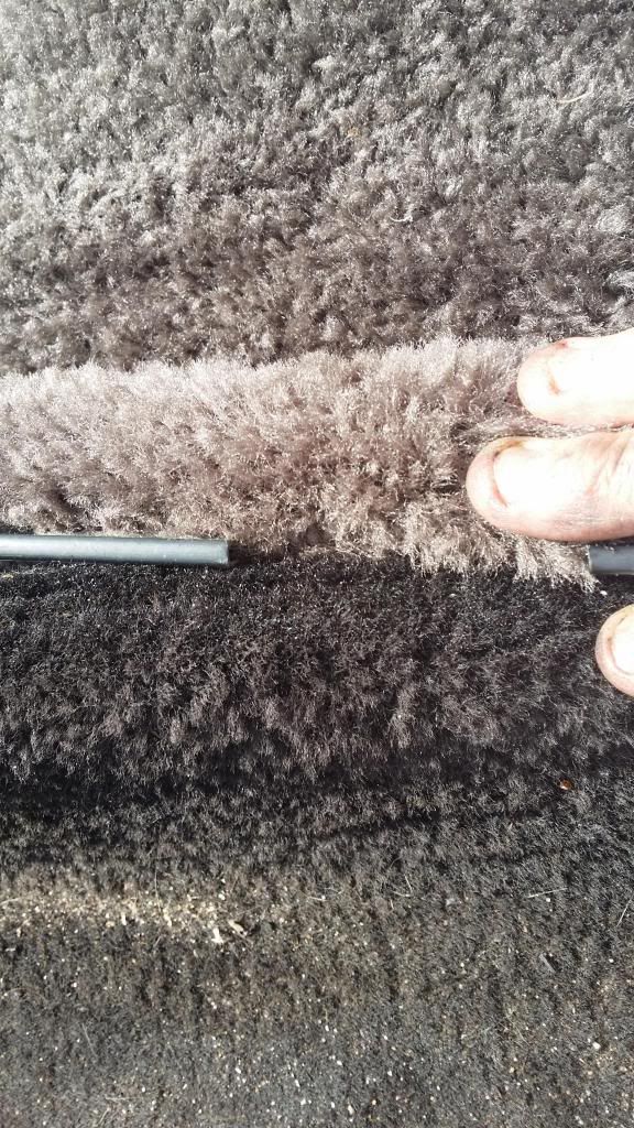

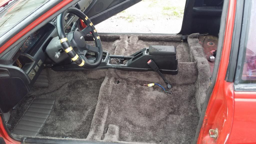

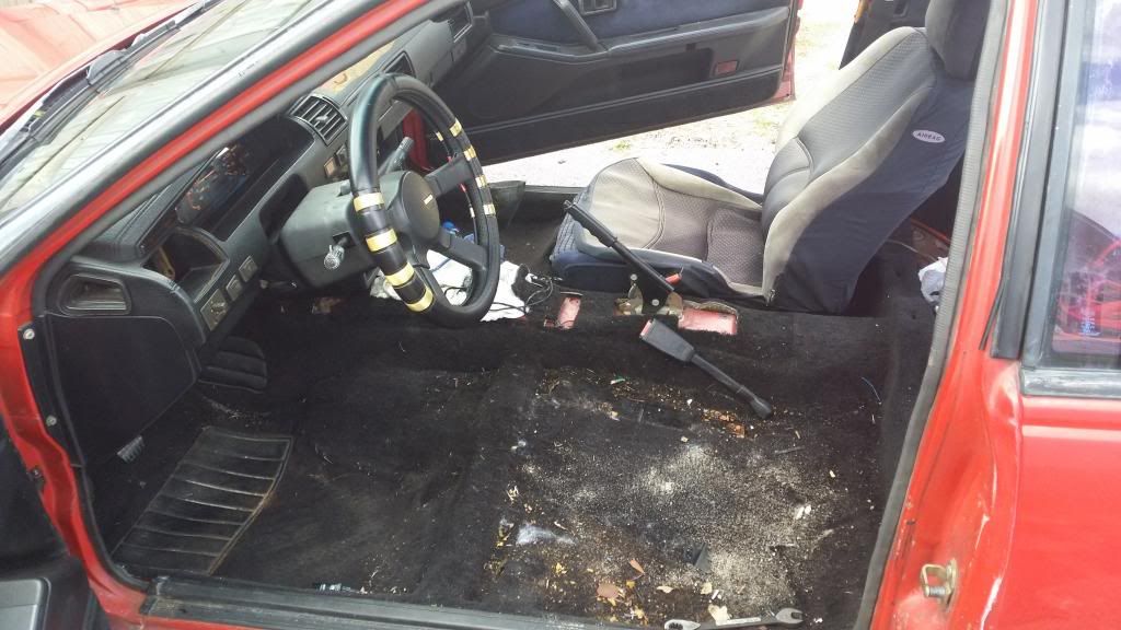

This is what I had to do to the trans tunnel.  The interior pieces will fit alright on it with a different boot though.  Whats nice is its moved almost 3 inches closer and lets me use the s13 shifters instead of the giant telephone pole mine had. lol
How it is now (hood is back on actually)

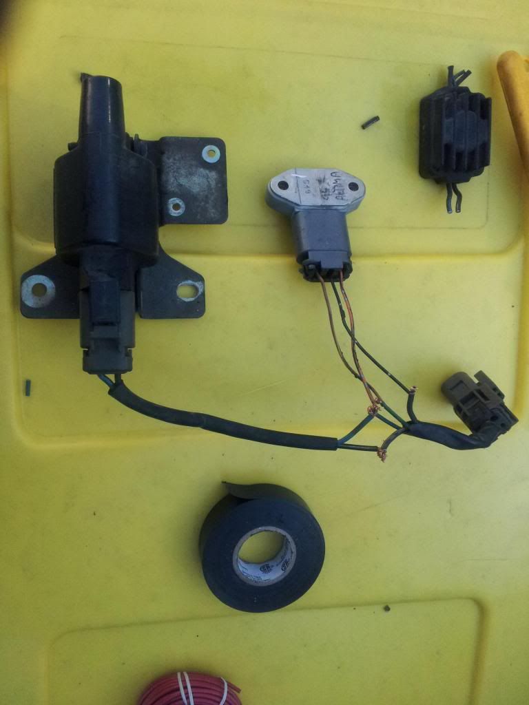

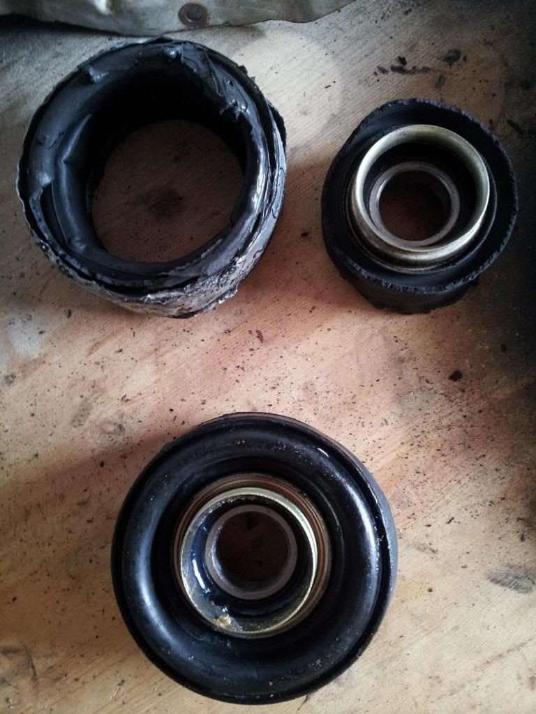

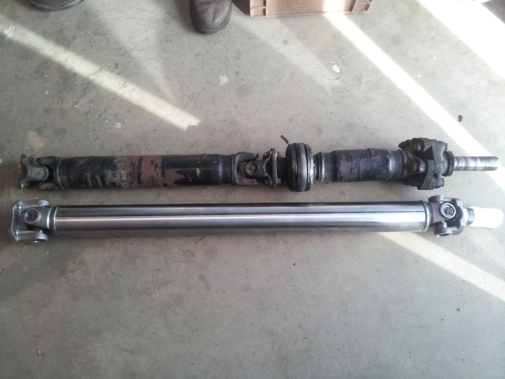

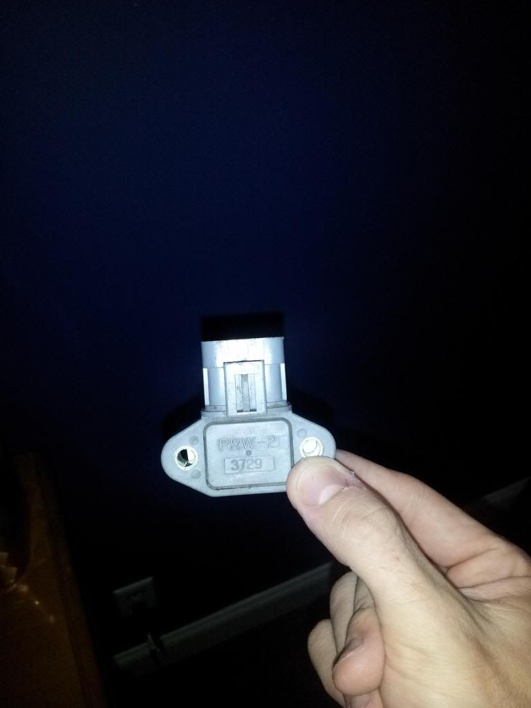

Replaced the carrier bearing aka support bearing.  Also did a neat little ignition control unit upgrade thats the cheapest thing I've done for a noticeable upgrade.
Old support bearing vs new
This little bad boy is the prw-2 ignition control module that is a nice little upgrade item for guys running VG motors with older stock ignitions. This is found in most 90's V6 nisAnd because I'm an intellectual being,  (vg30e) Cost all of $8 on ebay.  Neat trick from the z31performance guys.
This is the ignition control module wired up.  The old one is on the top right.  This upgrade made a noticable difference in starting the car, idle, and throttle response.
With these things done I no longer have the driveshaft hammering around when I'm getting up to speed and my ignition system seems much improved so I may have fixed my cold start issue.

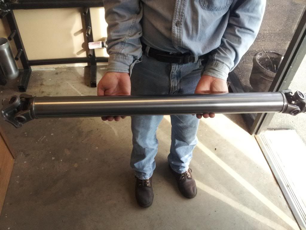

Also I need to take the car in to a driveshaft shop to get it balanced.  It vibrates a lot now unless I'm driving at highway speeds.  Just had the alignment done and it's only started doing this since getting the support bearing replaced (which fixed the horrendous knocking the driveshaft would do)

Whats been done:
custom drive shaft
new shocks/struts
welded up a solid trans mount (soon to be changed)
new interior carpet
sound deadening
swapped seats.  Had my old '85 turbo s12 seats laying around and they are in better condition (slightly more comfortable too)
Old interior carpet from 1988
Side by side of new carpet vs old.  I bought up carcoal grey carpet because black wasnt available.  It's not everyday you come across OEM carpet  :Jew:  I actually like it more than the black.
New carpet in!  Fits like a glove.  Gotta love OEM
While the carpet was out I washed the shit out the inside, scraped the rotten padding/sound deadening that was useless and went ahead with putting down a layer of sound deadening material on the entire floor.  Some ebay stuff I had from a while back. Its thinner than dynamat but does the job well.  I can hardly hear road noise but now I hear the shit inside more. lol
New driveshaft
compared to old:
Trans mount.  Cost all of $8 in steel from Lowes.  My bird shit flux welds have returned!!!  Been rolling with this a few month now.  My welds are solid  ;)

I wish I took pictures of the work I did on the suspension.  Interesting stuff:
I had the stock sized shocks on the car but they handled shitty/blew soon after the car was lowered.  So proper sized shocks and struts needed.
92 mr2 fronts, 96 mustang rear.  I went with monroe because I'm on a budget and I'm ok with oem.  Plus they had an awesome deal.  I don't like how the rear feels tohugh but thats another day down the road.   Anyways, the new shocks are 1-1/4" shorter in the front, 2" in the rear.  The fronts are cartridge type shocks so to make up the length to match the shock travel I just put a bunch of washers in the bottom of the tube to raise the shocks.  Also had to drill the top hats to fit the thicker (giggity) tops.  Rear replacement was really straight forward easy.

Make a new trans mount using a large rubber mount.  The solid one I made blows just because I don't like feeling and hearing every vibration from my engine.
