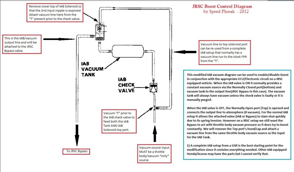

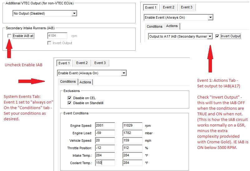

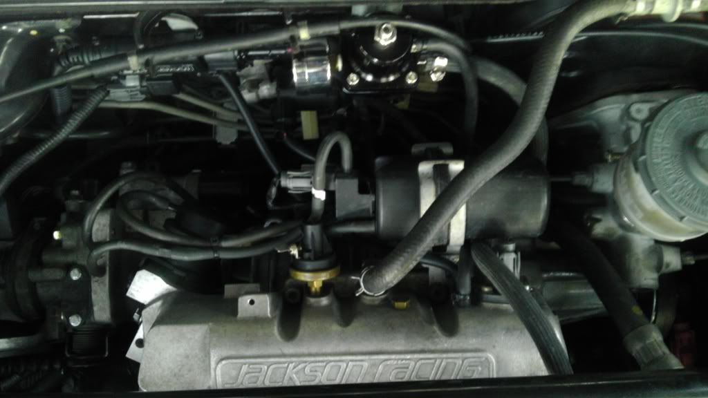

I recently dropped a JRSC onto my daily driver. Classically I've been a turbo guy, but I came across a deal I couldn't pass up on the S/C. I ended up trying to make it as "factory" of a setup as possible, so I decided to include a way for the ECU to control the JRSC. How I did this was by re-purposing the IAB tank and vacuum setup to allow the the ECU to control the JRSC bypass valve/S-tube.
Mechanically the GSR secondary runners work the same way as the JRSC bypass valve, so it's a fairly straight forward trick. Using Crome I am able to switch the bypass valve vacuum circuit between active/inactive depending on engine conditions. Mainly I use this for preventing boost below a set MPH/RPM(or other criteria) to prevent wheel spin on launch. Alternatively this also stops boost before the engine is at proper operating temperature or during a CEL event. Alternatively the circuit can be controlled via a simple switch to allow the bypass to stay active at all times, handy for "valet mode" or poor weather where no boost would be safer.
For Turbo applications, it could be a cheap setup to work 2 different boost controllers if you removed the check valve and routed the lines a bit different and basically changed the whole diagram....maybe it doesn't really matter for turbo cars, or figure it out yourself.

IAB Attachment and lines

Crome Config.
*disregard intake temp setting, it's a glitch.

Depending on intake and exhaust restrictions (or lack of)  you ll probably see less boost than what you size your pulley for. I have a 4.0 and B20 pulley setup on mine with a decent header and intake. Allegedly I should see 9 9psi but I've never seen over 8.9... I've read a few places that cams any bigger than GSR tend to loose power too.  Just FYI,.
Also, no duty cycle needed, just on or off. The S-tube/bypass still does the normal Operation...  But since you mentioned it, I did think about doing a PWM solenoid in place of that setup and doing modulated boost per gear... But i got lazy and cheap. It might work but I wary of the bypass valves response to a PWM vacuum signal.

So you're seeing ~9psi normal, and 0psi when the controller is working? I figured you had this set for PWM control, which would keep the bypass slightly cracked to only bleed off a little boost.
I know I've seen people try boost controllers so they can use boost by gear & such. I presume you could also have the PWM parameters set such that you could reduce tip-in issues commonly seen with the JRSC due to boost coming on so fast. If nothing else, you could just route a 1-way solenoid (no vent) from the manifold to the tb-sc tube, which would reduce boost simply by bleeding it off. You wouldn't be able to reduce it much near redline, but would have much finer control. AFAIK, you can still use that stock IAB solenoid as a PWM solenoid. You'd just have to do some tests to find it's optimal frequency.
Very good points, to be quite honest I'd try PWM if I used the S/C more... As is I flick in on when I need passing power or to shut down some asshole in traffic. Other than that it stays in bypass mode, lol.
