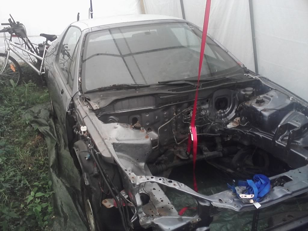

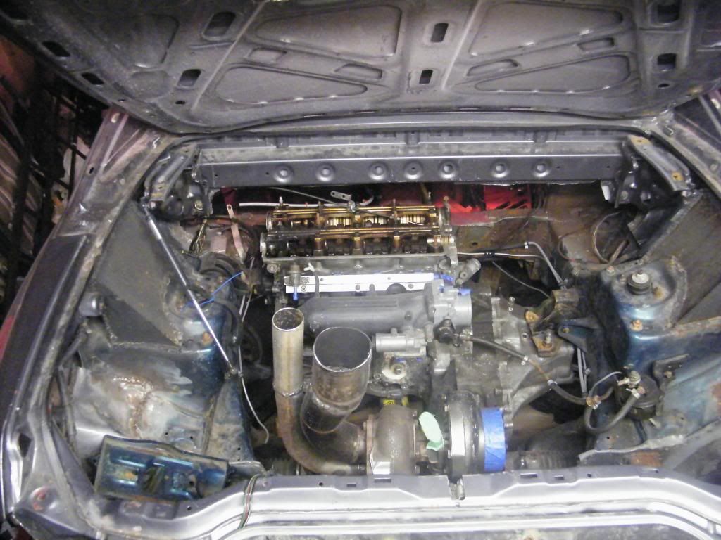

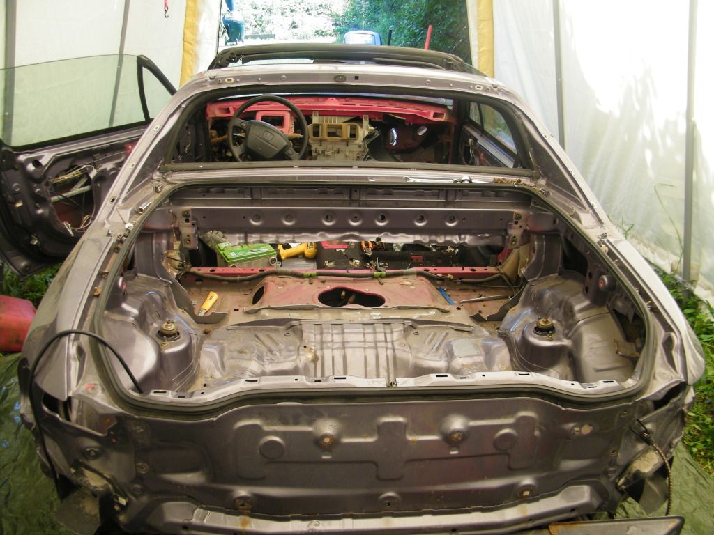

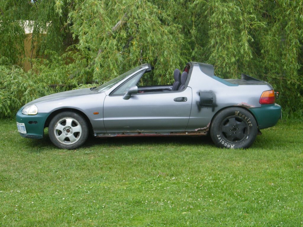

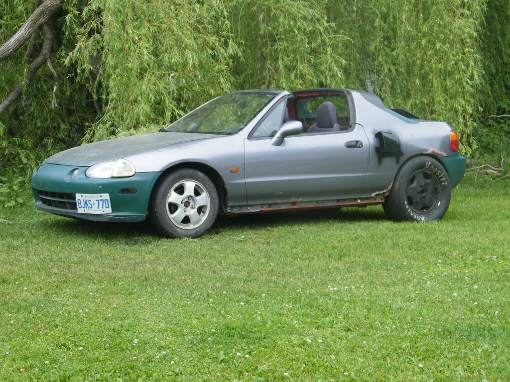

i have had alot of delsol's over the years and have always wished that honda had made then rwd. so i have decided i would have to make one myself. i wanted to keep it all honda so i looked at a wrecked S2000 but it was missing the motor so then i took my turboed ls/vtec out of my other delsol and got a 95 civic HB and cut the front off of it to grafted in the back of the delsol that i got as a parts car
the parts delsol before i cut it up

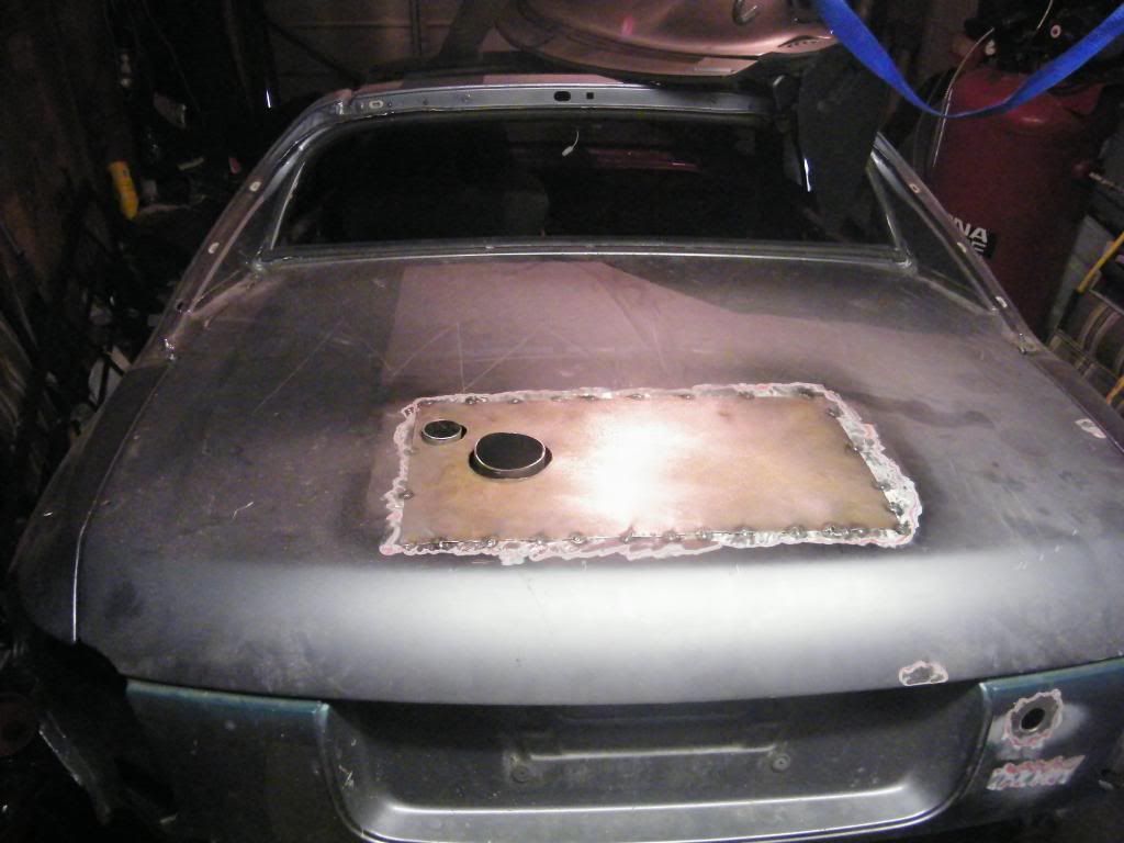

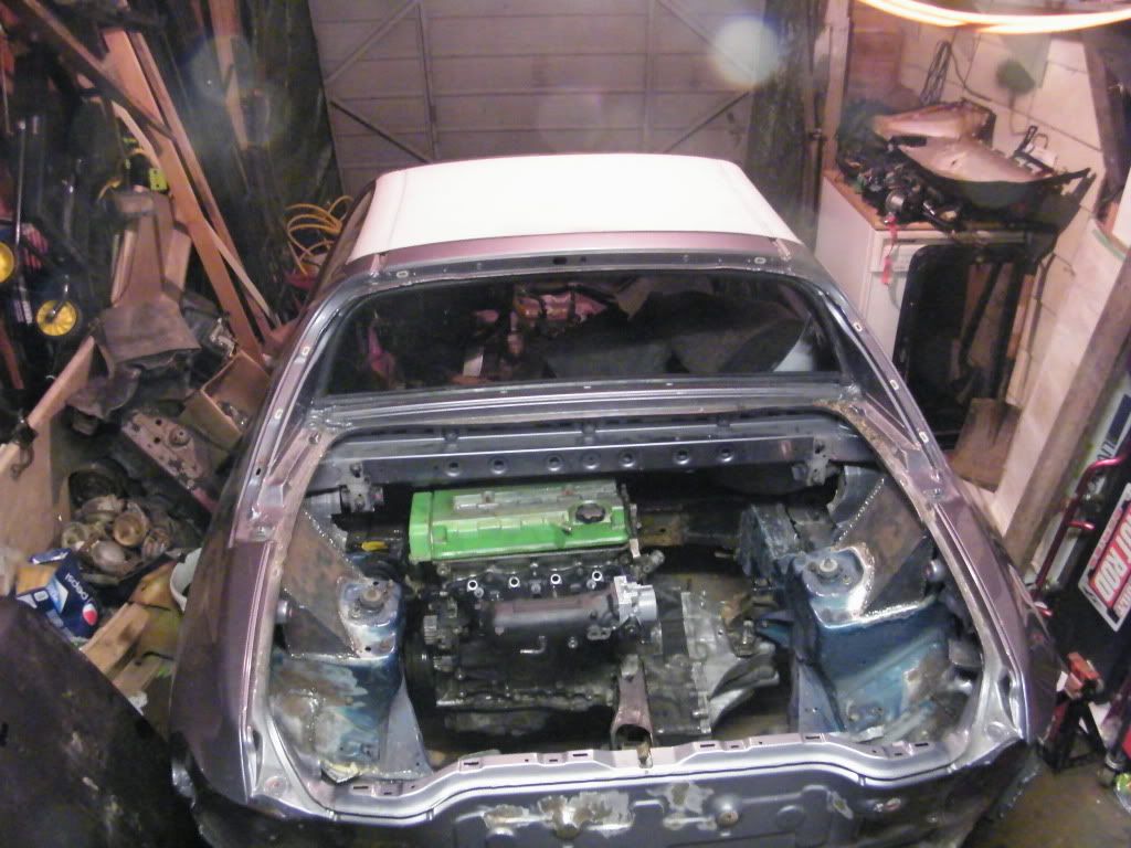

it took a week to get it all lined up before my first weld
with everything lined up and all the welding done i started mock up

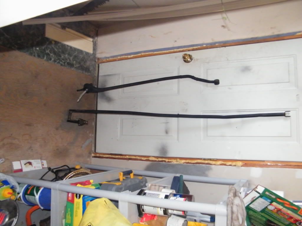

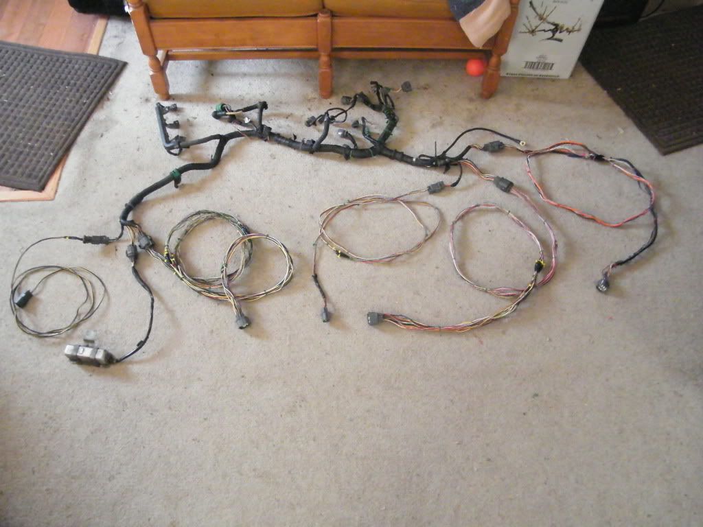

made shifter linkage,wiring harness
this is what it looked like last summer and yes it was my DD for 2 months
