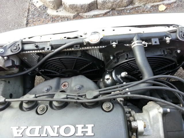

radiator is half shrouded. half open. with 2 12" fans.
downpipe and dump are header wrapped. manifold has shield. dump tube goes to ground under tranny.
I have tried to direct air to the radiator as best as possible. got foam insulation from core support to radiator to tighten air leaks.

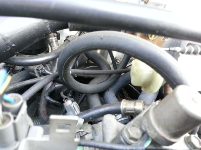

Is all the hole routed right?
I had similar issues when I got a heater hose and another like sized hose mixed up once.
Does the temps go down when the revs are kept above 5k?  :noel:
Re: crx keeps getting too hot/overheating. wtf.
« Reply #2 on: July 01, 2013, 05:41:46 PM »
seems as the revs go up it gets exponentially hotter...
as for routed correctly? fuck idk. I guess its possible?  how should the be routed?  :?:

airflow is your problem. If it works fine around town with no overheating, then its airflow across your radiator. get rid of your intercooler for a day and just run a pipe in its place, stay out of boost while doing this and I bet your problem will go away.
« Reply #6 on: July 01, 2013, 07:52:04 PM »
I have thought about pulling the intercooler and/or bumper for testing.
but one of the conditions I would like to test is wot/tip in at highway speeds.... mm...
if you are correct would an aluminum racing CRX or VW/rabbit radiator help?

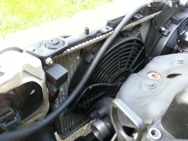

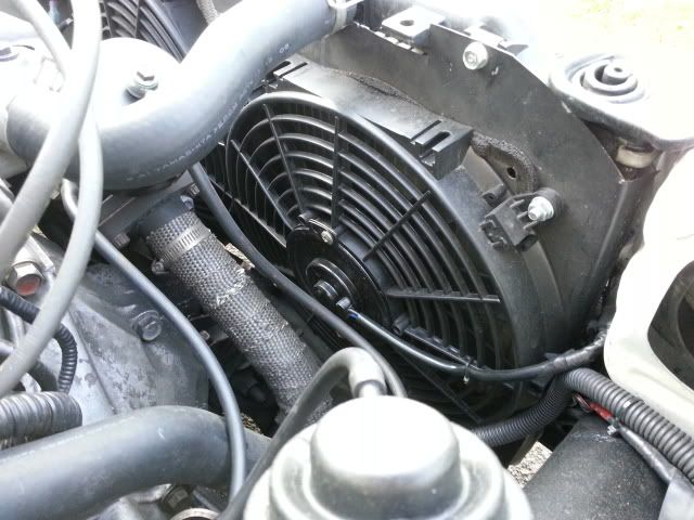

cant hurt to have a real rad, you have bare fans zap straped in the core or a real shroud? pushers or pullers? do they acually move hot air? not wired backwards or the blades on backwards or??????
« Reply #8 on: July 01, 2013, 08:03:25 PM »
post pics knee grow
« Reply #9 on: July 01, 2013, 10:43:12 PM »
fans should be on while im on the freeway?  ???
but to answer the questions, yes fans are wired right, yes the blow the right direction, yes they move hot air. passenger side is shrouded, drivers side is just ziptied to radiator. they are both pullers.
post pics knee grow
of what? my car overheating?
BTW. i know that this 210-215* shit isnt really HOT. just annoys me to see the needle moving up. shit the GVR4 gets to 234* before its "hot". and its usually cold as shit, like 178* when on the freeway. and it has an intercooler that has its own ZIP code. blocking the entire grill, with lots of space for the air to go where ever it feels like. and also has a useless ass AC condenser between the 2....  :evil: :evil:
buddy said he has an Ammco? racing aluminum VW radiator he is willing to let me barrow with a fan on it. but not sure wtf i have to do to mount that. and not sure i want it permanently, etc. he is iffy on if he wants to sell it.
i would buy a CRX full aluminum if i knew it would fit inside my chargepipes. but not sure it will...
fuck. would this be easier if the car was NA?.... hate.  built Y8 swap FS.. PM for details...

coolant bypass/heater hoses as shown in parts catalog for CRX and EK/Y8....
