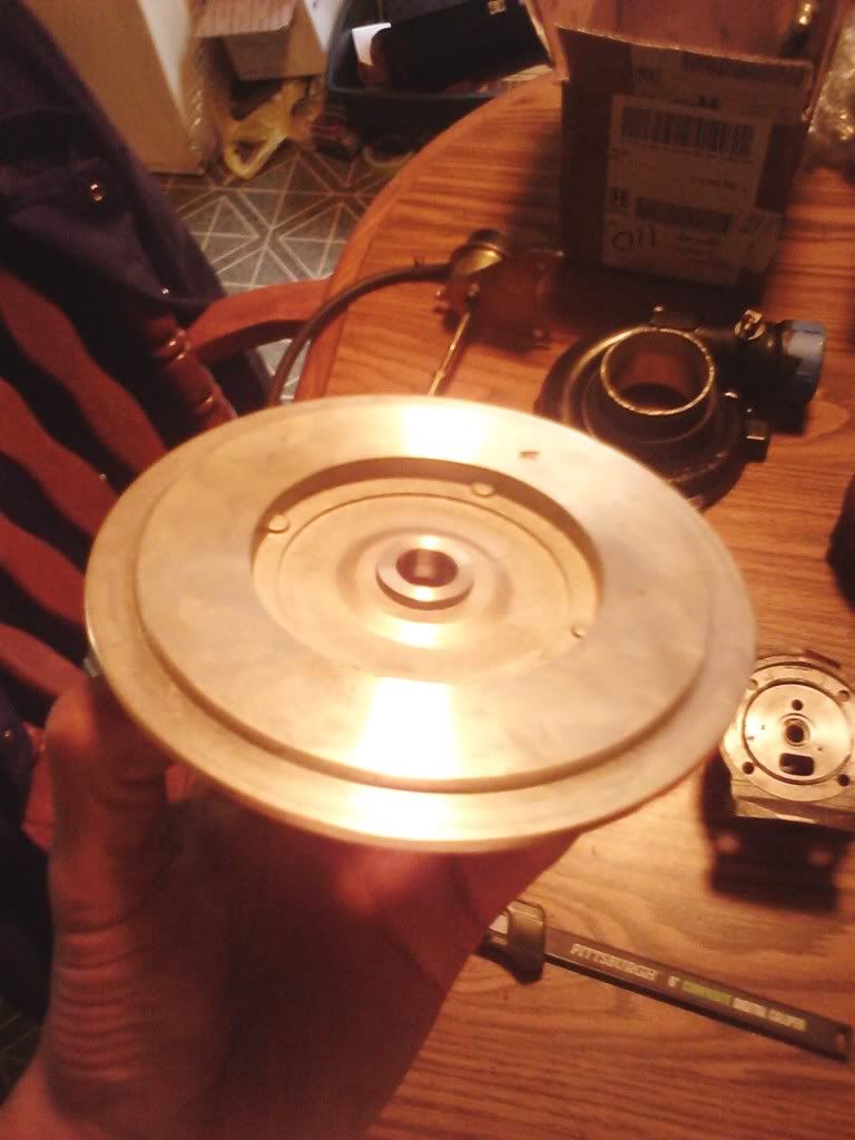

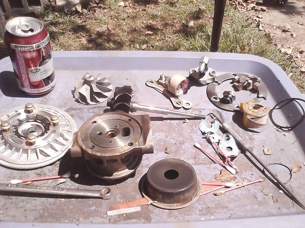

I'll update with pics here in a little but i just got done taking everything but the larger bronze shaft bearings out.  I'll have to modify a pair of my snap ring pliers tips.
It's been a nice, cool afternoon so i thought i'd enjoy the outdoors then bring it on inside

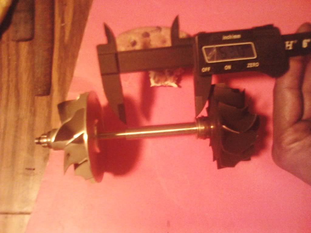

I should add this is a 70mm comp wheel ching chong. Last time i had it apart (inspection) i had poop analog $5 bargain basket calipers.
Turbine shaft measurement:
10mm on the wide end (shaft bearings), 6mm on the narrow end (thrust collar/bearing)
53mm from turbine bearing seat to the step.
Dynamic bearing thrust collar.
bearing ID-   6.5mm
Thrust bearing journal OD- 9.4mm
Thrust contact (via oil film) surface 2 surface distance- 4.6mm
Stack height: 18.3mm
270* thrust bearing:
End play thickness/thrust contact-  4.1mm
Bearing ID -10.6mm
Chra journal bearings:
Compressor side- 10.2mm
Exhaust side- to be determined

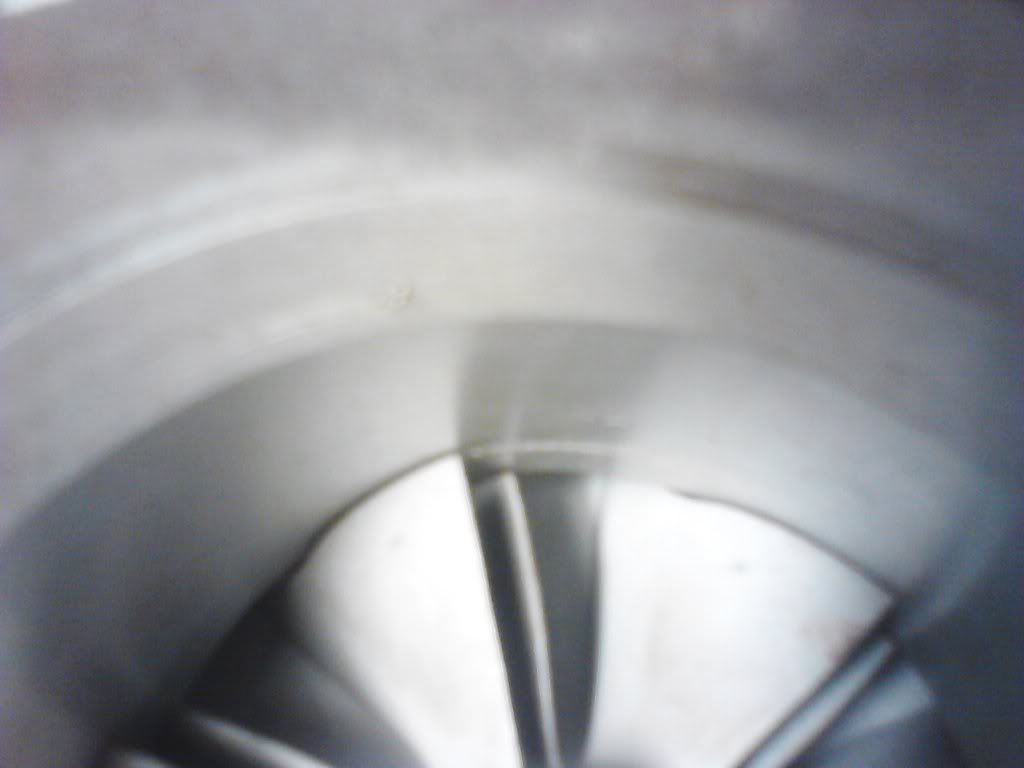

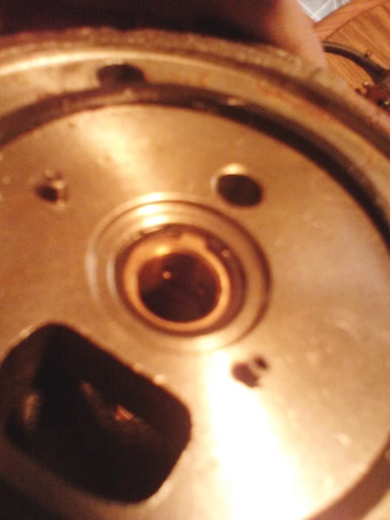

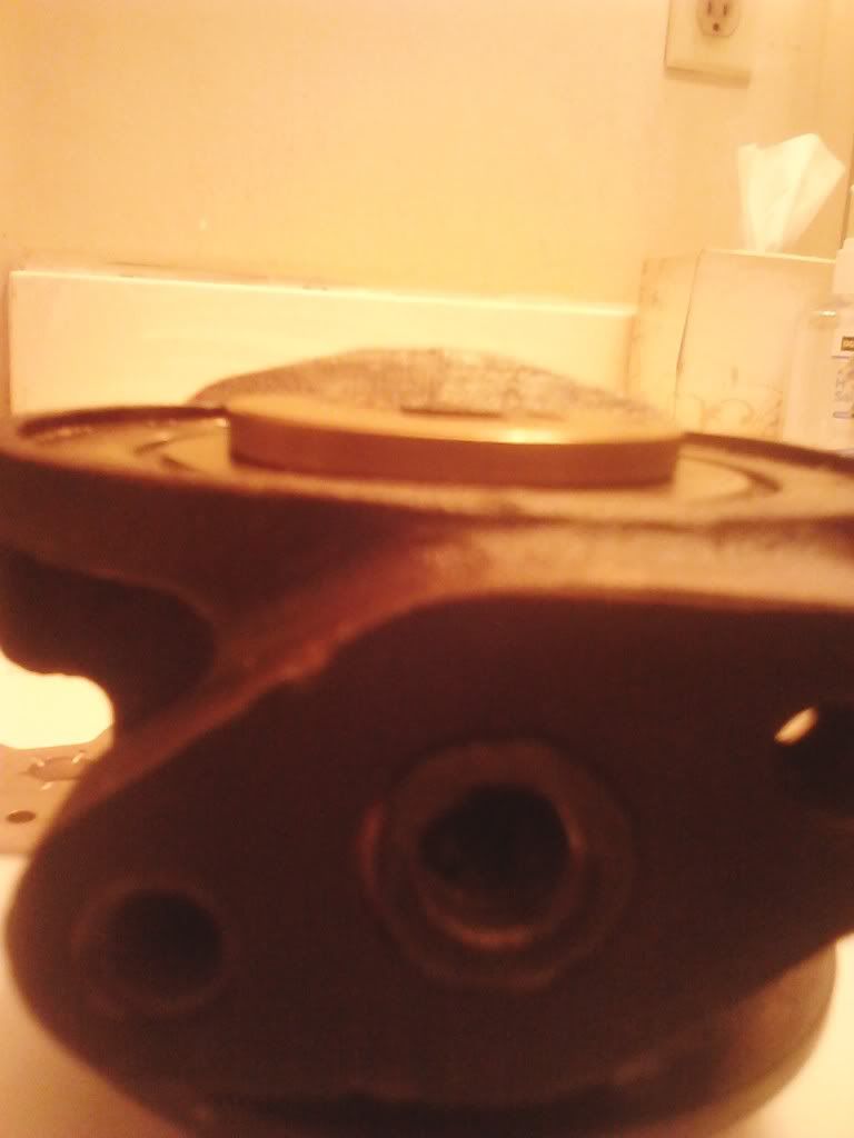

End play is MINIMAL, less than half a mm (checks out with that gap difference in the thrust collar/bearing) but enough to make an audible clunk when you push and pull on a wheel.  No visual wear anywhere but on the dynamic seal bearing a little. Compressor and exhaust wheels came out fine.  Turbine shaft looks as clean as it was when i polished it out with toothpaste and a shoe string (true story).  Doesn't look like it ran dry but there wasn't a whole lot of residual oil in the chra.  Some had started to weep past the rubber piston seal between the compressor plate and bearing housing.
No oil here though.
Opting to rebuild it because i'm in a bit of a pinch right now.  Selecting a kit that's within spec is where i'm seeing grey.  There is the option to go steel 360* thrust for roughly $100.   Bronze 360* thrust without collar (none pictured) for about $50-60 and standard 270 bronze with thrust collar for $35.    Need shit quickly.  Doesn't help it's holiday weekend.

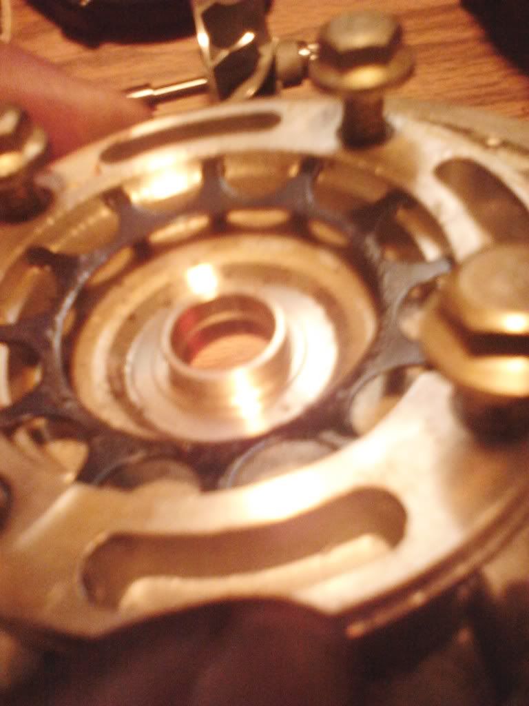

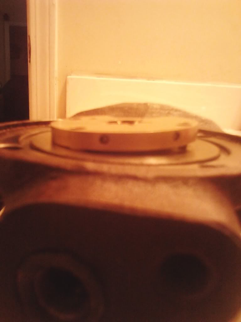

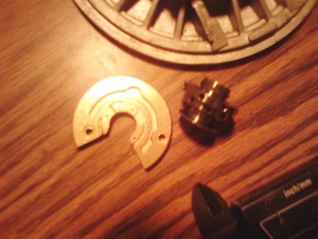

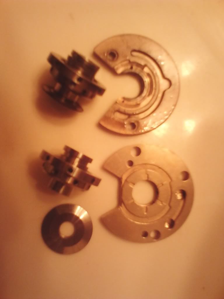

I took some measurements of the blown t3/t4 i just picked up.
Seems that 10mm shaft diameter is the norm and 53mm end to end on the journal bearing contact area with these types.  That's good.  I mean it's good within the nearest thousandth of an inch good.
OOOOH and um this 360* bearing/collar is super close.   i just got fits way tighter on the thrust collar than a brand new 270*.  I like it.  I like it alot.
Another observation is the dowel pin holes are very exact.  Meaning i may have to tap this thing onto my chra or slightly ream the holes.  The concave cog spring on the compressor backplate and the turbine shaft line that up when you torque things down anyway, right?
270* bearing holes are reamed out enough for drop in on the dowels with some movement allowed.
If nobody gave thought or time to things the world would be a boring place.  A more retardeder place than it already is.   Spell check says "retardeder" is a word.

Well, the thrust washer from the new kit wont allow the following:
-interface with the step on the turbine shaft
-rotation when whole stack is torqued down
-oil from the top hole to pressurize the thrust bearing ports because it wont sit flush due to the thrust washer being too wide
I said fuck it.  Trying to get up on a holset now.  Fuck ching chong meow.
If rebuilding, do it out of the box with a 270* bearing and have a shop balance the wheels.  $50-65 for that service.   I still have the turbo.  If i can't sell it i'll get all the parts from gpop shop and have them hook it up.  Would still have me at less than $300 in the whole turbo.
