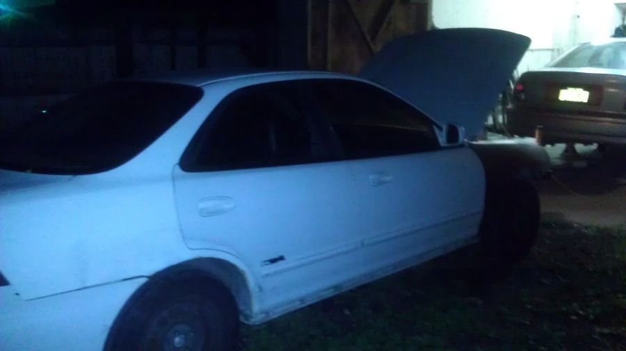

Couldn't find the other set of jack stands, so we couldn't get to the axles and mounts, but we've gotten everything else disconnected.
Crappy cell phone pics, GO!
The car:
Previous owner had a type R badge on it.  Just the adhesive is left.  Car is rough, but the quarters are all there, so that's cool.

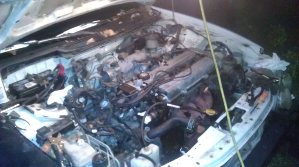

Under the hood, typical haggard stock DC:

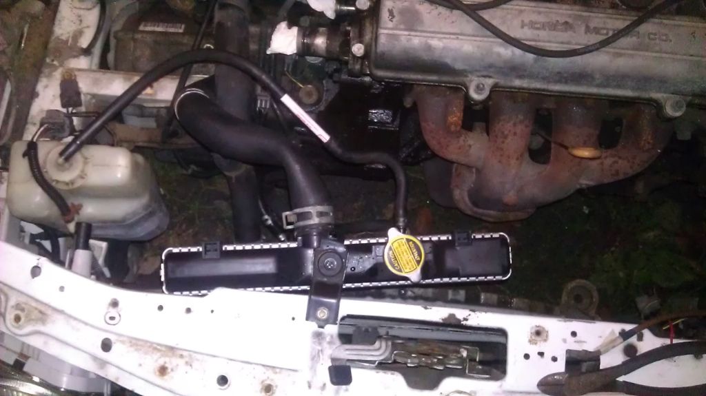

Gangster lean half rad:

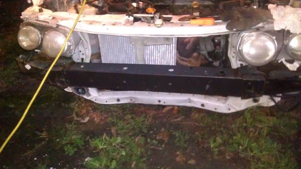

Lower core support is kinda fucked up:
We tried straightening it.  Hooked a chain to it, then attempted pulling it with a come along and various vehicles.  My accord ended up just dragging the integra out of the garage (fuck yeah snow tires).  We've lifted the teg by the bent up lower bar a bunch it times, it doesn't move.  Screw it.
