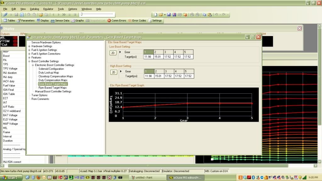

I'm running boost by gear 12, 15, 18, 18, 18

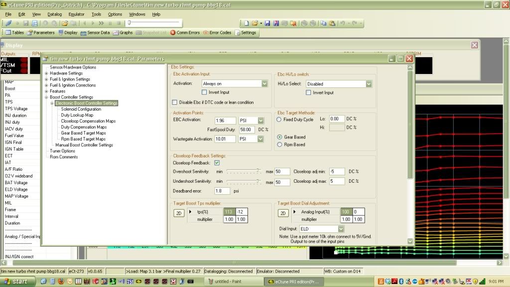

Whats your fast spool duty and WG activation set to?

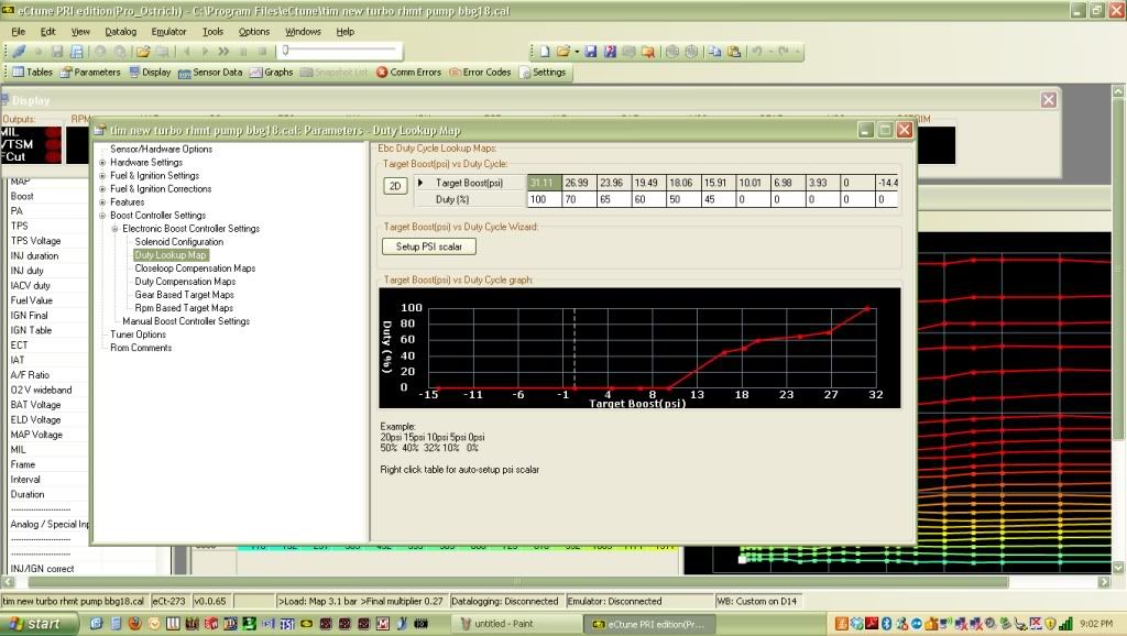

The cold air may require different values for your duty lookup map or "Correction P" in the closed loop comp map. It's been a while since I messed with it though.
Try using a fixed duty from your duty lookup map that's a little above your wastegate pressure. If that duty gives you far more boost than what the chart says it should, you need to lower the values. You can apply more correction by increasing the closed loop "correction p" too, but that can lead to wandering boost if your duty lookup map is wrong. My car would get 15psi in the summer and 19psi in the fall with the same duty %.

Tom suggested I pull 5% from my duty lookup

ebc activation 1.96 psi
fast spool duty is 58DC%
wg activation is 10.01 PSI

Fast duty should be either 100 or 0, depending how u have it hooked up.

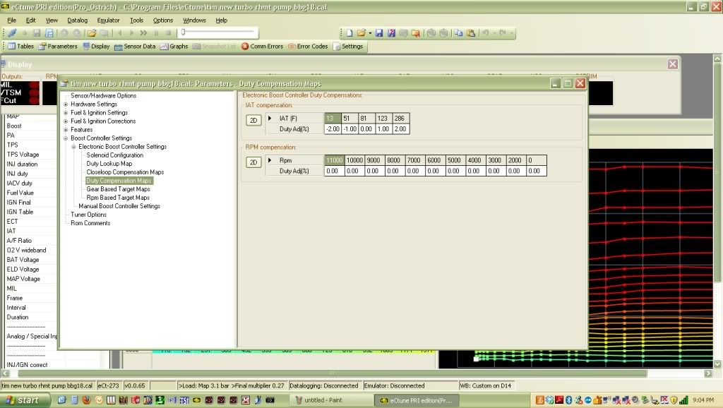

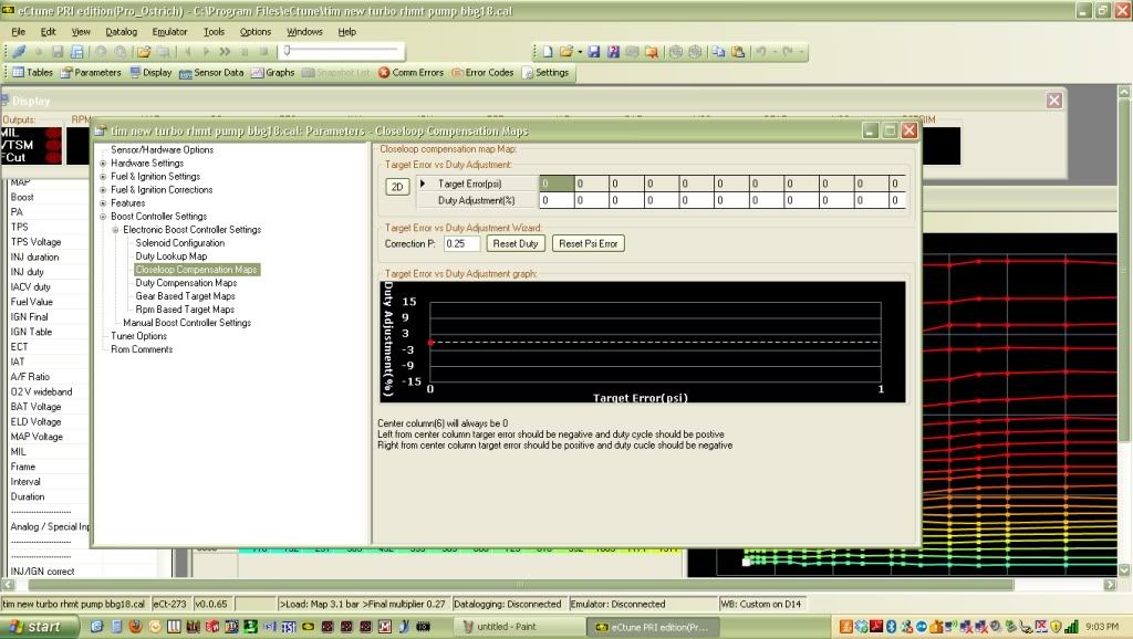

What is your EBC target method?  Gear based I assume?  If so, take a screen shot of your Duty Lookup Maps, Gear Based target maps, and Duty Compensation maps.
Try lowering your WG Activation to 8psi.  Or there abouts.  That will help not overshooting first and 2nd.

Does your closeloop work?  you should have values in the closedloop comp map.
