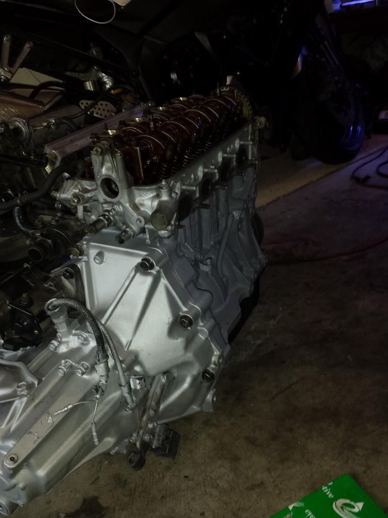

I have always used oven cleaner, then you could go back with a stainless wire brush to get rid of the dark color I guess. I always paint silver.
Paint looks like shit
I'm not using Mexi chrome or anything. I use a flat silver that looks like new aluminum.
