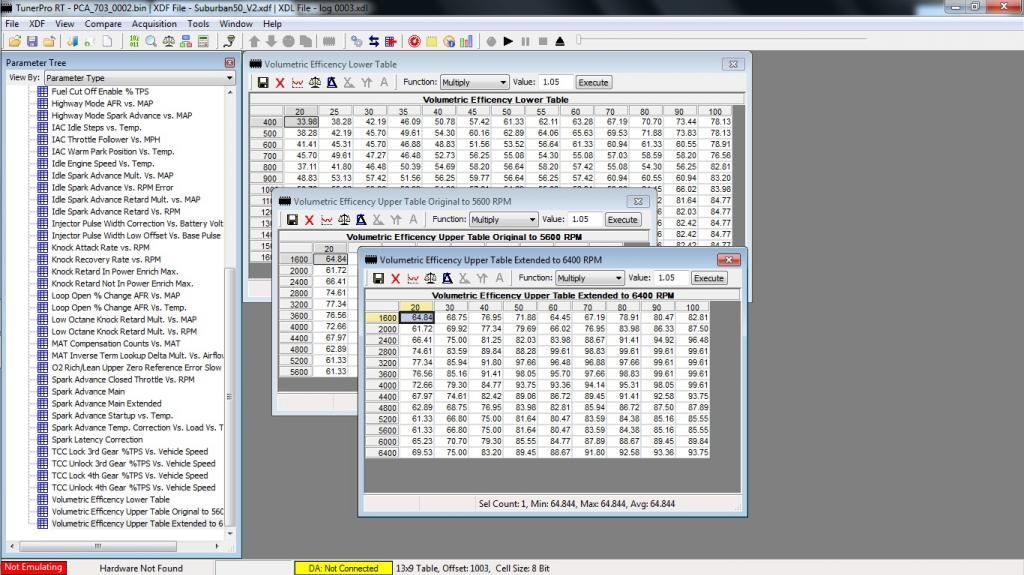

No its only 1 bar scaled. GM doesnt run maps like honda were you get a 1.7bar sensor. If you can edit the XDF i would imagine you could maybe change it to run a 2bar. I dont do code so fuck that noise.
Here are the 3 VE tables..
and it was in this ride:
