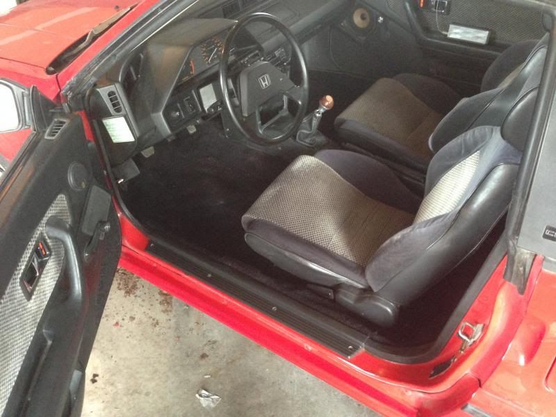

Thats the car,  still has the NOS decal on it..  for $500 with a rebuilt motor and a clean underside I couldn't pass it up.

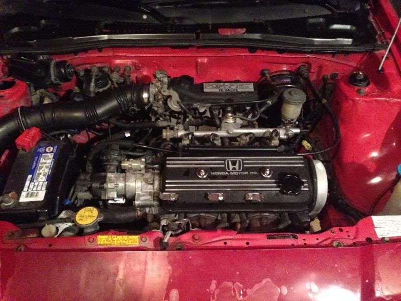

HF manifold, Talon side mount, integra injectors and a RRRP

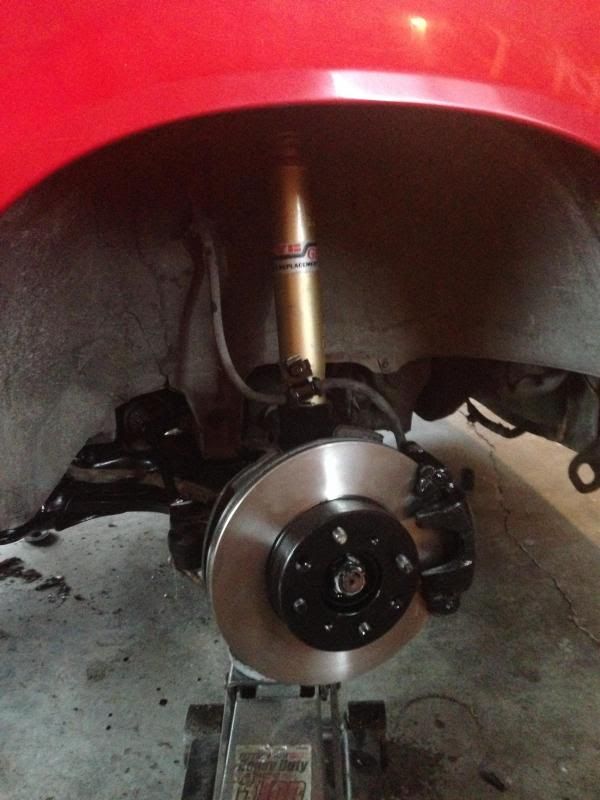

Ordered rotors, pads and flex lines, fund some Teg torsion bars.  car already has some tokico HP's on it and some no name springs.   Friend of mine had one of these with Mikuini's... so badass

T25 from a Saab.. on the hunt for a HF mani.
found a manual boost controller, couplers and I think a Talon side mount.

HF manifold won't fit the EW4/D15A3 motor if I am not mistaken.  You'll probably crack a piston down the middle under power... they did that a bit while stock.

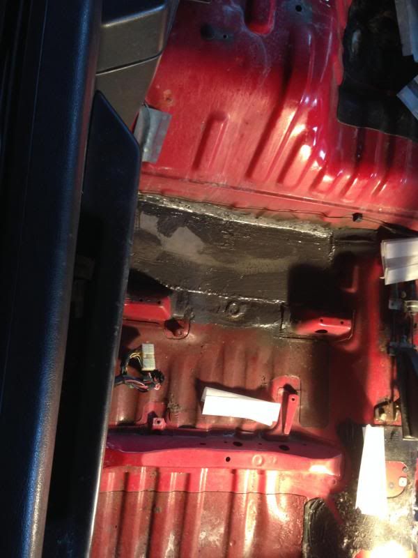

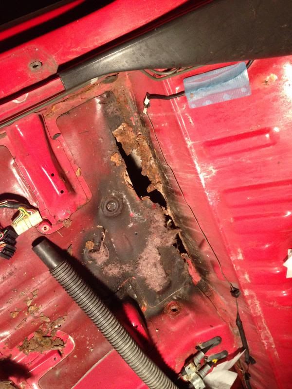

the last week I patched 4 floor issues, mig'd , seam sealer...etc...ect..  I have a full poly kit,  re-dyed the carpet and got some sweet 2 piece SSR wheels for $100

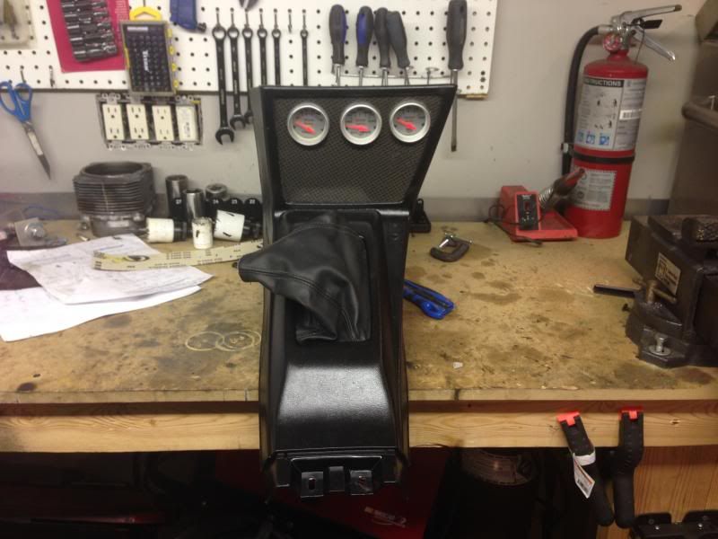

cleaning

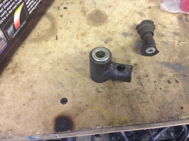

Even after the poly shift bushings it still shifted like a dumptruck... the problem wasn't the bushings, but the coupler at the trans.
The solution..
a steel bushing from a poly bushing... Heated up the coupler, froze the new bushings and put em together.. shifts tight as hell now.
console was a bit abused.. a chunk of CF, some left over autometer gauges and plastic dye ..good as new

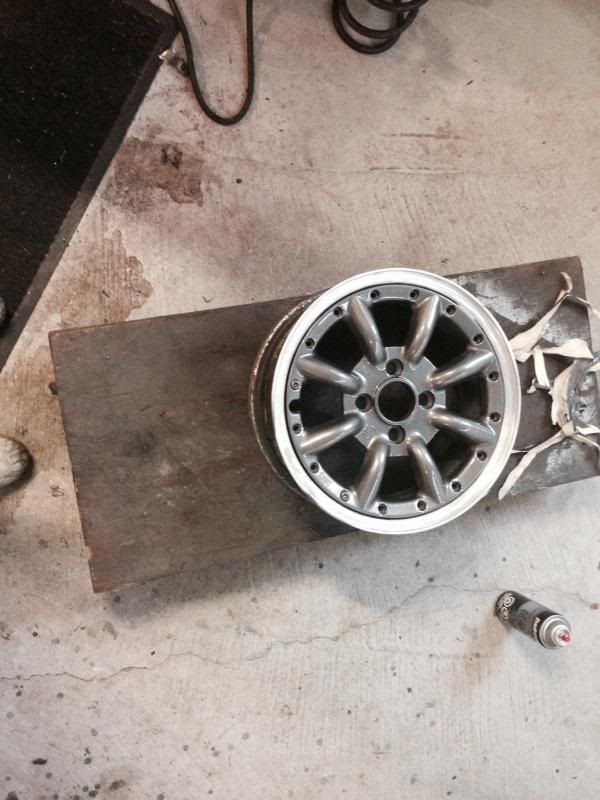

Well.. I got them home with 10 coats of brushed on paint..  Long story short  - they are SSR wheels , 2 piece wheels..  Date code is 1990,   stripped the paint, new bolts on the way... still need to polish the lip

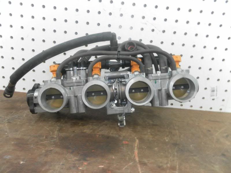

08+ CBR600 orange injectors.  275cc, atomize like a dream.

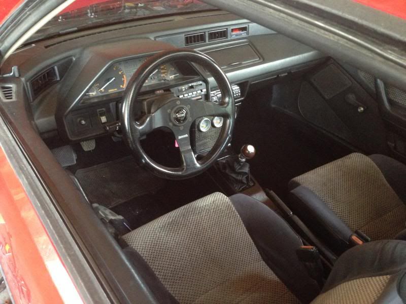

Added an old momo wheel I had kicking around, Cleaned up all the Vac crap on the motor and hid a lot of little boxes to make it look cleaner. 1 SSR wheel refinished , 3 to go. Ordered new bolts for the wheel halves as well.

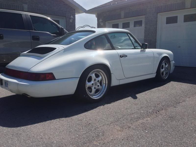

Also lowered the 911 a bit more...
