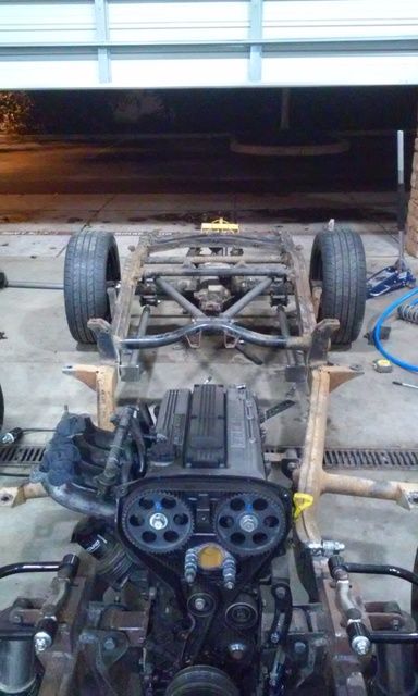

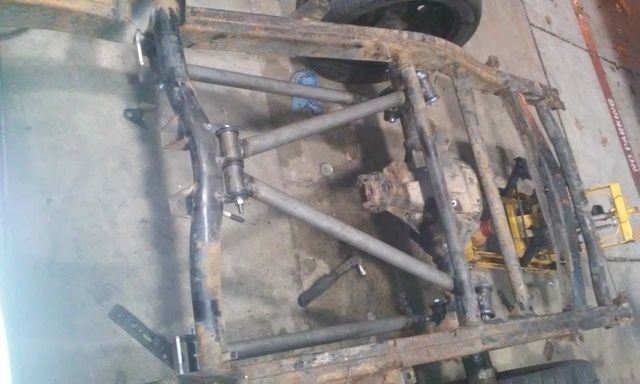

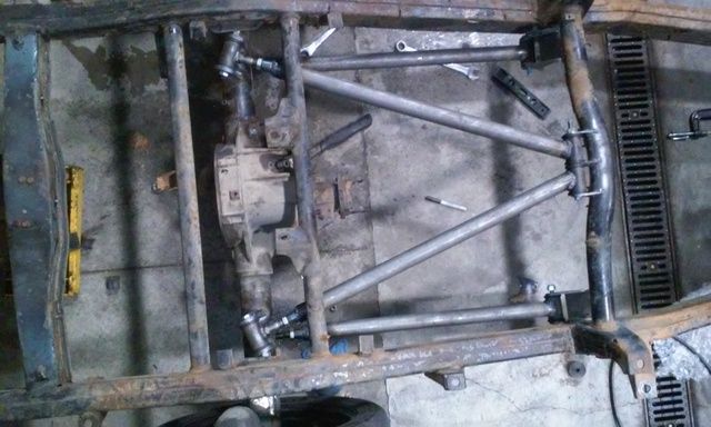

finished the lower bars and got the brackets tacked into place. ill pull the rear end out tonight and finish welding it all in and mock up the coil over tabs. ill also cut the crossmember out thats over the pinion while im at it.
i think im going to have the frame powder coated and obnoxious neon orange like this. i think it will pop with the blue

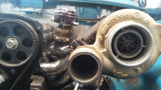

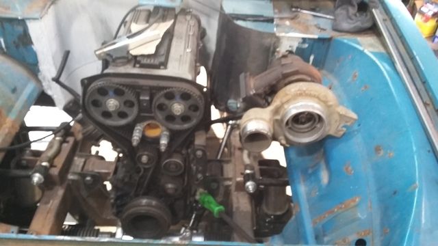

i finally found someone selling a Holset that is not a fucking flake. i want fast spool and drivabiility  over peak power so i was looking at HY35's but came across this HE341W for $200. spins freely and has zero play. im so happy to finally have it to start mocking up my engine bay!

Looks similar to my HE351ve, except it has vgt control box on it.

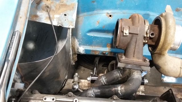

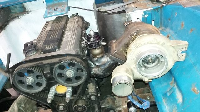

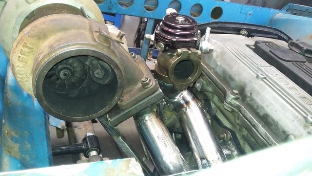

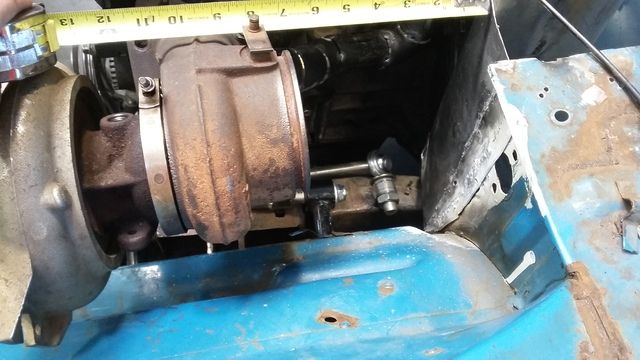

not yet. its slow going to to lack of funds and its hella nice out so ive been on my mountain bike a lot. a buddy of mine had my flanges laser cut so i can start mocking up the manifold. heres where the turbo is gonna go.

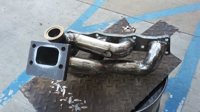

fastivab6tg25mr
  • chicken fucker
  • Posts: 1615
Re: making my 73 ford courier go fast, turn, and stop
« Reply #69 on: May 10, 2016, 03:05:55 PM »
Just got my weld els! Should have a manifold by this weekend!

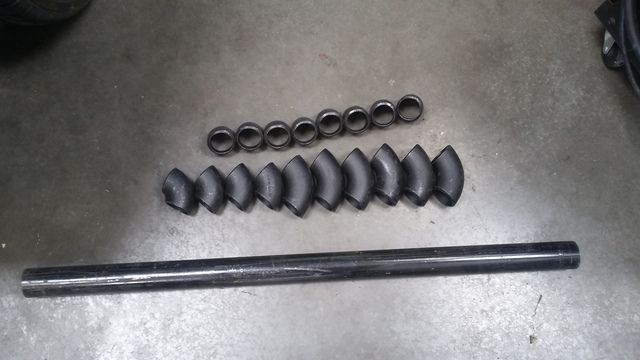

« Reply #71 on: May 13, 2016, 11:14:52 PM »

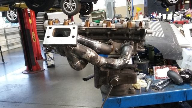

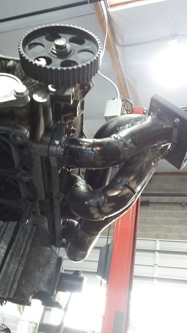

I got runners 1 and 4 done so far,  I feel retarded fir how hard it is to fit the pieces together...
« Reply #72 on: May 15, 2016, 11:32:54 AM »
Looks like it will be tight for a downpipe?

« Reply #73 on: May 16, 2016, 11:15:02 AM »
Should have plenty of room for the down pipe and heat shields.

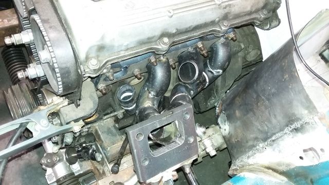

« Reply #74 on: May 23, 2016, 12:36:51 AM »

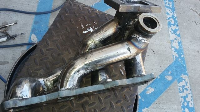

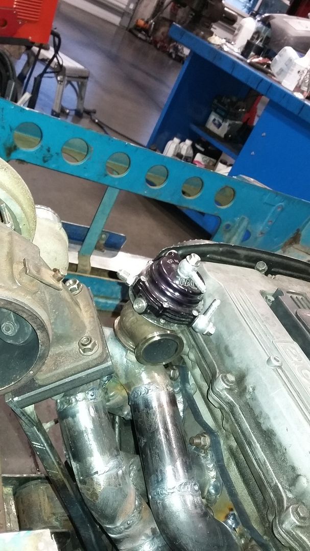

i ran out of argon before i could finish all of the bottom welds but its just about done. trying to figure out the order to do the finish welding in was a pain and took forever.
had to weld up 1,2,& 4 with 3 out then weld the 1-3 collector elbow onto the T3 flange. then the elbow off of thttp://www.realhomemadeturbo.com/forum/Themes/core/images/bbc/ftp.gifhe head flange had to be welded completely to the straight bit. it left just enough room between 1&2 runners to fit the torch in there to finish off #3
looks like the only spot to mount my Tial MVS is gonna be straight on top of my #3 runner. ive seen manifolds that do this but not sure how i feel about only tapping into 1 runner for the wastegate. even if its right at the collector.
« Reply #75 on: May 23, 2016, 11:51:46 AM »
Oh, must have just been the pic, looks good.

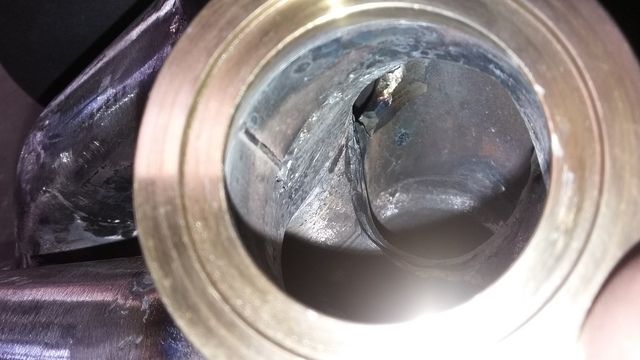

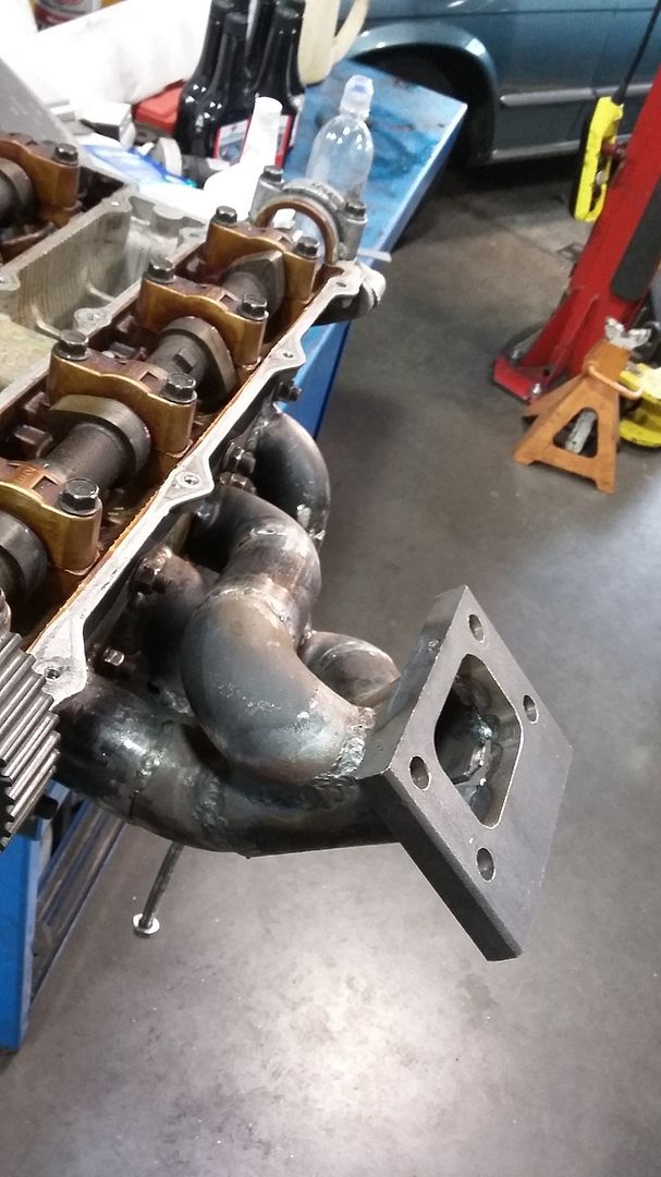

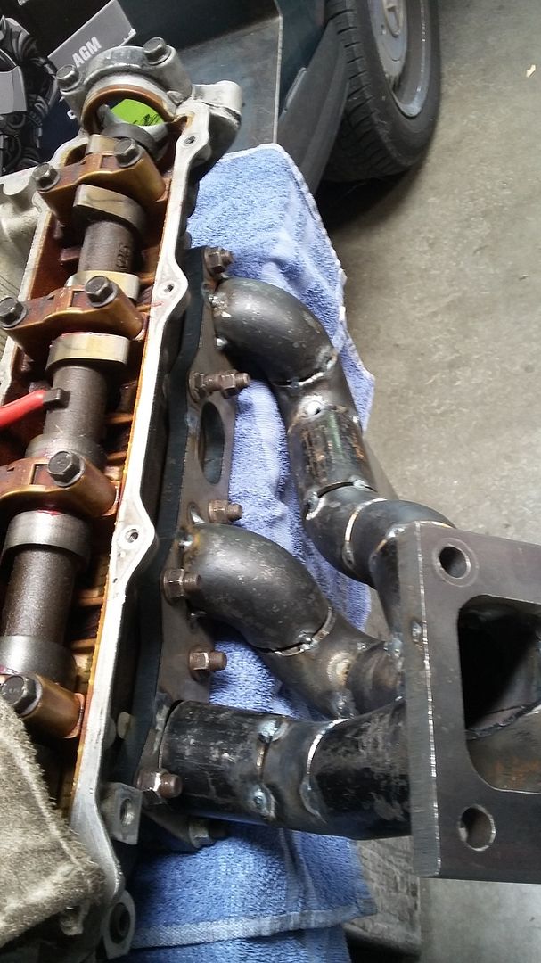

manifold is done! just gotta send it off to get ceramic coated now.
a look down into the wastegate flange

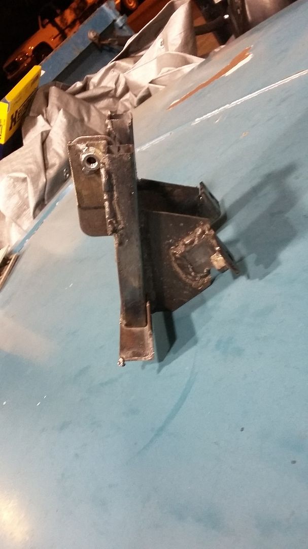

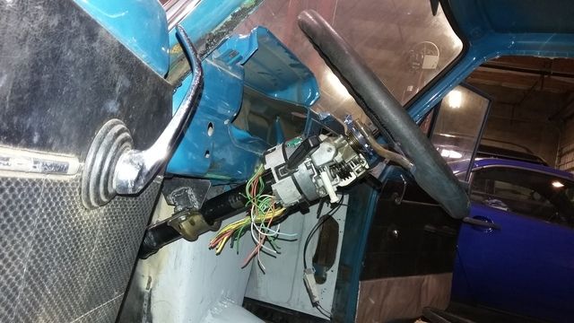

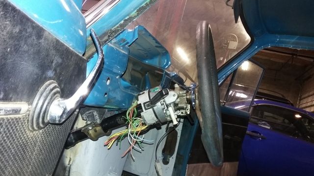

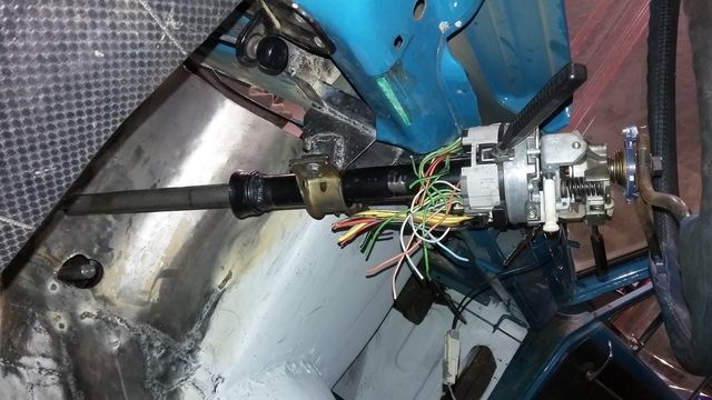

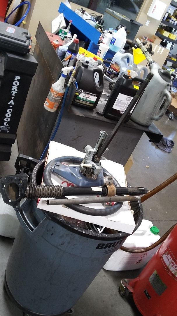

im still learning how to use my lathe so i gave up on the flange for the moment to build my steering column.

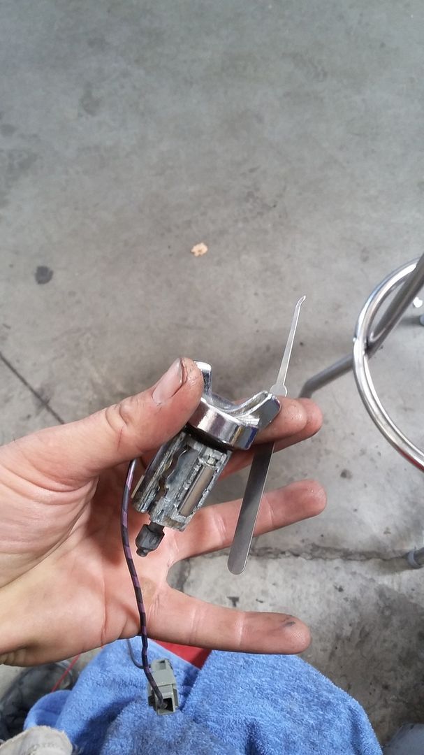

started out with a bronco 2 tilt column cause it was the most compact. cut abut a foot off of the housing and cut the outer support cup off and welded it to the shorter shaft.  i was able to pic the ignition lock and bought a new replacement from autozone for $16 with 2 keys
i tacked the piece of angle to the firewall and built this shitty bracket to hold it all up. after every thing was tacked in place i broke the  tacks to remove and fully weld all the seams.
