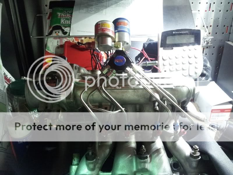

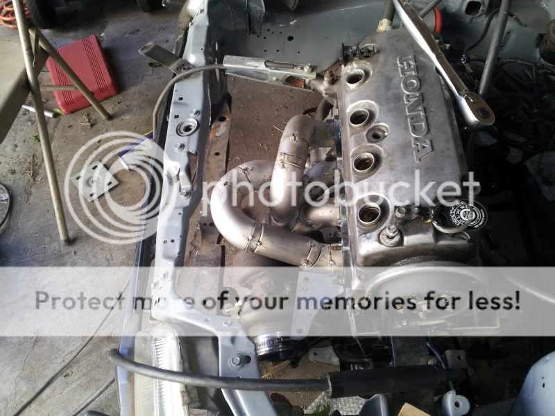

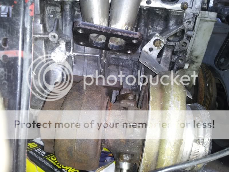

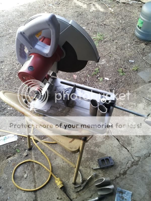

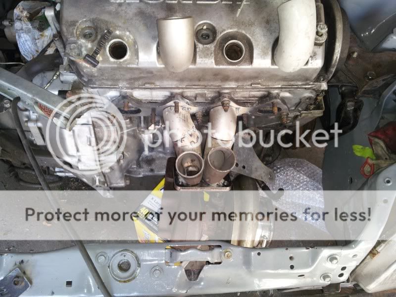

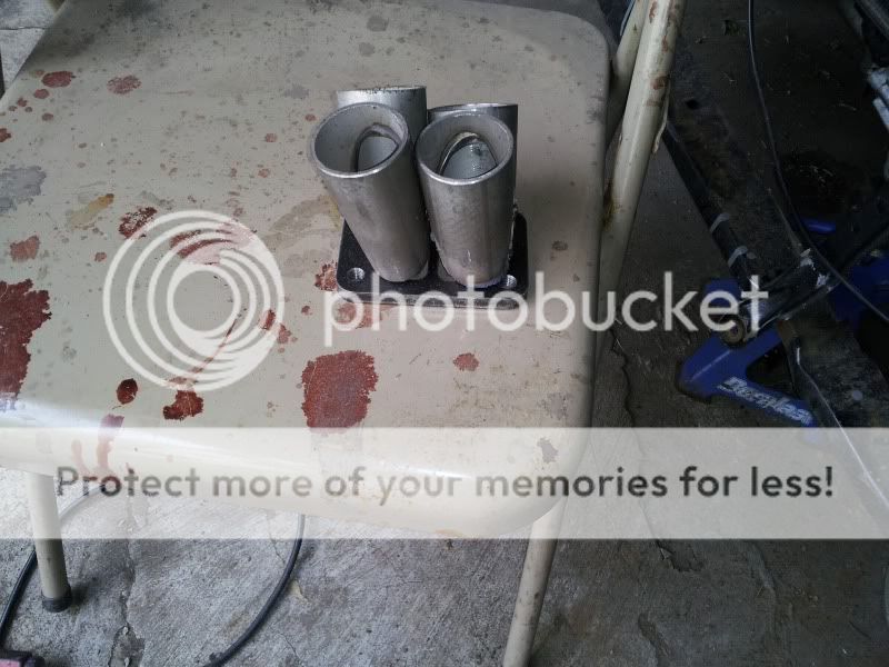

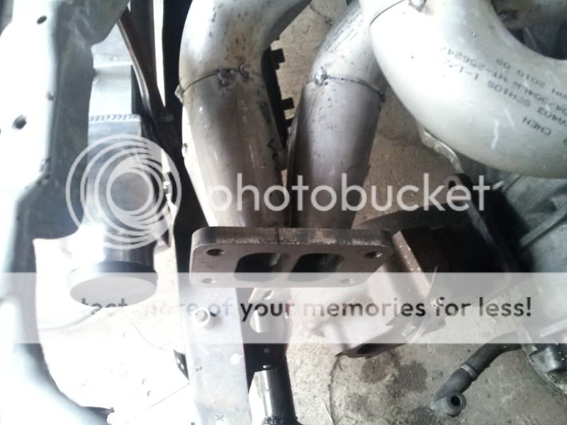

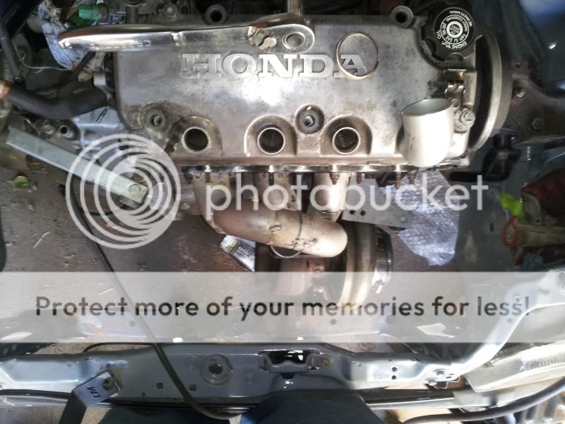

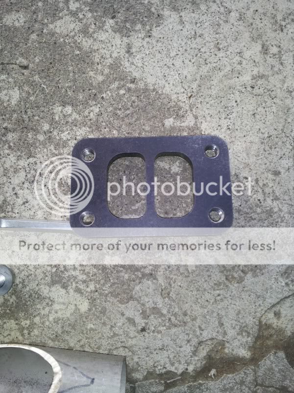

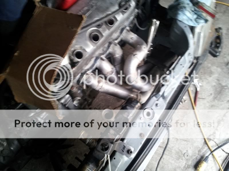

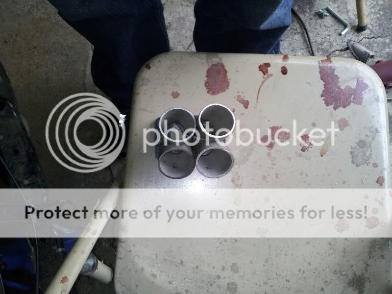

The start of a new manifold, Weird tech flanges, piping, and traction bar setup.
Plan is to make a true twin scroll manifold, with the 12cm hotside I should be able to make full boost almost 1k sooner. Only one way to tell.

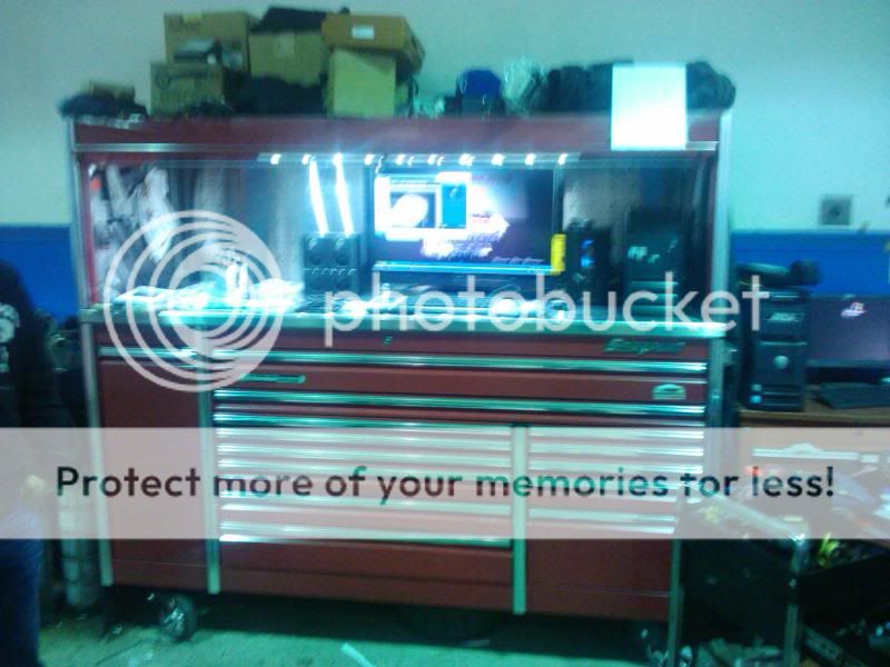

And my friend baller tool box, yes thats a 32" tv, yes there is a loud system in it, and yes it is all hook up to a computer!:bigok:

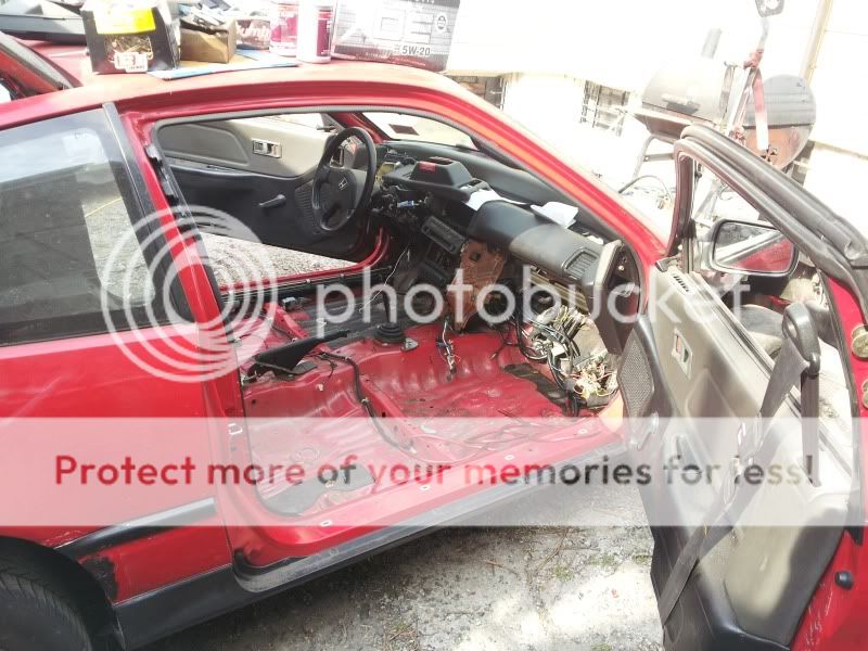

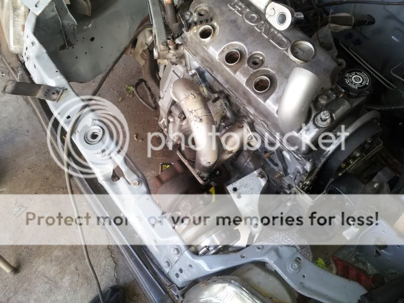

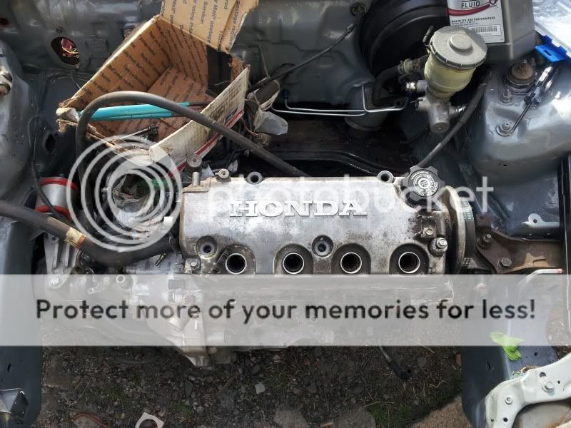

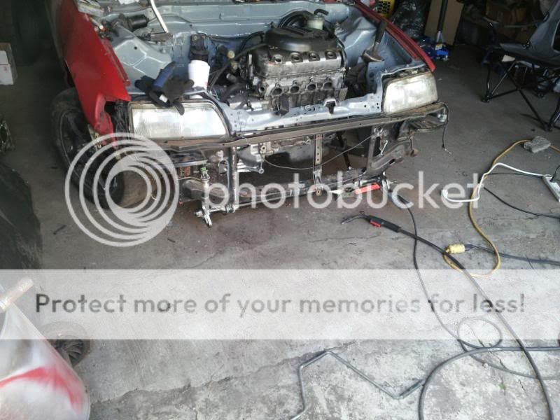

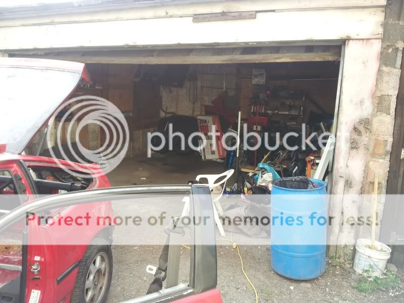

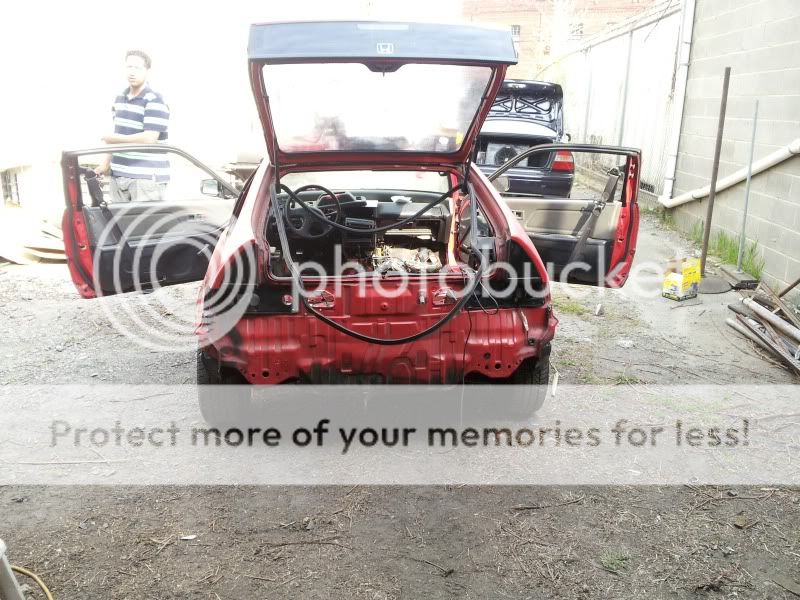

Well it looks like a while since I last updated this post so lets get to it. I been busy getting stuff done and staying away from the computer in order to do so.

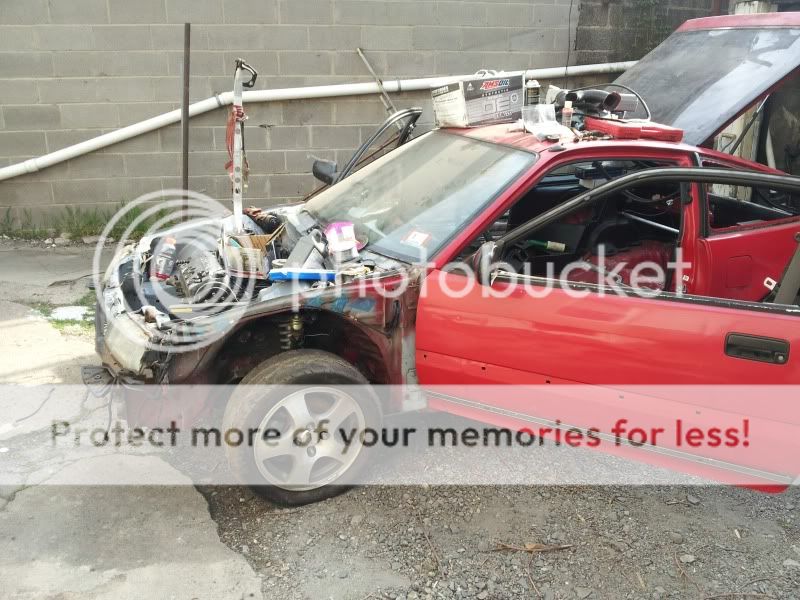

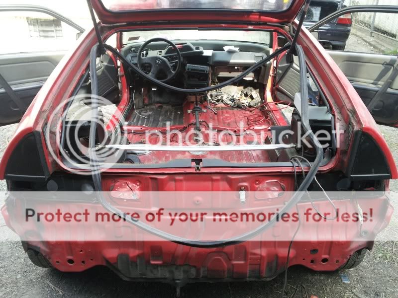

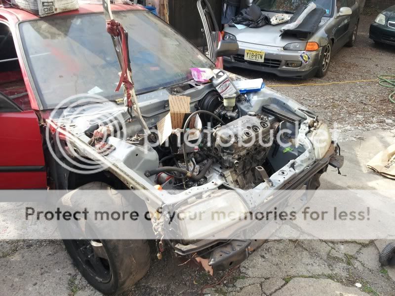

I had strip the interior of the car to clean out the glass and the layer of dirt from setting.
Oh damn we got a problem ;DDD
Blood, sweat and lots of f bombs hahaha

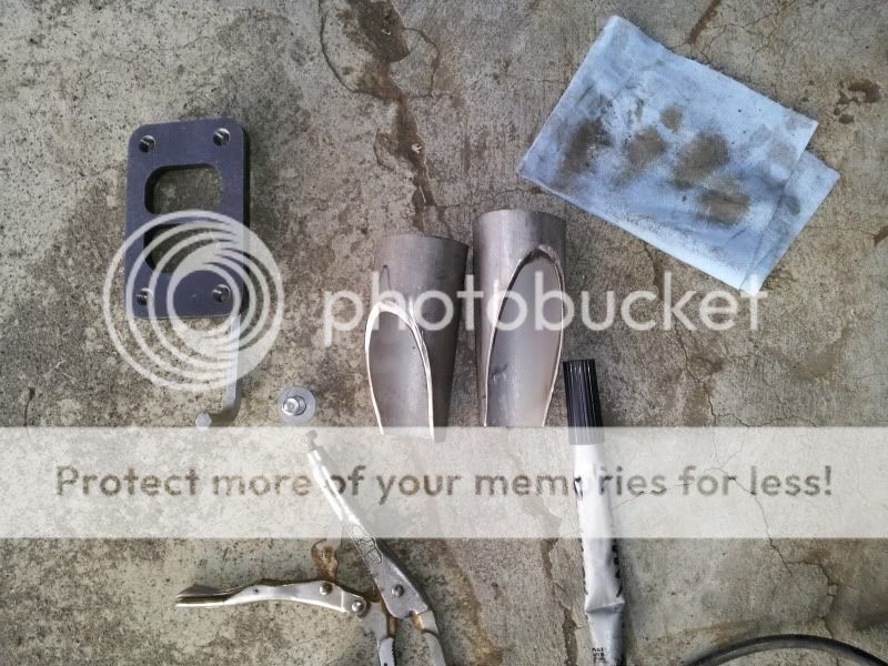

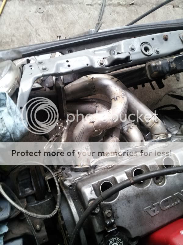

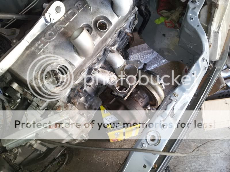

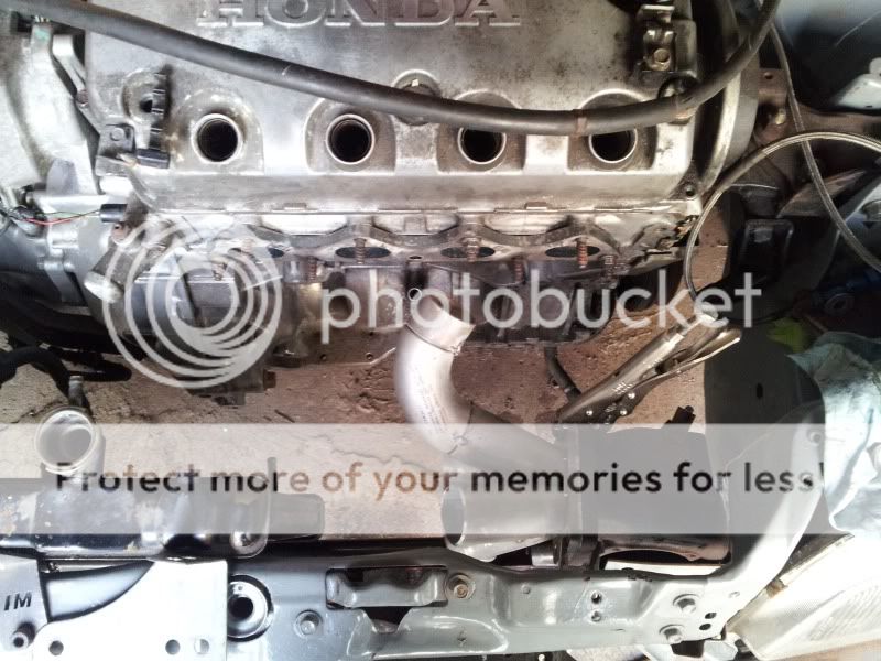

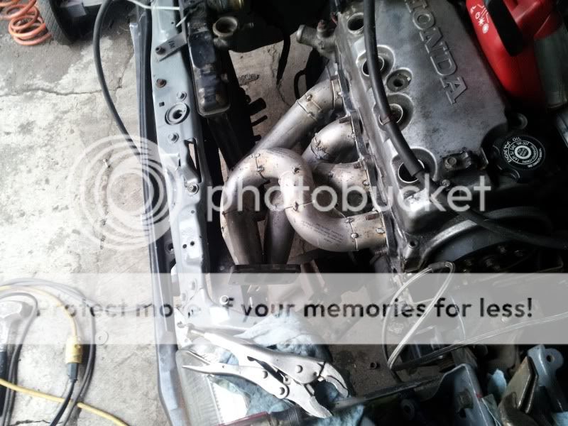

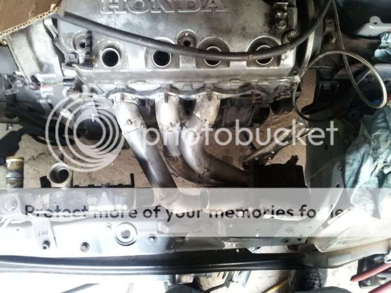

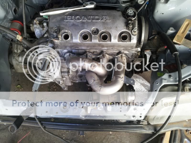

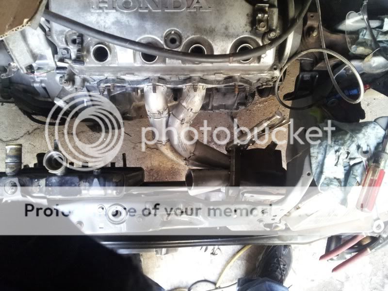

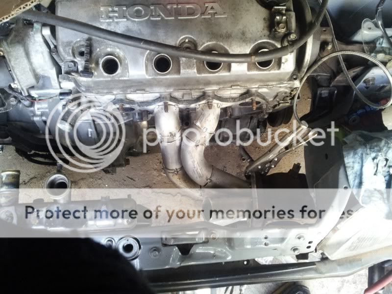

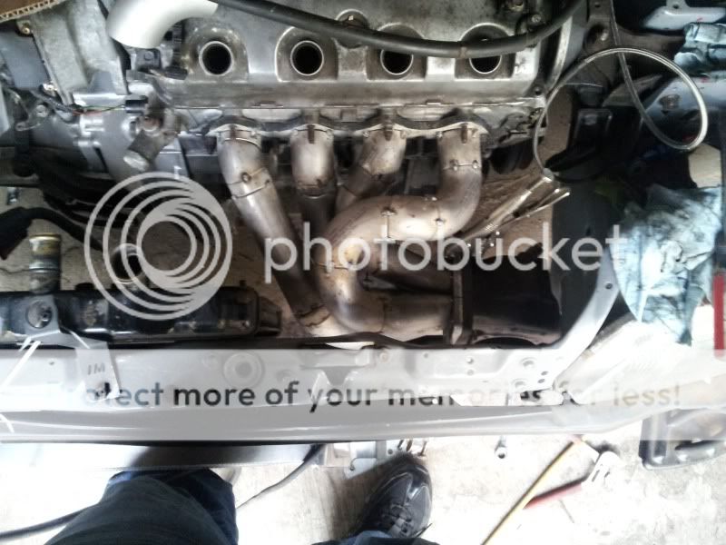

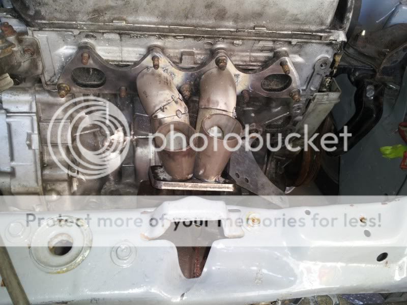

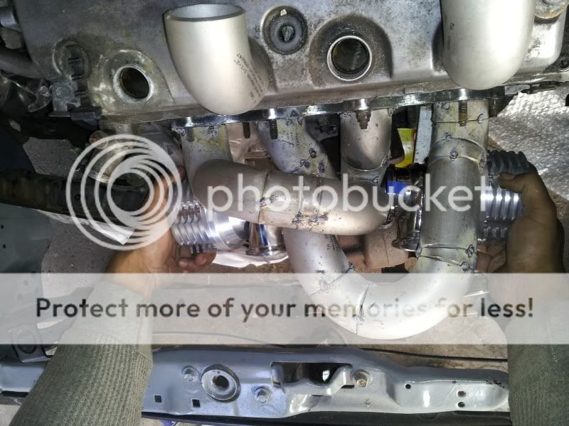

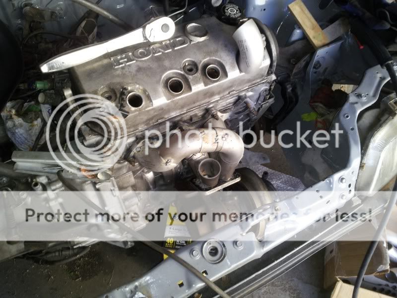

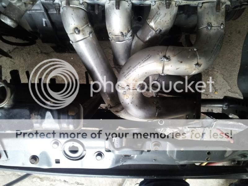

Well onto the good stuff, new twin scroll manifold.
Then came this
Love sparks!
Doing work

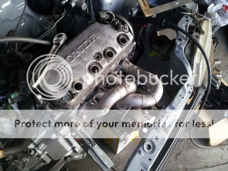

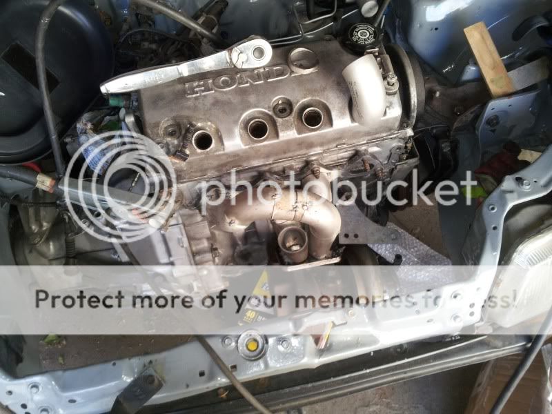

Oh yea

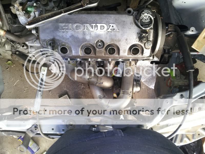

Front in on.
Thats it for the weekend.

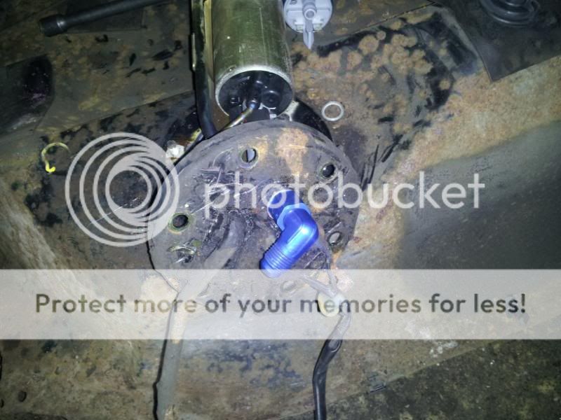

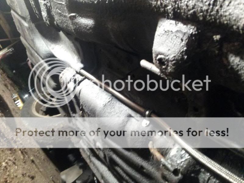

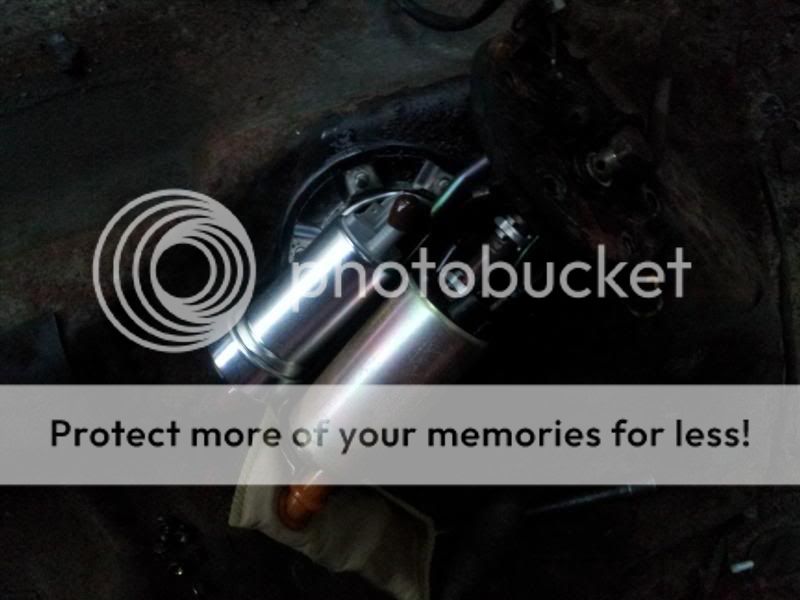

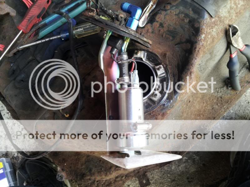

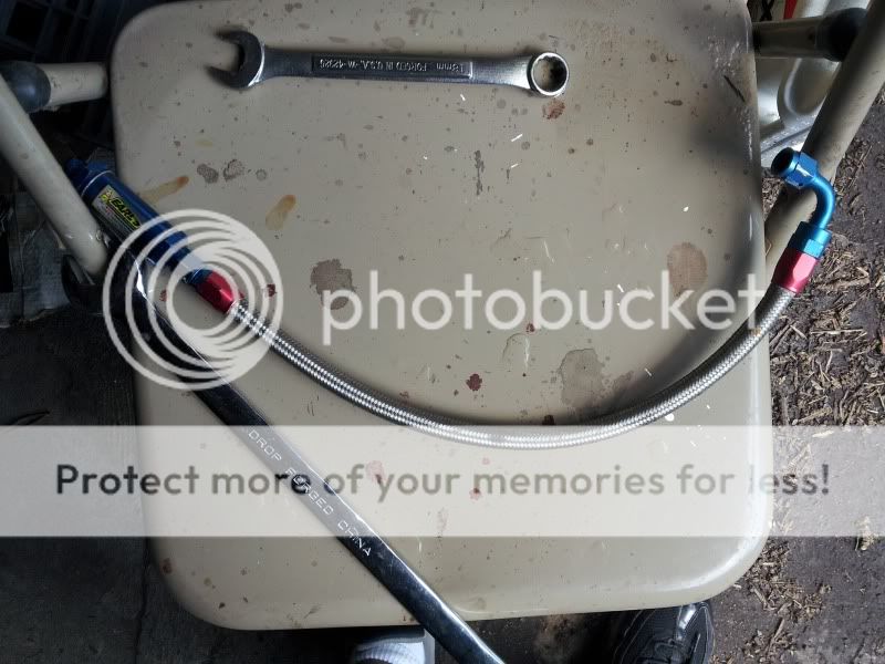

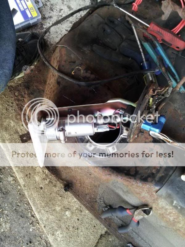

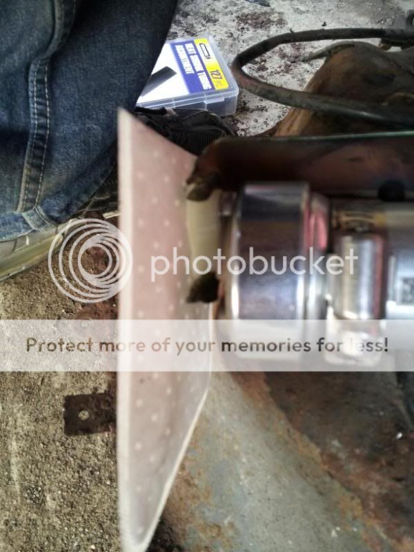

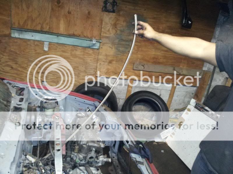

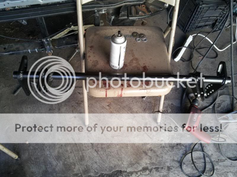

I been slacking on updating this build thread but no slacking on working on the car. Walbro 400 is in, its funny because the stock crx pump is bigger :noel:. Also converted the whole car to -6an. Enough talk, pic time!

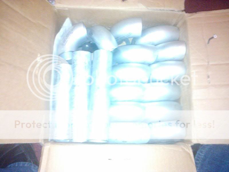

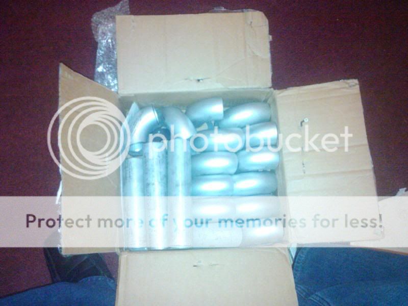

This is how much I had left from the 12' i bought.

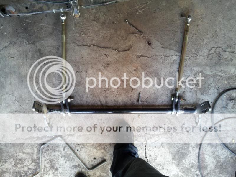

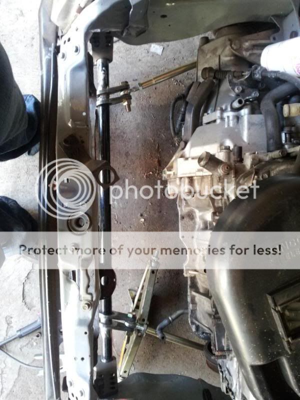

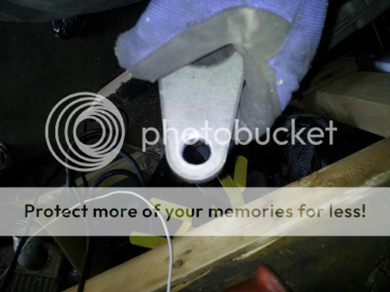

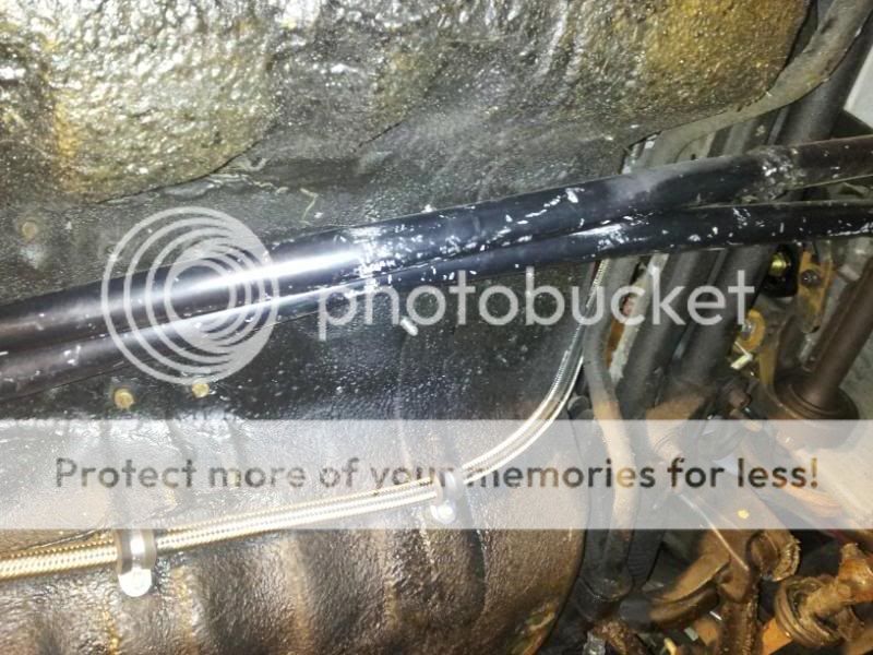

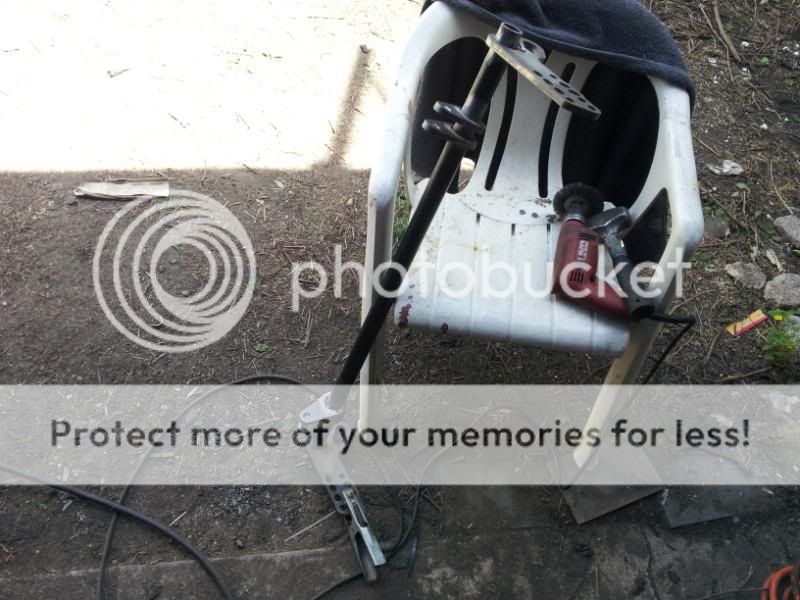

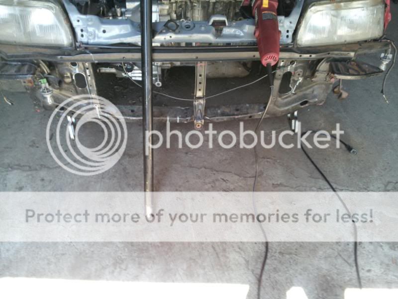

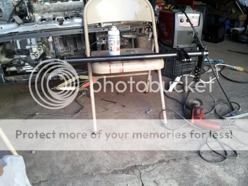

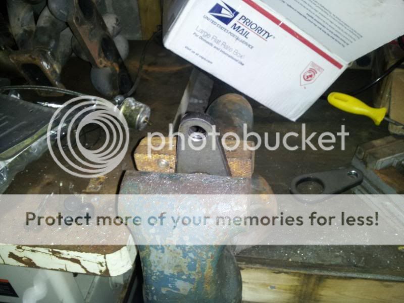

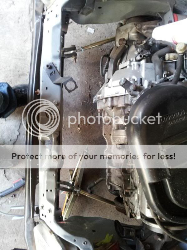

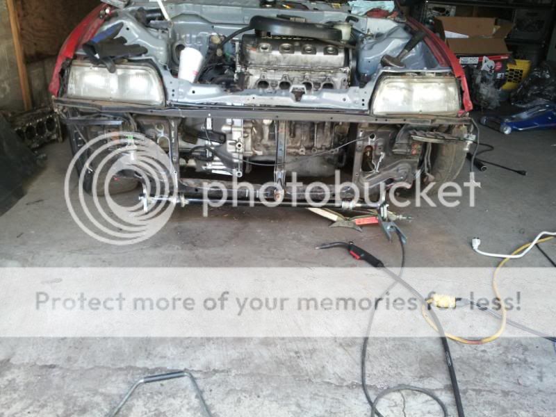

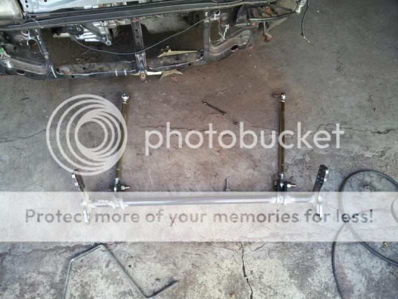

With the fuel setup the traction bar was up. Open the wholes up from 1/2" to 5/8"
5/8 Inch Chromoly Swedged Tubes and hiem joints
Long bar and brackets
Mock up
Fully welded
Little black paint
Forgot to added I rewired the pump to boost power to it with a relay. Hoping to get more done this weekend.
Re: Project Phoenix update 5/15/2012
« Reply #160 on: May 15, 2012, 07:11:44 PM »
Just a heads up. You cant use just the tow hook bolt holes for the traction bar. It will tear them right the fuck out. You will also need to weld on a bracket or something on each and to use at least 1 of the bolt holes that the factory crossmember uses.
« Reply #161 on: May 15, 2012, 11:00:52 PM »
that's all I have to do, but later on. I remember seeing you do that.

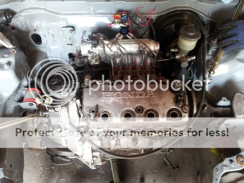

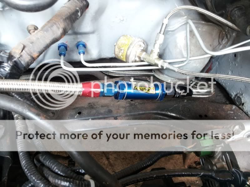

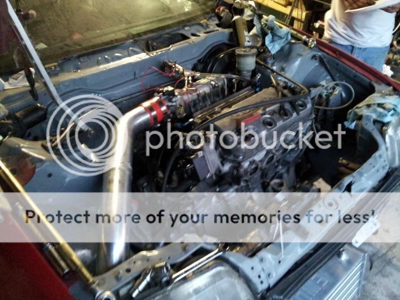

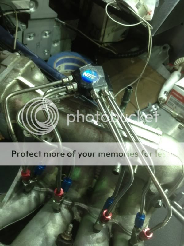

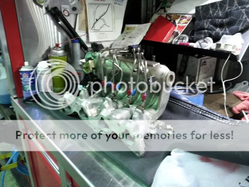

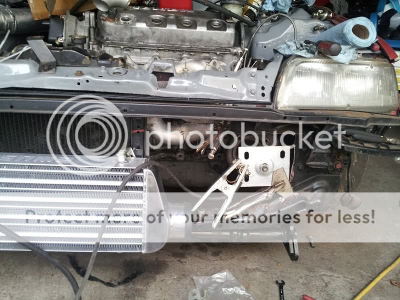

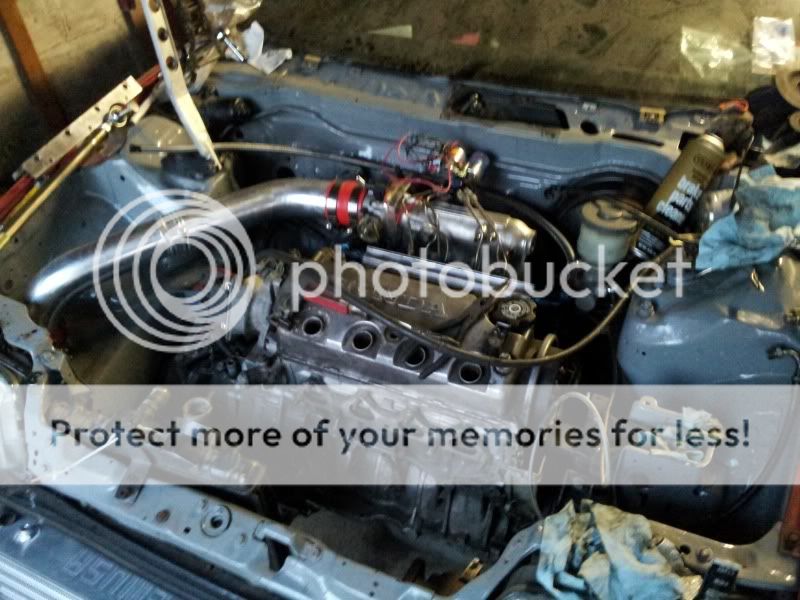

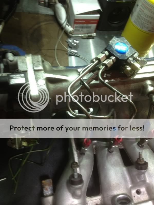

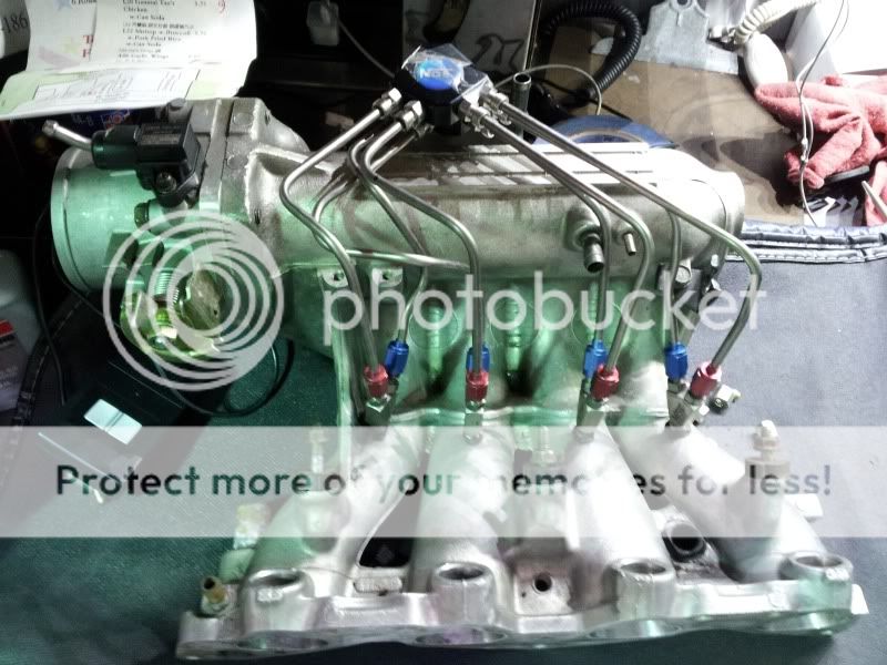

Putting in work, UPDATE TIME!

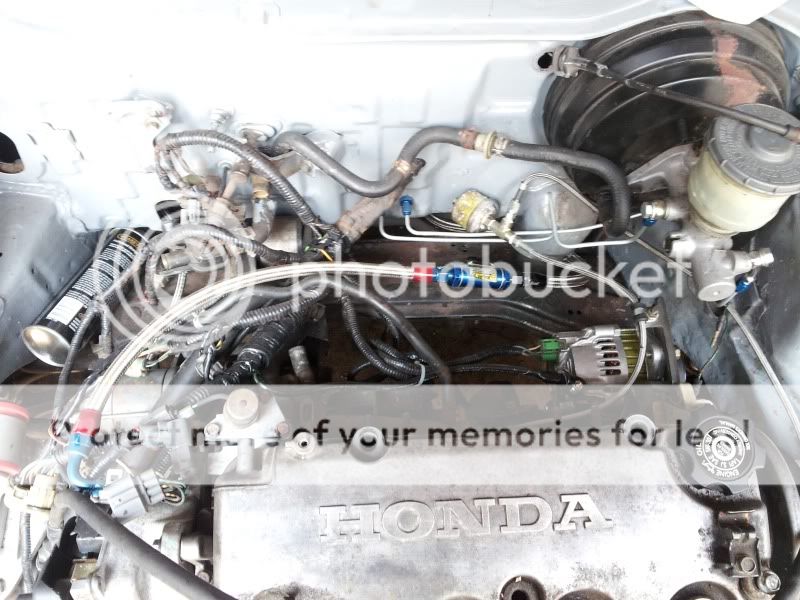

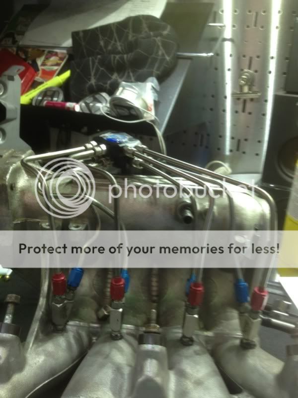

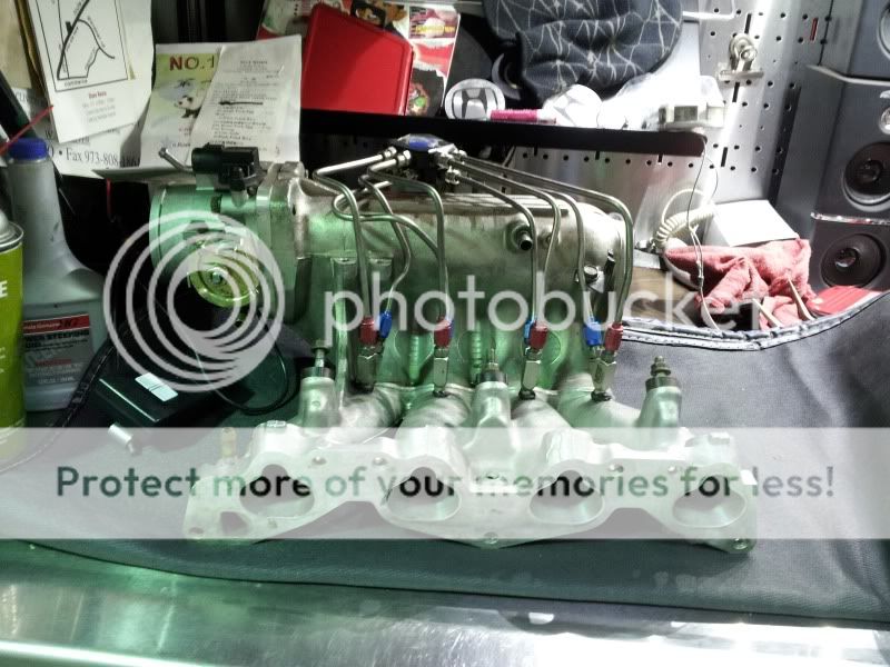

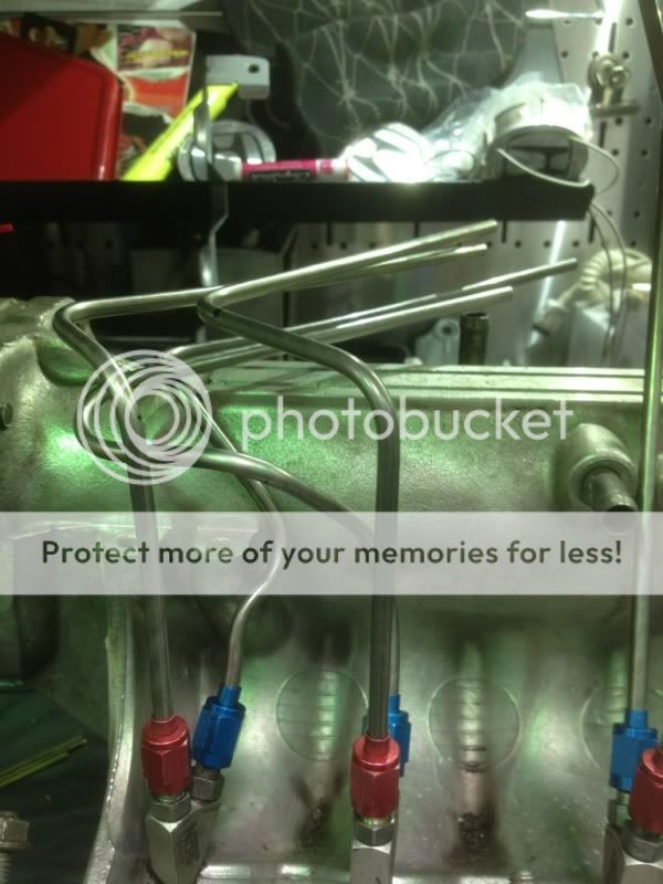

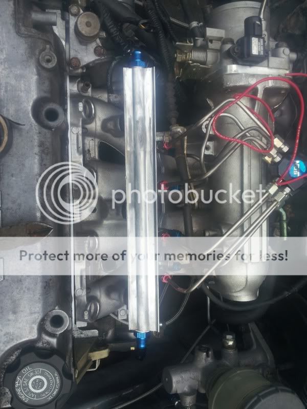

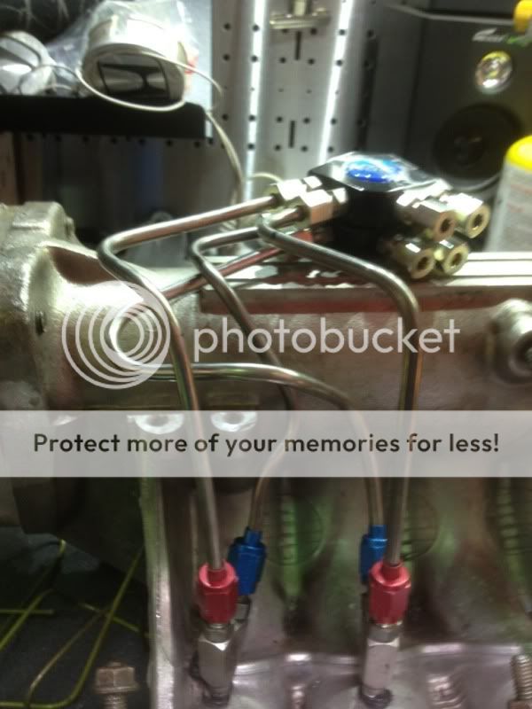

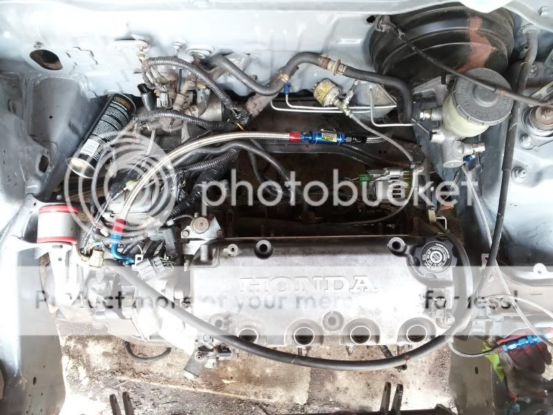

New filter and line

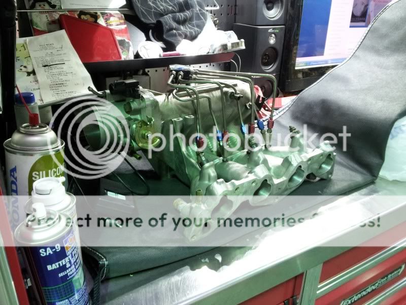

Oem rail coverted to -6 in and out
Cant leave it like this
Rhmt Fowee FTW

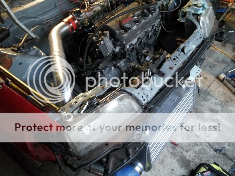

Charge piping done
Almost there!

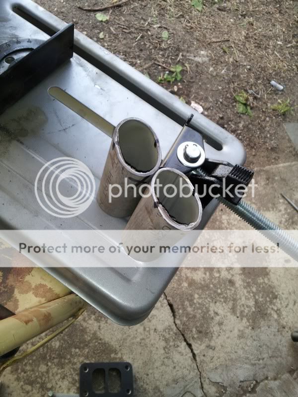

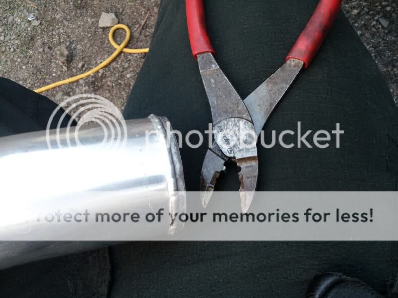

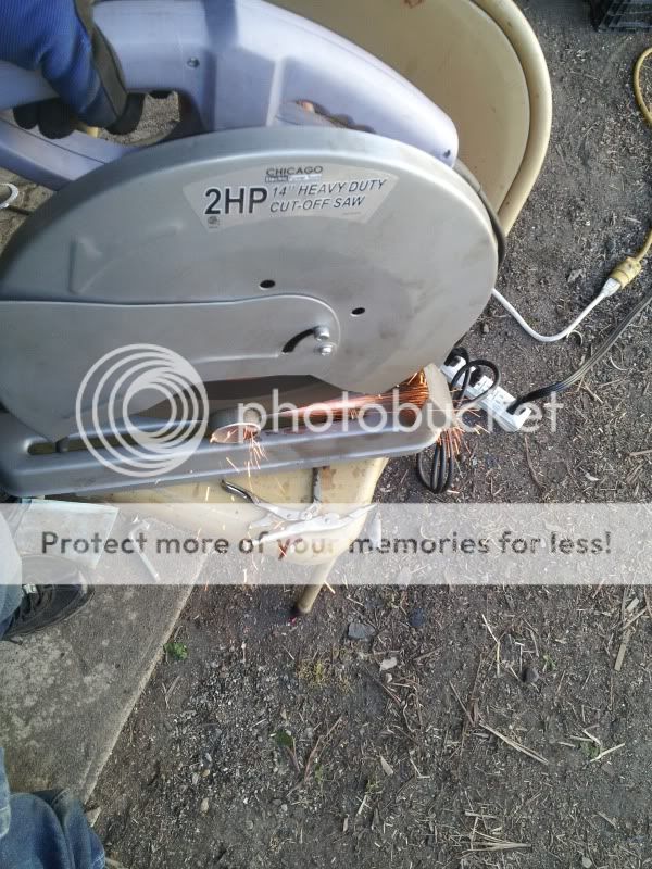

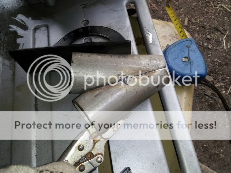

Time for some more work! Put in about 1 hour making this;
Thats it for now.

What size fittings u use for the fuel rail?
« Reply #177 on: June 01, 2012, 08:57:48 AM »
http://www.summitracing.com/parts/EAR-991945ERL
This was the fitting I used, it had the right thread pitch, on the other side of the rail I had to cut, drill, and tap for it.
