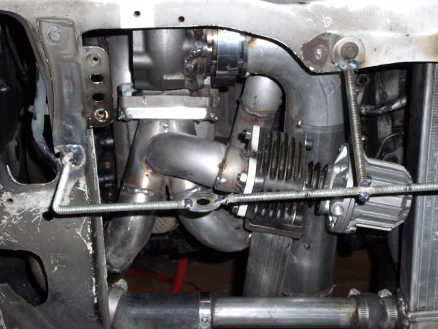

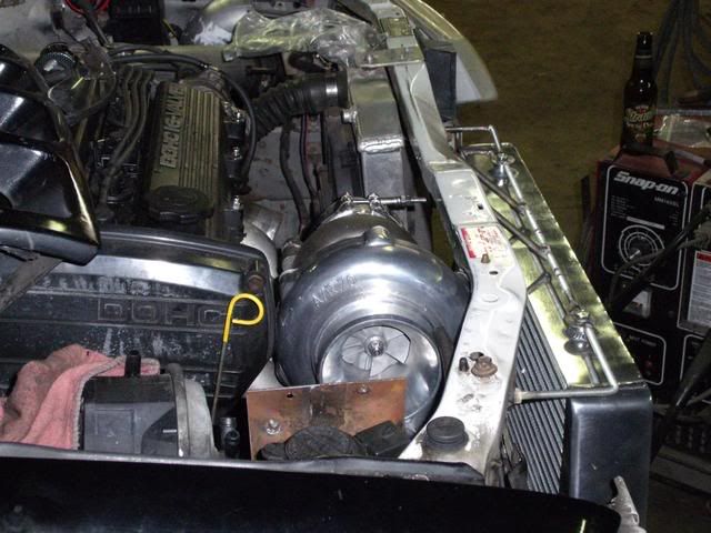

Turbo Setup
CDM 60-1 professionally balanced and rebuilt with good shat.(A Buddy who works at a turbo shop hooked me up)
Stainless top mount
3" downpipe
Already has 3" exhaust
Massive CDM intercooler.(Probably overkill but I only paid 50 bucks for it so whatever)
Free CDM 44mm wastegate.(HKS style)
2.5" charge piping
AN Feed and Return
Water meth injection
Engine and management
BP05
GTX Intake Manifold
GTX Cams
B6T Rods
Wiseco 9.1 pistons
550cc RX7 injectors
Megasquirt 2
AEM Wideband
The car
Old setup
Shitty Ripper Vid of old setup
What I got done so far

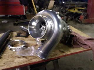

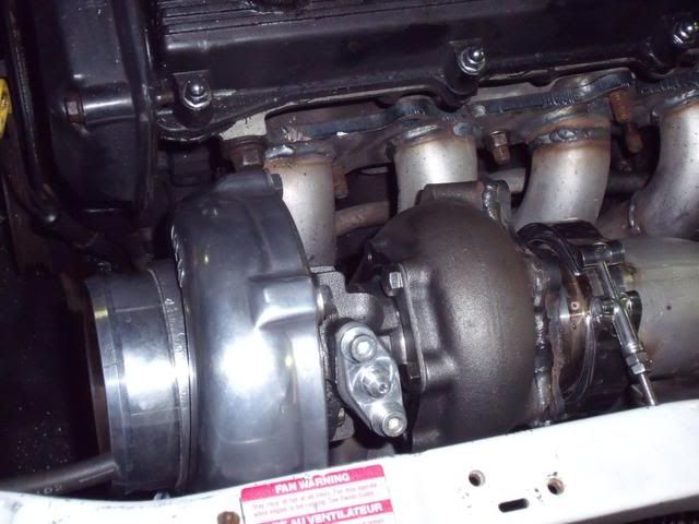

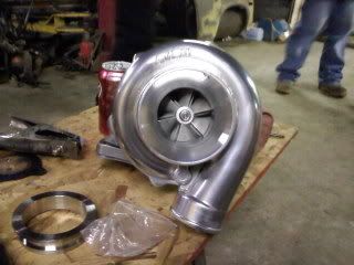

Bling Blinged the compressor housing

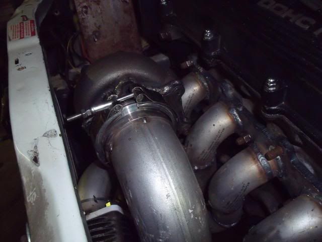

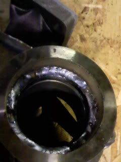

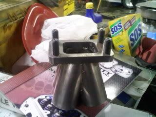

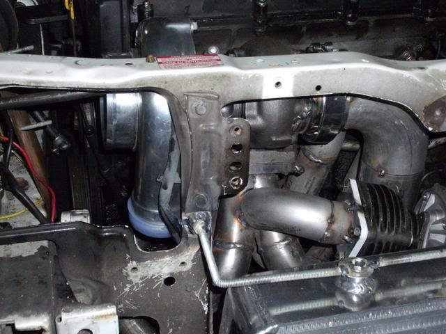

3" V-band Conversion
Put some bigger studs in the collector

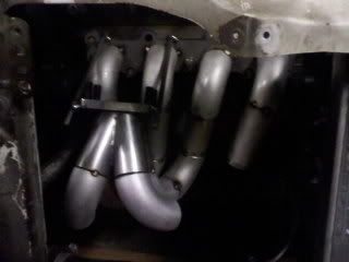

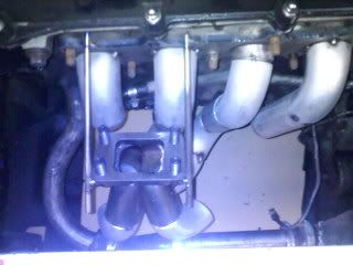

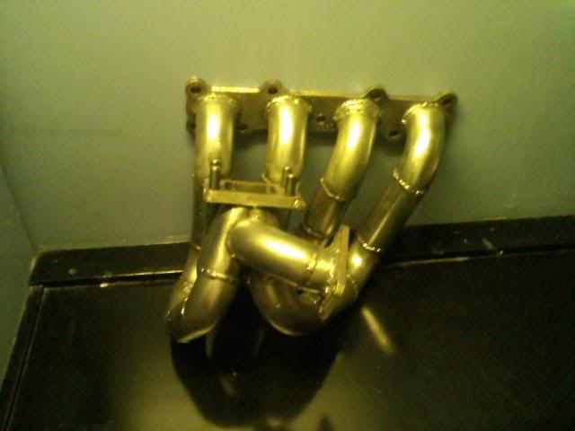

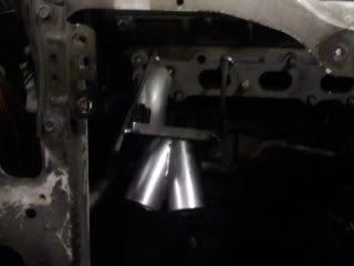

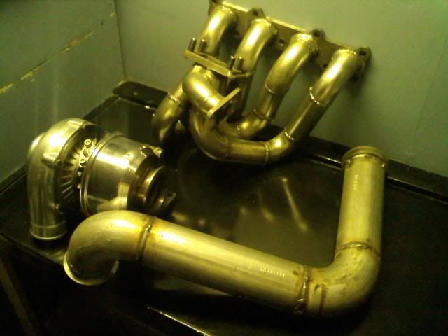

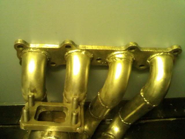

Stainless Migged Top mount
Here is some pics of the turbo shit all cleaned up.
Cooking pot heat shield ftw
Durafixed V-bands
Some of the other junk I have collected so far

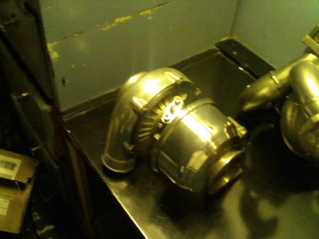

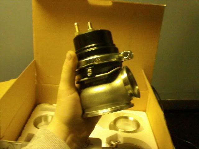

I decided not to use the CDM HKS wastegate. Leaks at the wastegate suck ass. V-band ftw
box O bends

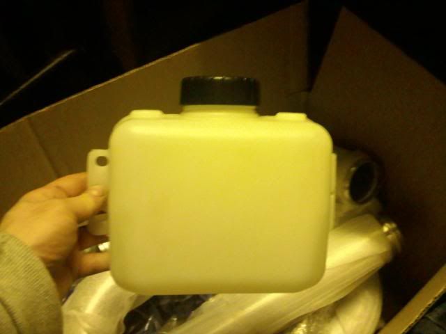

Tank for Water/Meth. Anybody thats lookin for a tank. These are solid as fuck and they are only 20 bucks on e-bay

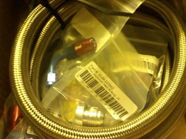

Misc fittings and oil lines

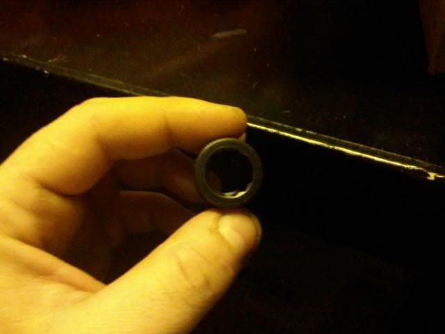

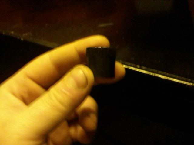

I thought these were pretty cool. 12pt hex head nut. To solve some of your clearance woes.

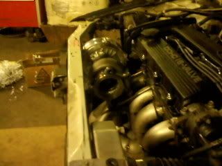

Hopefully my gasket kit is here tomorrow. If so, motor should be in by the weekend.

Love the top mount manny and heatsheild!

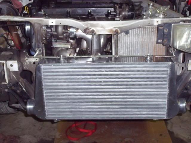

love the IC mount  ;D
but i will ask, why v bands on it?

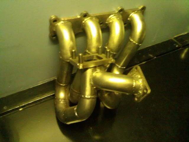

Migged mani, cooking pot heat shield and ic monts FTW!

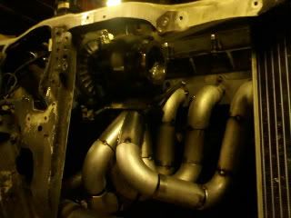

solid build man. Only concern with using vbands for everything is there's no room for anything to flex when the motor torques. So don't solid mount everything too hard cause something has to have some give.

One of the nicest migged mani's I've seen solid work, keep it up.  :noel:

is that a t-4 hotside or a t3? I can't really tell in the pic.

The header looks nice and everything but i would of used Tig when welding it but if you dont have a Tig welder i guess your stuck with Mig
