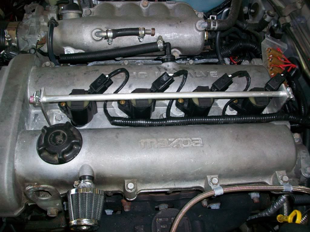

Built a thing to hold the COPs down. Before they were just sitting there, and would sometimes vibrate up and get loose.
