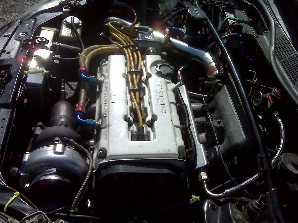

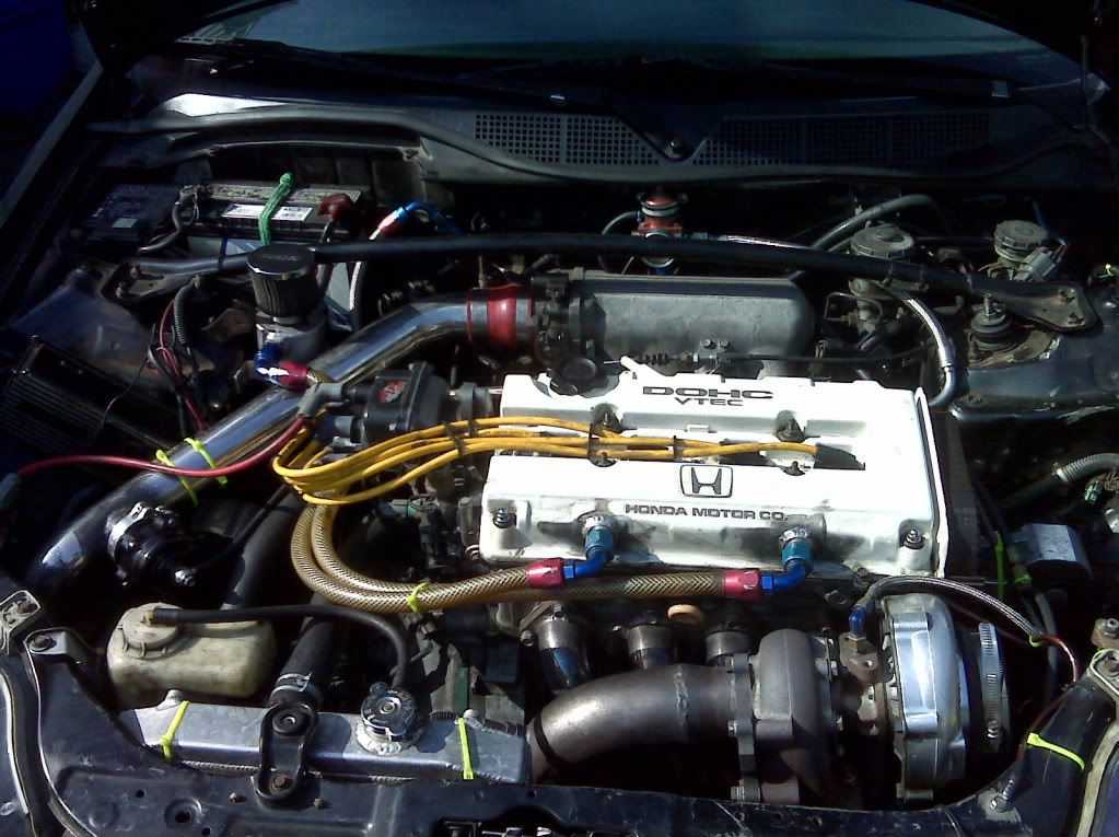

this is my boosted 2000 civic si this car has been turbo for bout three years now the first turbo set up was a ramhorn set up with a t3/to4e turbonetics got tired of that and decided to go with a top mount  this is my everyday car here is the set up
motor
stock rebuilt type r head
b16a 81.5mm decked
probe forged piston n probe h beam rods
micro polished and balanced crank
560cc evo injectors
aeromotive fpr
walbro fuel pump
-6 fuel lines
earls inline fuel filter
gsr cam
aem gears
aebs intake manifold
type r throttle body
moroso catch can set up
aem wideband
autometer oil n boost n volt
msd blah blah
b16 trans obx lsd
act hd pressure plate act 4 puck clutch
turbo set up
top mount turbo manifold
60-1 turbo a/r 70 intake a/r 63 exhaust rebuilt by blaast
synapse 50mm wastegate
tial 50mm bov
big ass egay intercooler 2.5 ic piping all round
3 inch exhaust from turbo all the way back
mbc
suspension
kyb agx struts
skunk 2 coilovers
19mm rear sway bar
black blox lower control arms

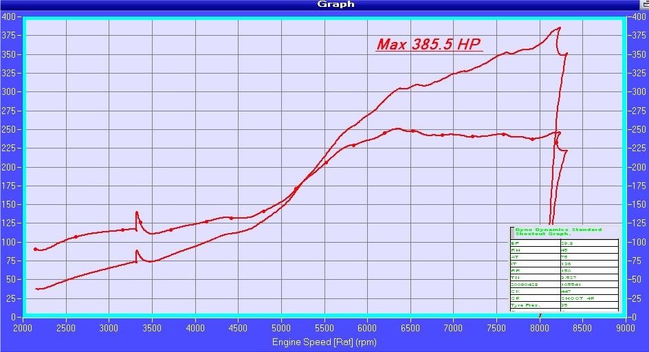

car made 385hp and 250 torque on 16psi on pump tuned by xenocron
i'll be hitting the dyno again in aug trying to crack 500hp  :noel:
was looking good until . . .

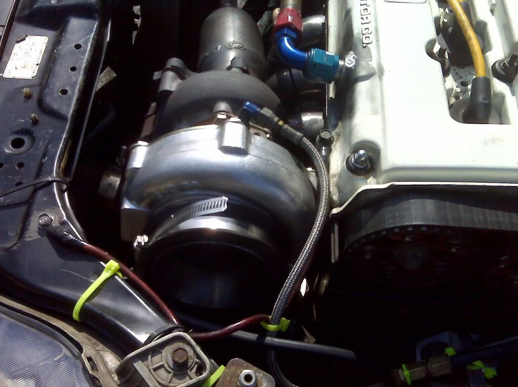

is that an obx top mount?
90 hatch
boosted 00 black si
  • Posts: 1560
Re: my boosted SI (B!6a)
« Reply #7 on: July 21, 2009, 08:32:03 PM »
no obx junk!!!!!!!!!!!!! i made it  :noel:

ive been thinking of making my own topmount for awhile. any more pics or info on it?
90 hatch
« Reply #11 on: July 23, 2009, 06:23:55 PM »
You made it or Jose? :noel:
boosted 00 black si
  • Posts: 1560
« Reply #12 on: July 23, 2009, 07:04:12 PM »
i mocked it all up n had my buddy weld it for me  :noel: jose didnt have a welder at the time  >:(

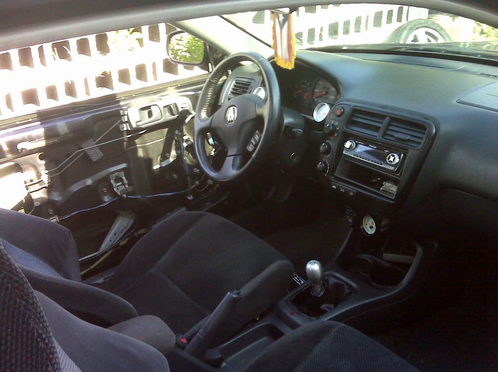

looks nice.. does that RSX steering wheel fit with no mods? looks awesome. I want one!
yup fits with no mods u just have rewire ur horn thats it
