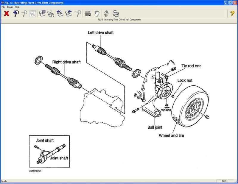

Here's a pic, maybe the gear lookin things on the hubs are holding you up? The axles are inserted into the trans the same way as into a honda, they should pry out. They also provide this tip: If driveshaft is frozen in front wheel hub, spray a penetrating solvent into splined area and then reinstall locknut so it is flush with end of shaft. Tap nut with a brass hammer to remove driveshaft.

Finally solved my problem. I said fuck it and yanked on them. Took about 3 good yanks on each side and they came out.
Still can't take them out of the hub. I tried hammering them out and no luck. I looked for that gear looking thing, but I didn't find anything. OH well, at least now they're out.
and the weirdest fucking thing, the "joint shaft", aka mid shaft, is male. So that means the fucking passenger side axle is a female end. It's fucking weird, I thought I had broken it when I pulled it out(where's the dee dee dee smiley when you need it?)
