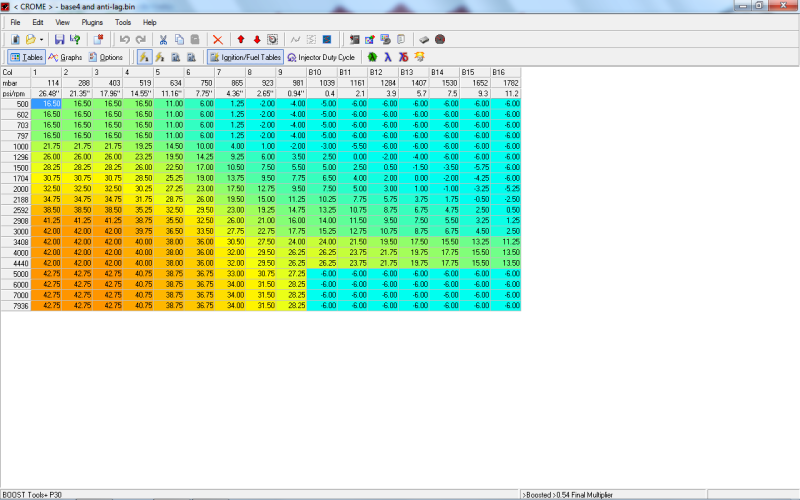

well seeing as how the two step only builds 1-2psi and just sounds gay off the line, so did some digging over in pgmfi.org
this will only work with a p30 base
hit control K and enter the fallowing script
_rom_fill(0x58e6, 0x590d, 0x00); _rom_fill(0x6a99, 0x6ac0, 0x00);
this allows ignition timing to go to negative numbers,
also make sure vtec speed check is NOT disabled
now the slightly confusing part,
set where you want antilag in the add extra features menu
go to your low cam ignition timing and above that RPM retard ignition until it reads -6 from 0" all the way to the maximum PSI the ecu is reading
now go to your low cam fuel tables and select the same area of the map as the low ignition tables, hit CTRL + J and adjust fuel by +10-15% (play with it until you hear pop pop pop :bigok:
all you have to do is make sure your launch control is set above your vtec activation point,
EXPLANATION
when you are standing still, the car will run off ONLY the low cam map since vtec speed check is working, so it will retard timing and add fuel off the line creating a true anti-lag. however once moving the ECU will allow vtec to be activated, so you will never hit that area of the map while moving because vtec will activate and switch over to the high cam
video and amount of boost built will be posted tomorrow
all credit to boosted k20 over on Redirection
if you  O0 already know sorry to repost but im sure it will help someone

I have been doing this for a couple years now, it does build some boost, but it is NOT true antilag. It will also work with a P72 base, I put both scripts you need (for either or) in the BIN directory that was posted up here at rhmt. Edit: link added http://www.realhomemadeturbo.com/forum/index.php?topic=3485.0
If you have heard true antilag you will know that this is not that.
One more thing 15% is pretty rich and it typically takes longer to spool at that level. I find 5%-10% depending on the motor turbo setup. You have to play with it some to get it to spool up quick and hit hard.
The most I have seen is 15-16psi but that was what the waste gate spring was set for, it may have made more with a stiffer spring, hard to say.
i knew some  :mexi: in here already figured it out, but figured why not post it. good tip on the fuel amt too, ill play with it some to dial it in
here is a vid of it at 5600rpm, you were right takes its time to spool up
