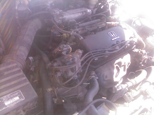

so my friend acquire a civic from another friend. it has a swapped engine from what im told. its a 93, has a z6 and a p28.
http://smg.photobucket.com/albums/v396/shadow_seo/?action=view&current=0721091443.flv
i know nothing about the car other than that.

ok well instead of starting a new thread i searched (shocker i know) im having the same issue, finished a swap after i bought a car with a blown motor, is running ok minus the idel surging between 1000-2000 when warmed up. I took off the IACV/FITV and cleaned it out with just water but didnt help.
coolant seems to be bleed off well no bubbles ect
any more ideas?

so reset the ecu and try again?
took off FITV on bottom on TB, the autos dont have an IACV that i can find not in the usual spot on the back of the intake manifold
cleaned it with purple power, gunk came out, put it back on still surging when warm :-P
when i plug up the FITV with my thumb it idles just fine so no vac leaks ect

No, start at the beginning of the thread and ignore everybody except for me.
You have a vacuum leak causing the engine to surge upwards.  The ECU has a super low fuel cut revlimit, when warm, when it sees the throttle is closed which causes the idle to fall back down.  Rinse and repeat.
Now, you need to fix your vacuum leak.  No troubleshooting required as it's 95% likely your FIT-V.  Unbolt it from the bottom of your throttlebody, mind the coolant line, take the flat metal plate off the backside of it, and rescrew the valve seat deeper into the body until it has a nice amount of interference against the plunger.  The plunger retracts itself when cold, causing the classic cold Honda high idle, so the further you screw it inward the lower your cold idle will be and the sooner (temperature wise) your high idle will end.  Reinstall.

comrade Yoseph i require more hand holding, if you could spare a few minutes it would me much appreciated .
so i took off the little plate on the side of the FITV off and turned the metal plate as far as it could go clock wise and re-tightened the screws.
when i took off the metal plate there was a little green plunger or w/e i tried to turn it but couldnt, when reasempling i used a bit of RTV silicone on the metal plate to make sure it can seal, any other ides?
or am I retarded and the thing i was supposed to tighten is behind the green plunger

« Reply #19 on: August 26, 2009, 03:30:58 PM »
Well, fuck.  You're OBD2, no FIT-V.
Look for vacuum leak.

it must be leaking around the FITV whenever i plug the hole with the finger on the valve it idles like a champ, i think im just gonna hit the bottom of if with some RTV sealant and pray a little
