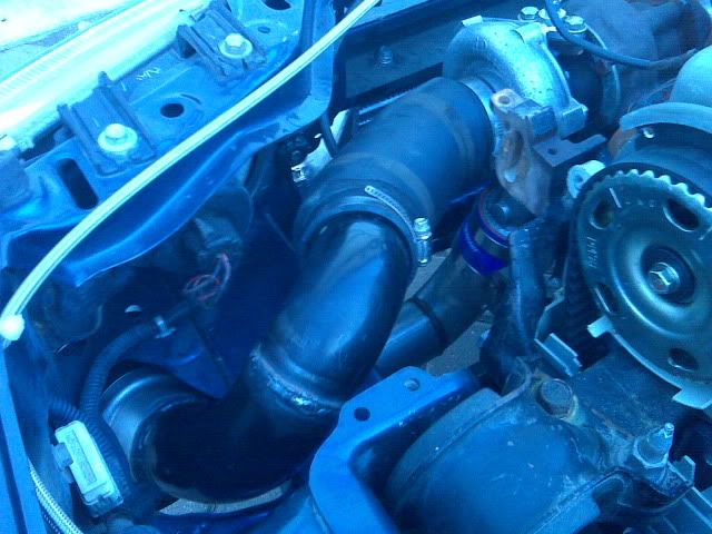

So anyways i put a timing light on my civic (D16A6) the other day and with the evil hondata in set timing mode i could only get the arrows on my timing cover to line up with the single far mark, should it be on any of the 3 lines in the group? I havent driven the car like this yet, but turned it over by hand and ran it with the light. Did i put the belt on a tooth out or something? Thanks guys

Oh balls, its on the outside line when running and warm. I should pobably stop being lazy and check my marks are lined up

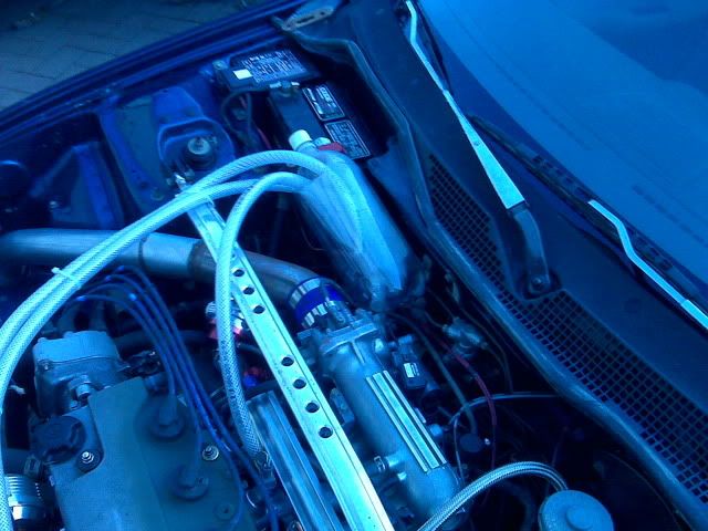

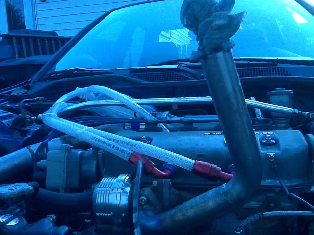

I took it for a bag today and its pig rich, wee! Hooray for catch bottle  :mexi: also up turned wastegate dump  :evil:
I can now enjoy taking off bumper for clean air filter  ;)
