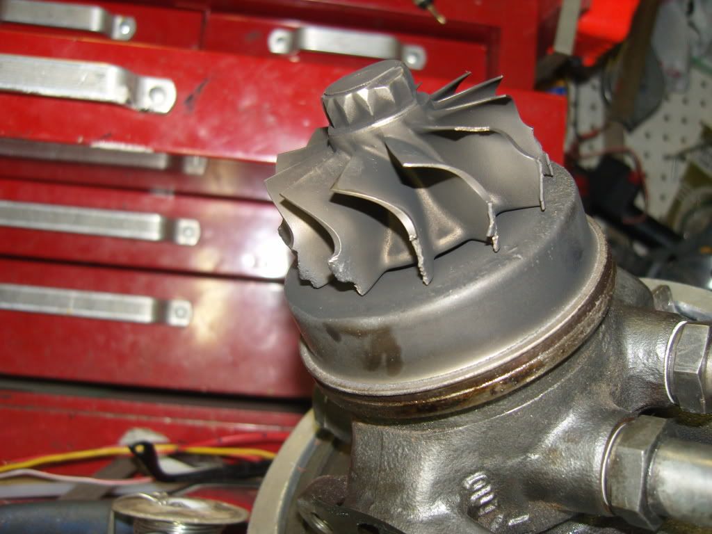

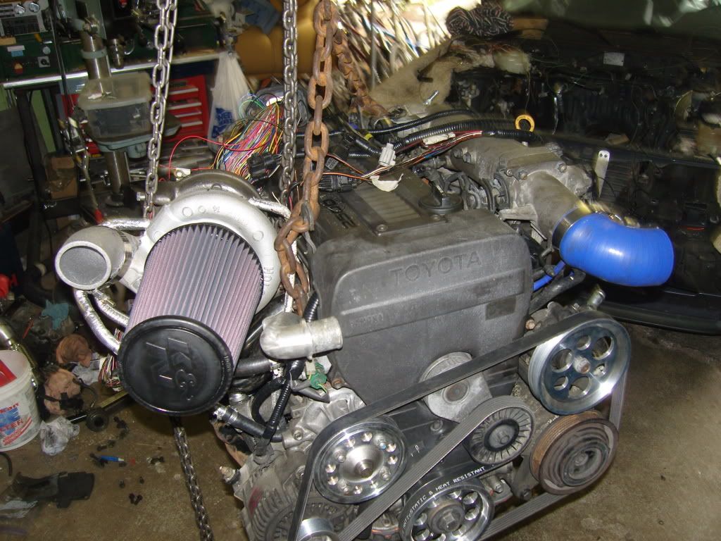

I've got an '85 Toyota Cressida with a 1JZgte and Holset HX35G. After just getting it on the road yesterday and taking a couple good runs the turbo shit itself.
I'm looking for a new CHRA and just not sure what will fit the housings I've got.  I've got a 14cm2 divided hotside and the one thing I'm actually worried about is keeping my compressor housing since I had to cut the outlet off and have an elbow welded on.

I don't want a different turbo, just a CHRA (Center Housing Rotating Assembly). I'm pretty much out of money and my setup is all done other than a bad center section.  I just want to know if any old  HX35 series CHRA will work or if I need to find another HX35G (7 blade compressor wheel 14cm2 divided exhaust housing)

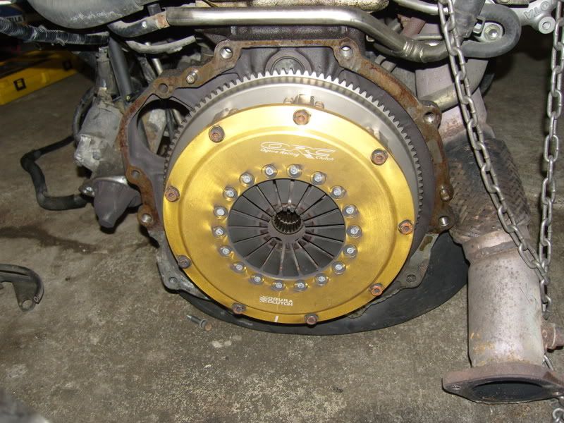

A nice surprise that came with my motor.  ORC twin plate clutch setup worth around 3600US new

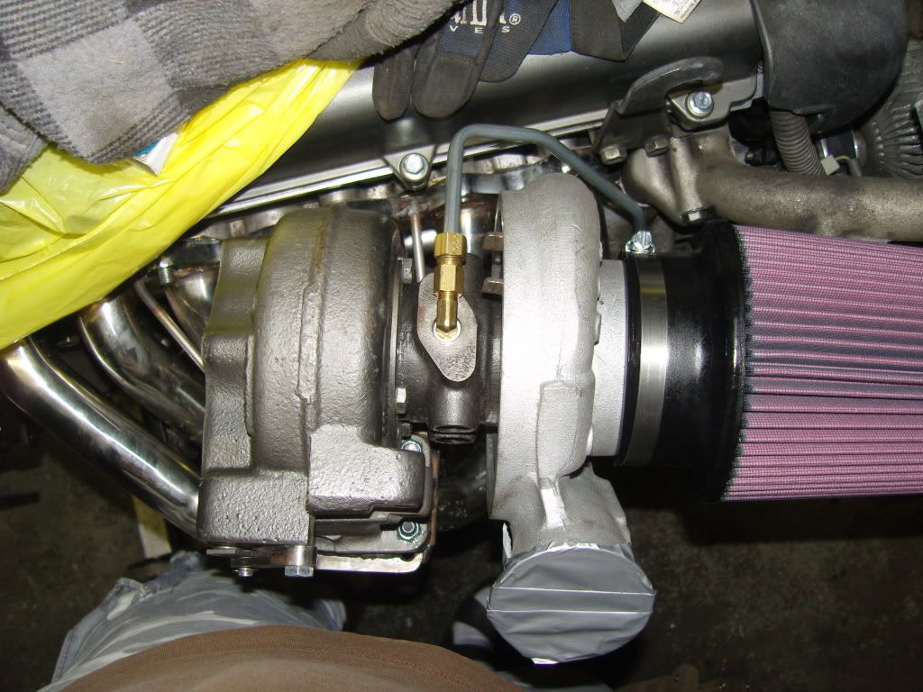

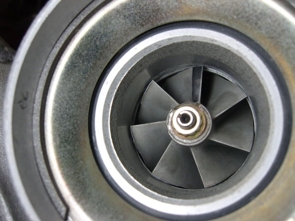

Holset HX35G

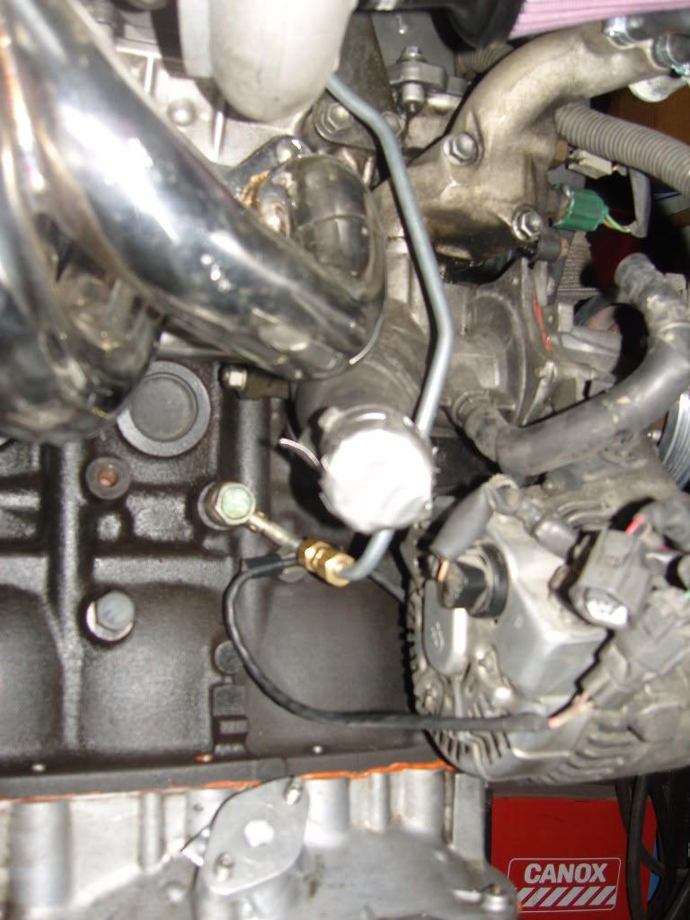

oil feed hardline, drain not finished yet (now with restrictor removed because it fucked me and blew up my turbo)

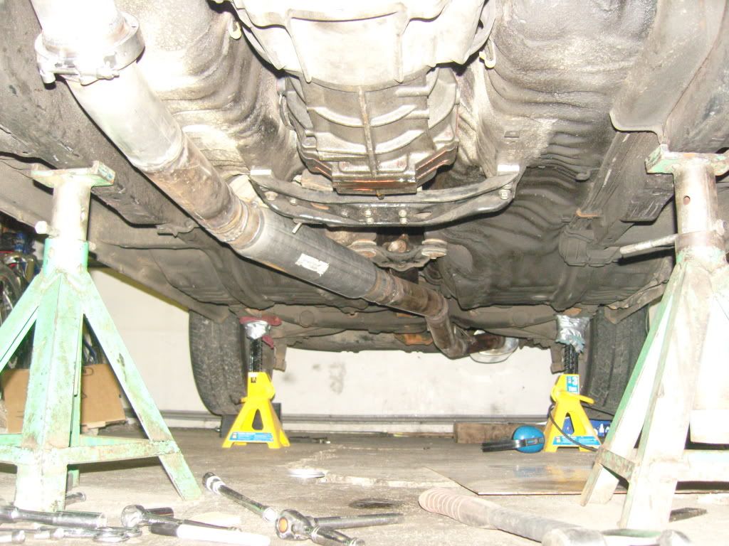

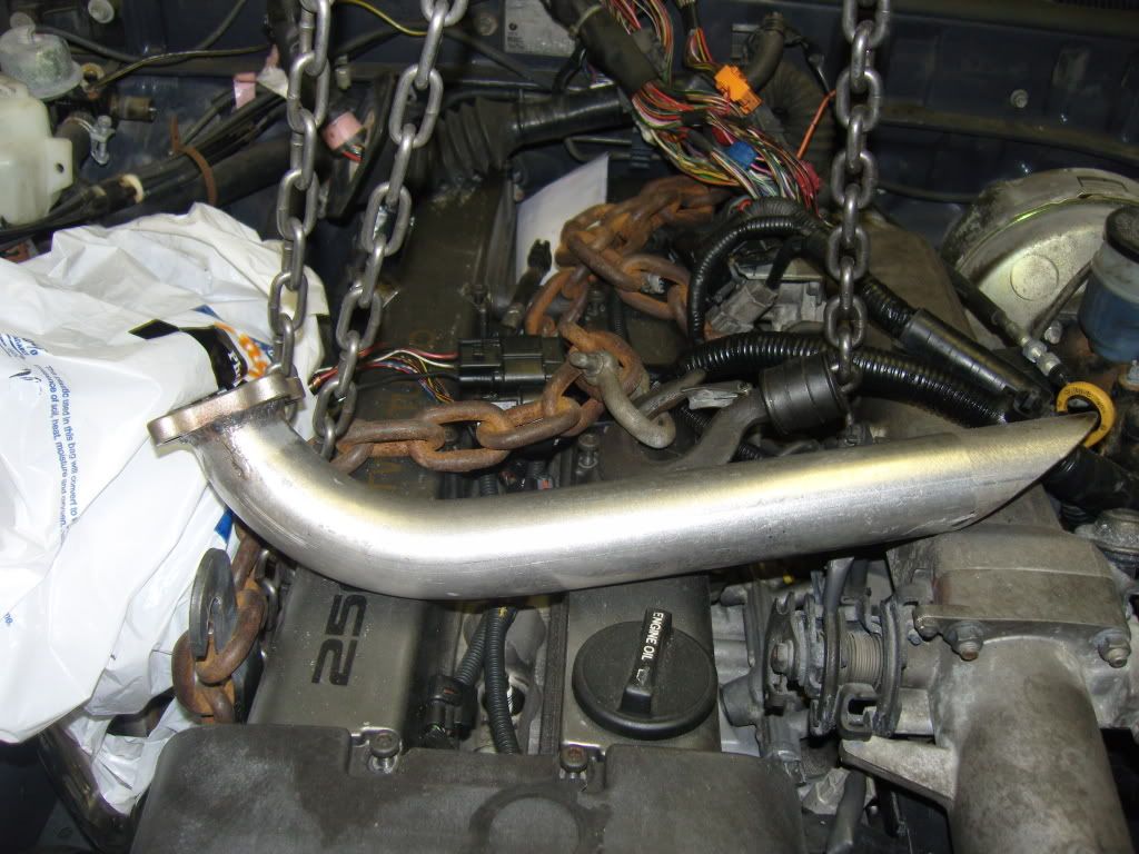

Beginning steps of downpipe
Finished downpipe all wrapped up.

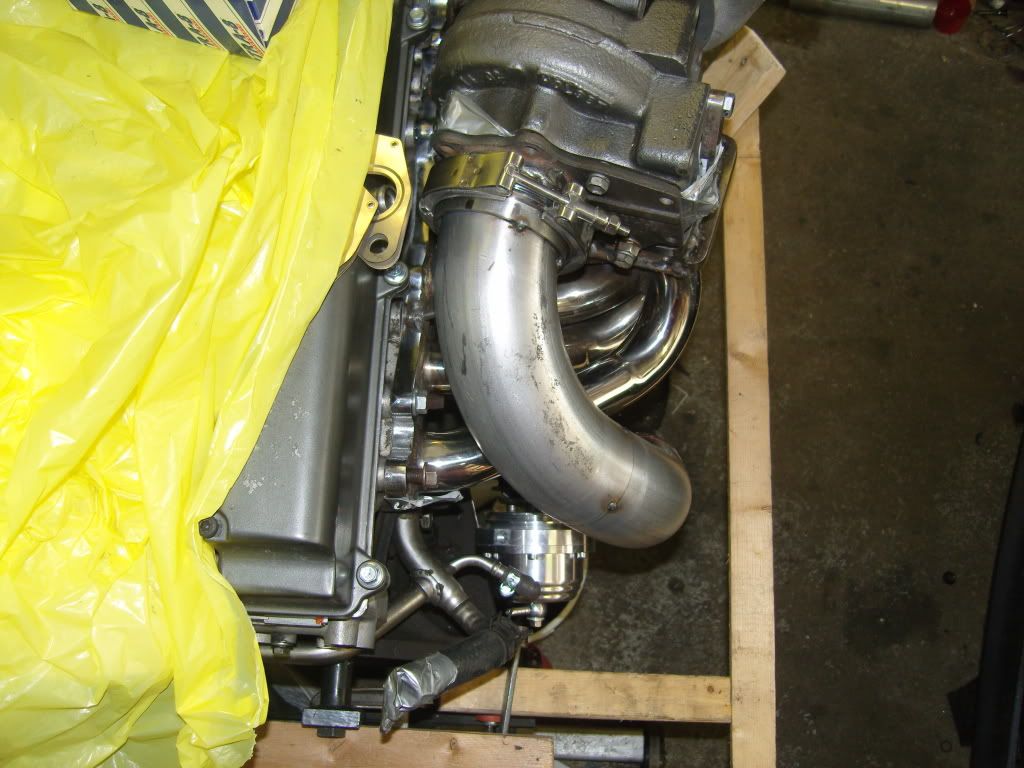

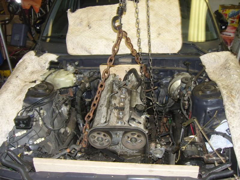

Just before installing the engine

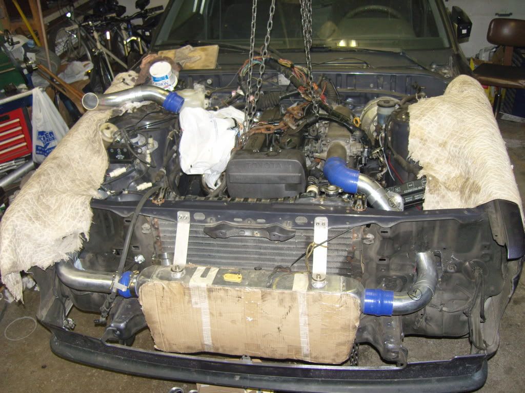

Fitting up IC piping for welding

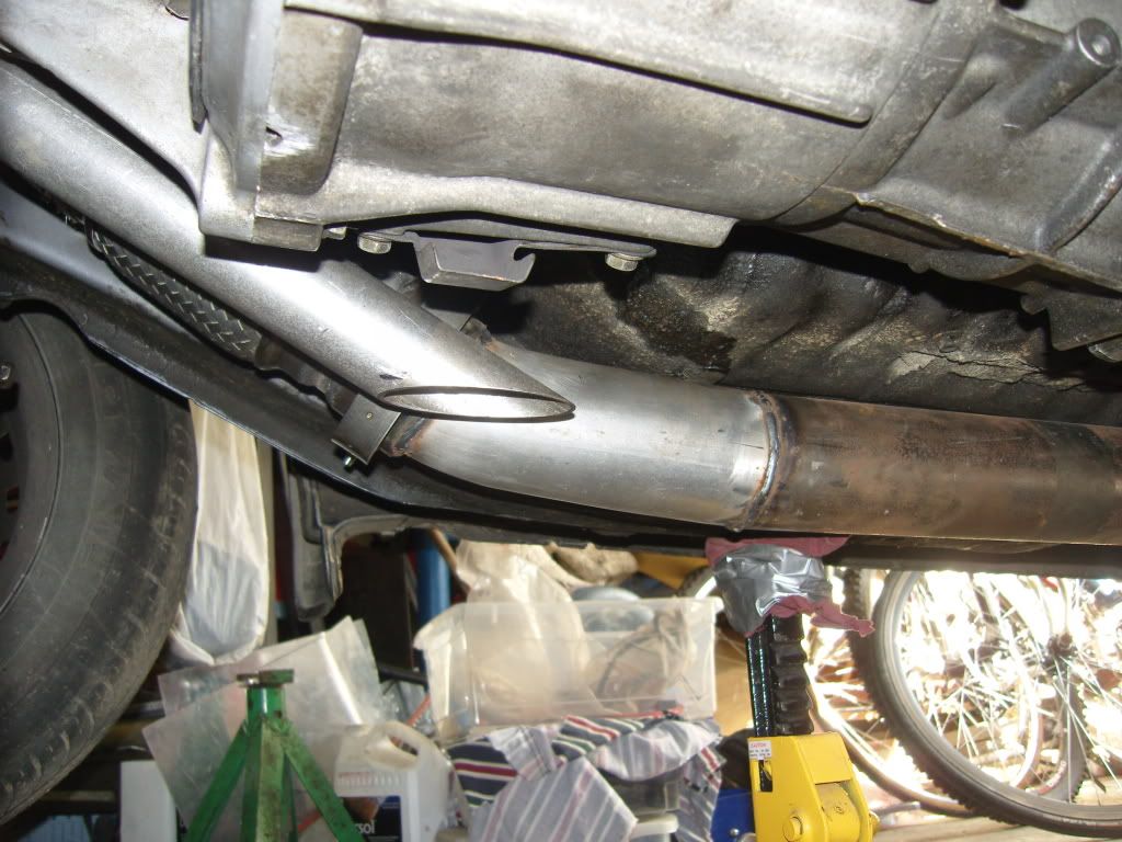

3" exhaust
screamer pipe
screamer installed

Any of the HX-35 or HX-40 Chra's with the snap ring compressor side and bolt on hotside (about 95%) of them will work. I think some H1E's and WH1C's as well iirc.

All of the hx-35/40's to my knowledge ran a 60mm exhaust wheel. So you SHOULD be fine there. The HX-40 ran a 60mm compressor wheel, so you would need that compressor cover in order for it to work.

As long as you don't use the 60mm compressor wheel, you can use everything else.

  From what I've learned it looks like it was some kind of foreign object that took out the turbine wheel, I'm assuming a chunk of welding slag from my POS ching chong manifold.
