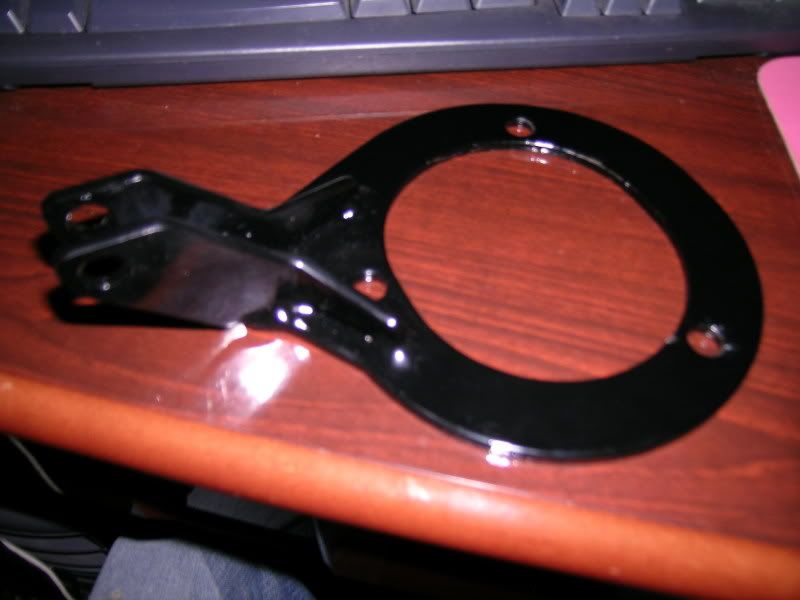

So I started powdercoating a little bit ago
Heres some pics of my setup
Picked the oven up off craigslist for $60 works like a champ and a harbor freight powder coating gun for $70 works great so far. Theres some pics of the stuff I did for a friend came out pretty nice. Still learning and perfecting it though. Hopefully gonna get a sand blasting cabinet this weekend we'll see though.

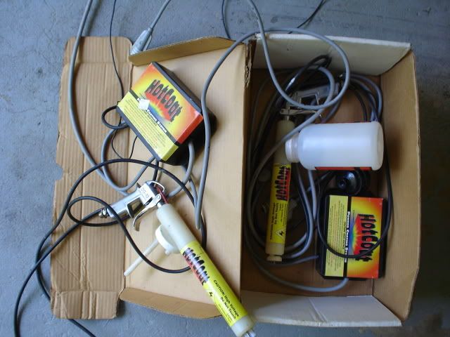

I worked as a powdercoater when I was in high school.  The only advice I can give is spray the powder in the air to build up the charge before going right on the workpiece and just make sure you bake the part long enough.  If you don't get the heat in the part, its not going to last.  Also thicker parts you want to pre-heat and make sure the parts are really clean.  Its very easy to get a good finish becuase you can check your work before you bake it.  If you can still see metal, its too light and if there's buildup then blow it off and re-spray it or it'll look like orange peel.
The biggest pain in the ass part is finding an oven.  I actually have two powdercoating kits that I've never used:
TheMadScientist
