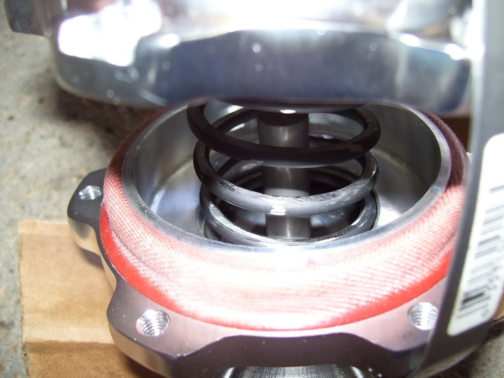

So time to make your spring softer. How? I ground on the coils. This effectively reduces the diameter of the coils, which makes the spring softer. Did this with a right angle grinder. It's easy, just hold the spring and grind a little flat on the spring. Do a spot, then turn it a 1/4 turn and do that spot, wash, rinse, repeat. I had to wet the spring a few times as it gets too hot to hold.

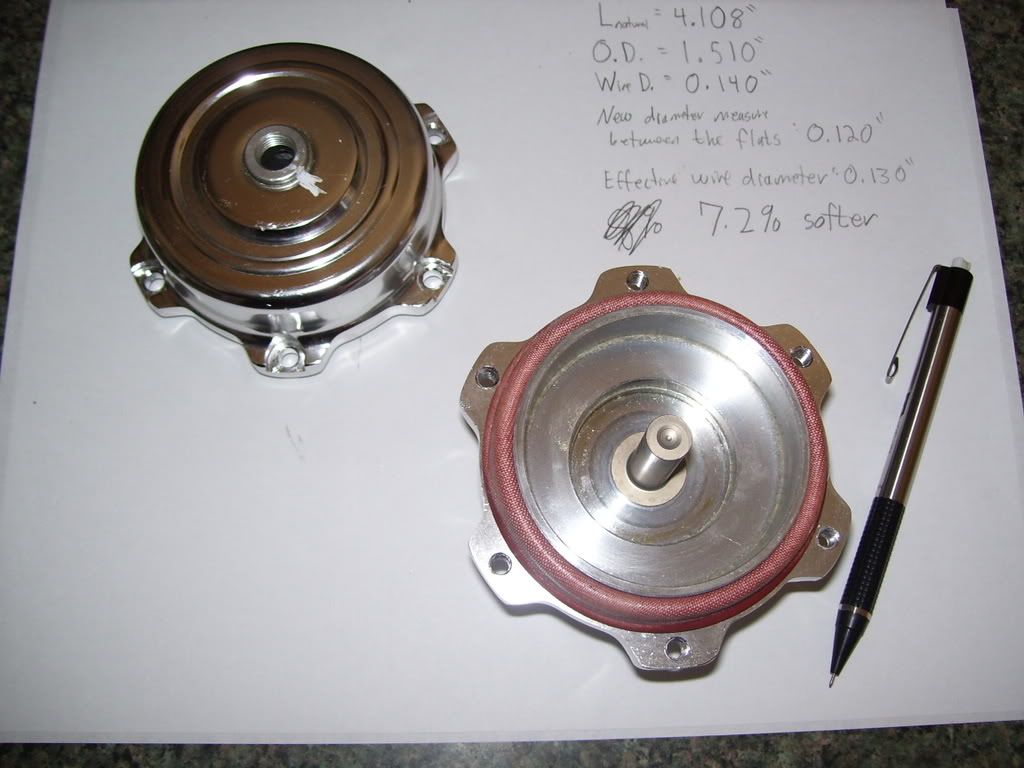

So how much do you grind off? Here's how I did it. I measured the OD of the wire to be 0.140". Well, I ground a bit on both sides of the coil. Measured the diameter between the flats in several places and the average was 0.120". However, that's only on two sides of the wire. I would say the effective diameter is 0.130" (because it measures .120 between the flat sides, and .140 between the round sides). So that would make for a (130/140) = 7.2% softer spring. Or if my original k was 42, my new k would be 39. That's lower than k_ideal though. And sure enough, damn valve leaks at idle now. At least the math agrees with my real world results. :l Should have only ground one side of the spring apparently. Actually, doing the math I should have only removed .012", not .020". However it barely leaks and I should be able to shim it to stop leaking so no worries. But had I done this math before, I would have got it right or closer the first time.

Pictures for you visual folks:
I didn't have a vise, so I found a big hose clamp and some cardboard...
Measured the spring
Ground on that bitch

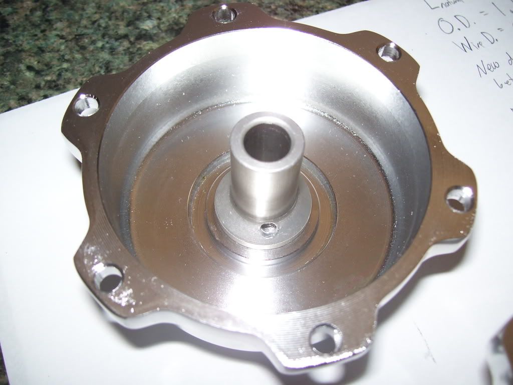

Pics of the BOV apart
Back together
Marked the relation of the bolt to the banjo fitting. Blowing through it you can tell having it alligned it flows better.
Got it installed and it's a lot better. Blows off when I shift now! Granted it's leaking a bit at idle from me grinding a bit too much off of the spring though. But I should be able to shim it and get it to stop leaking. Hope this helps someone.
