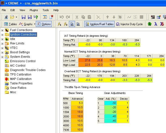

for comparison, here are the basic settings in the Crome Gold bins
[/quote
So between 98*F and 134*F it retards between 0 and 3*. I should probably set mine up that way.
no, it starts pulling 3* when the IATs hit 134. so from 134-159 its pulling 3*
Im no tuner, but are you sure about that? I thought it would start pulling timing at 99* and at 134* it had pulled -3
Am I wrong on that? If so Im sure I have some hidden power in mine....lol
i guess i could be wrong as well, i just ASSumed that Crome wasnt smart enough to infer that it needed to start pulling after 99 and max out at 3* when it hit 134.
maybe JD will chime in and enlighten us
Yeah, MS does it the way I mentioned. It just interpolates between values to get the number. Maybe this weekend I'll build some det. cans and try messing with the timing a bit.

as you get closer to the next IAT table, the ecu will interpolate the fuel/ignition correction.
say you are in a 100 degree table which has 0 timing advance and the next column is 150 with -3 timing advance.  at 125* it should be pulling around 1.5.  My numbers may be wrong, but thats it in a nutshell.
