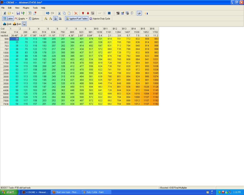

Need some help, got my turbo kit done last night. Started up just fine, ran just fine, no check engine lights, ripped on it for a hour or so. Then just cruising down the interstate it loads up, throws a check engine light on and wants to die. Only way to keep it running is in boost or ripping on it. It runs very rich once this happens. And now every time i start my car it runs great for about 30 seconds, throws the light and loads up. I read on H-T that if your ECT temp values are incorrect that it will run rich when warm, but i didn't touch that at all so im not sure if that would be the problem?
Better to have too much ECU/Chip information than not enough, wanna get this taken care of so if there is some info you need...let me know.

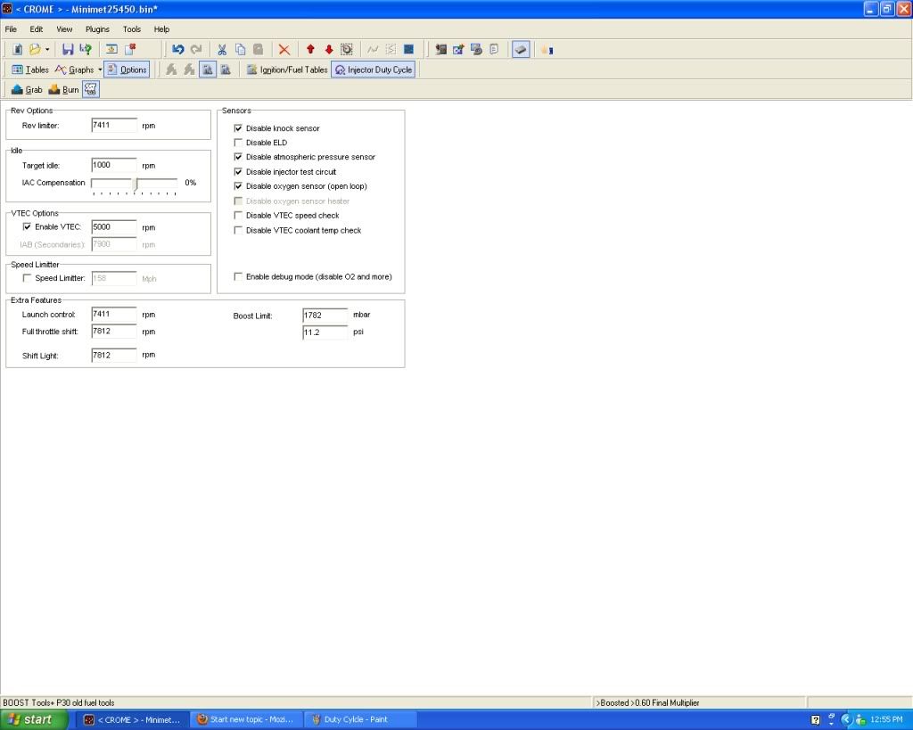

ps. Throwing code 41 (Primary oxygen sensor heater) But i had that disabled before..

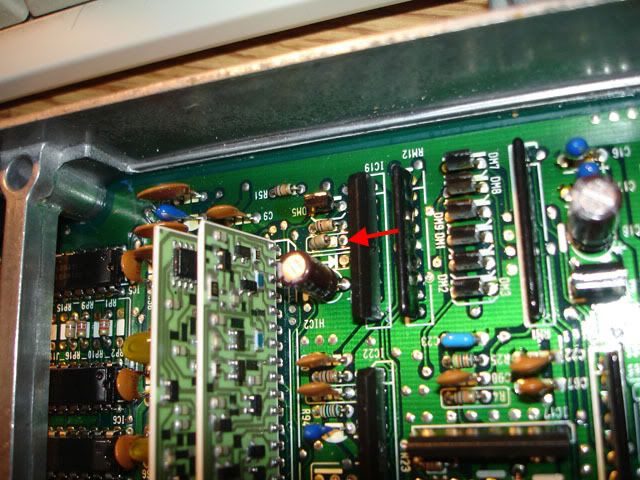

Pull your ecu out. Check the back of it to see if any solder has come loose and is touching two pins together. (has happened to me before)Then clean the whole board. I understand that it was great then all of a sudden it went to shit. Im just trying to help you narrow it down. So were you yousing a rtp to tune or the good old burn, read, write, burn.  Have you tried a differant tune to see if it dose the same thing?

btw when i chipped my ECU i did NOT cut this resistor...should i have?
Re: Help!!!! Car loads up when warm
« Reply #19 on: September 02, 2009, 09:58:22 PM »
Removing j12 is for full duplex mode.... Since your using crome I would remove it... Also make sure the connections are solid... a tiny connection can fuck shit up

Reflow all of your solder joints and clean it up. Look at both sides especially the ground pins- they can dissipate a lot of heat and leave a shit solder joint.
If it worked great for a while it should be an easy fix
