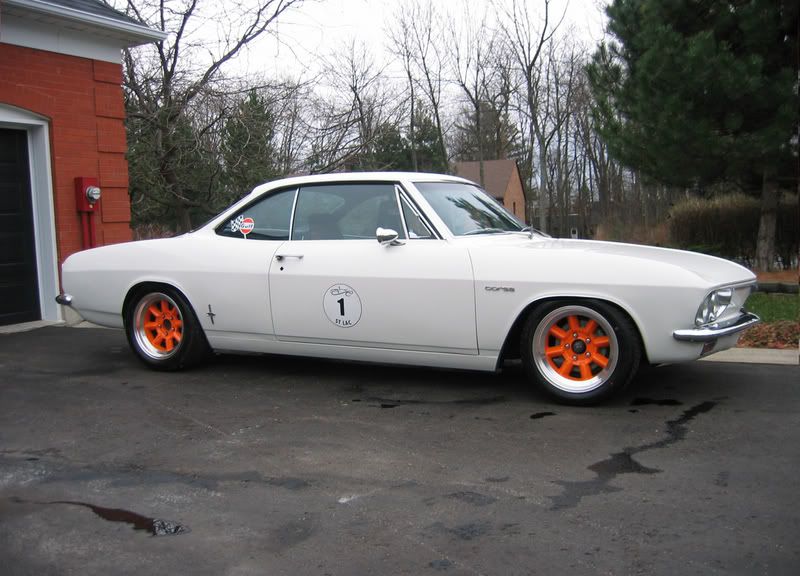

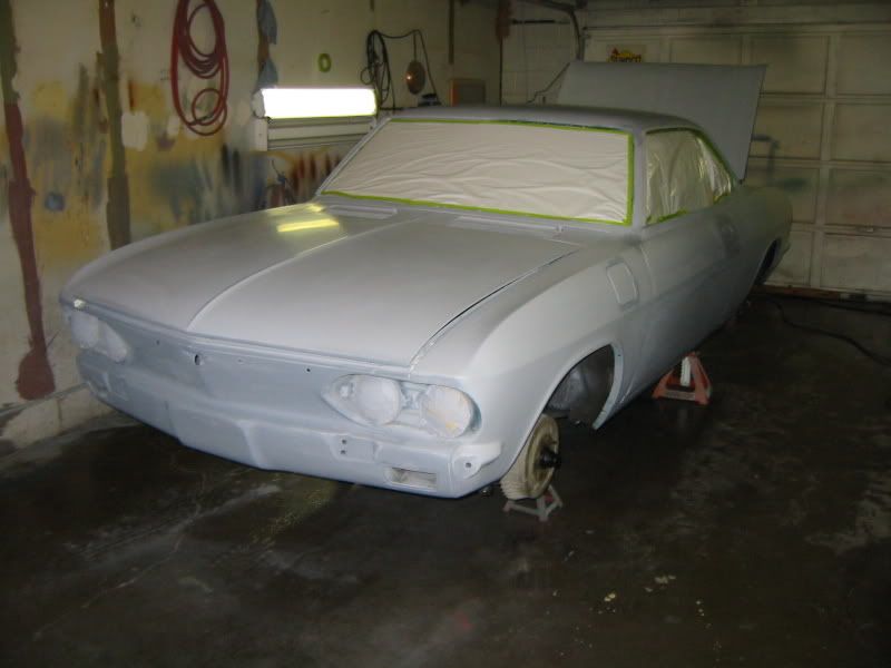

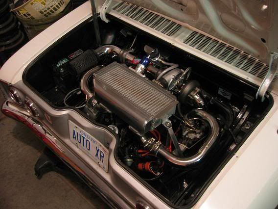

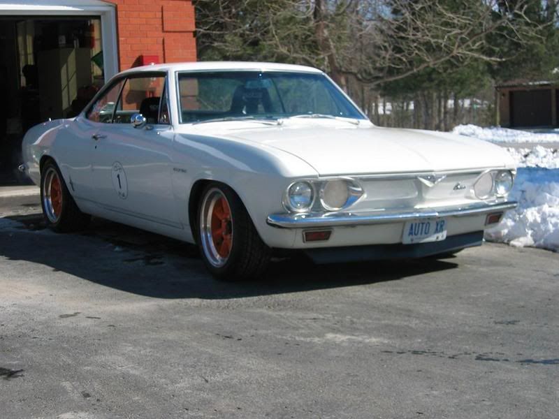

working on the GRM $2009 Car so much:
I have kind of forgotten about this..
When I got it
took it right to metal
66 Corvair turbo
-AZ car I brought up 3 years ago
-Single stage standox ermine white (painted by me)
-2.9L Flat 6
-TRW Forged Slugs, Milled 70 thou
-forged crank
-forged rods
-Arp bolts everywhere.
-packin 10L of oil in 2 coolers and the pan.
-T04E
-Turbonetics deltagate
-WRX intercooler
-Blow through ROchester carbs (sealed)
-Isky cam
-no muffler
-MSD 6A
-Crane ignition with Hall effect (no ghey points)
- New chome, new rubber (window door seals) , carpet, door panels
-Vintage wheel works VF48's , 16x8's and 9's
- 68 Camaro front spoiler
-12" front discs
-64 GTO aluminum Rear Drums
-Posi
-3.73's
A few more things (timing control) before I can really drive it.
Hoping to put down 250WHP at 12psi... and go from there. not too shabby for a 2300lb car
« Last Edit: September 03, 2009, 09:15:40 PM by Lowerit »

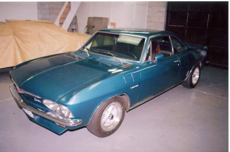

Just for shits and giggles...other projects..

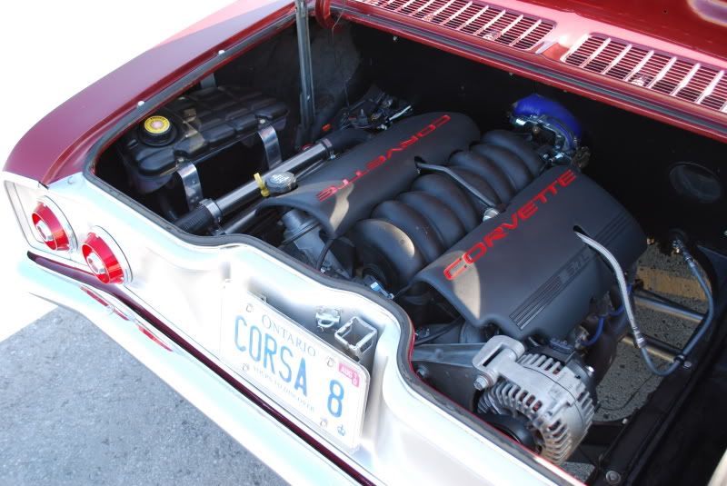

It's a family thing
LS1
Porsche 930 tranny
« Last Edit: September 03, 2009, 09:36:44 PM by Lowerit »

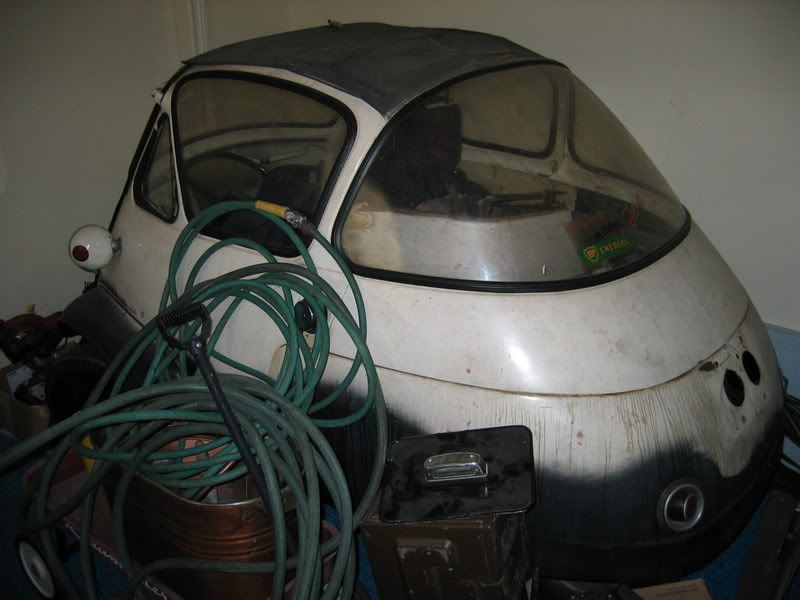

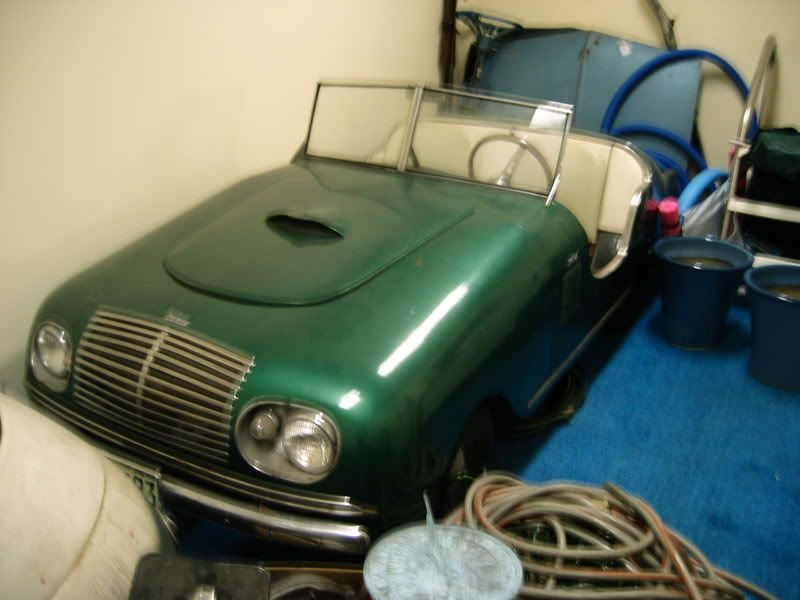

The White one is an Isetta .. I inherited it from my grandfather..
Who was a machinist and Fabricator...and built the green one from scratch.
right down to the wheels.  All the panels were done on an english wheel, no bondo , it's all lead paddled.  Powered by an Onan 4cyl.  the car was built in the mid 40's.
