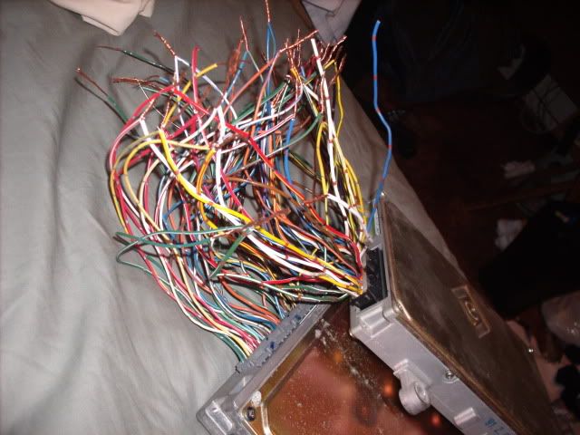

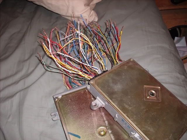

Ok its still a 100 degrees in Florida and I wanted to start doing my obd1 conversion. So I decided it would be easy to wire the obd1 plugs to a set of crx si plugs then just solder the crx plugs in wire for wire.
I also wanted to keep the stock plugs in case I wanted to convert it back to stock or break it in obd0 since I have a tune from my last build I could work off of.
Would there be any unforeseen problems running 2 sets of ecu plugs?
No im not going to run 2 ecus at the same time I will just electrical tape the ones not in use.

I have definitely read of people having issues with jumper harnesses and the +/- twisted pairs, especially when the jumpers have other wires coming between the two or when the jumper wires are very long.  The currents produce a magnetic field and they interfere with the +/- differently depending on proximity to the wires.  When I did my wiring I mad sure to keep the loops to a minimum, maybe 2 or 3 inches max of pair wire outside of the shielded casing.
True, Well Im just gonna leave around 3"pig tails and use the one set of obd1 plugs and start from scratch on my map. I haven't cut the car harness yet so I will make sure to leave that casings on and I know there is about 2" to 3" on the stock ecu plugs so I dont think it should be a problem.
I would be mad pissed if I soldered all 50+ wires then had to shorten all of them.
Thanks for the tip.
