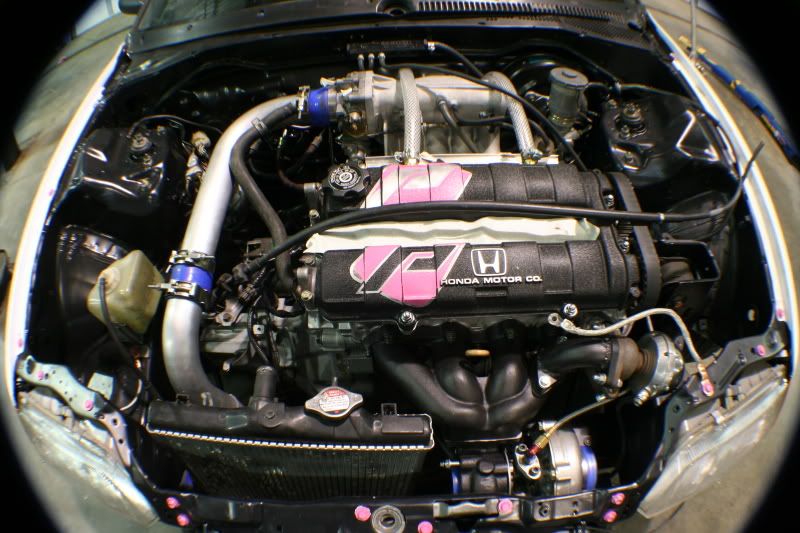

what is with the excessive amounts of pink?
Just for shits and giggles. My buddy's logo was gonna be pink, so I ran with it. He ran out of stickers though. So for now, he doesnt have a pink one on my car. I figure, the wife likes it, wont have too many followers and copy cats, it attracts some attention, and looks decent. And I like when all the AWD Factory Turbo Fags in my area see it, talk shit, and then cant keep up. LOL. Fuckin Subaru and EVO fags. Theyre a dime a dozen in Colorado. :(

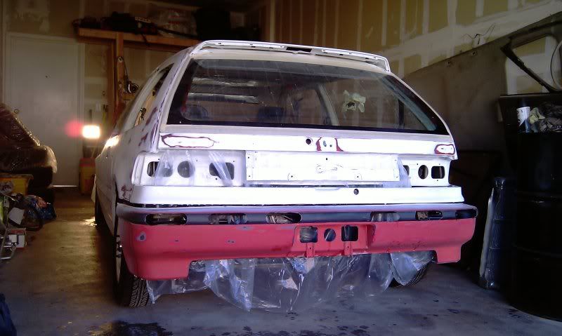

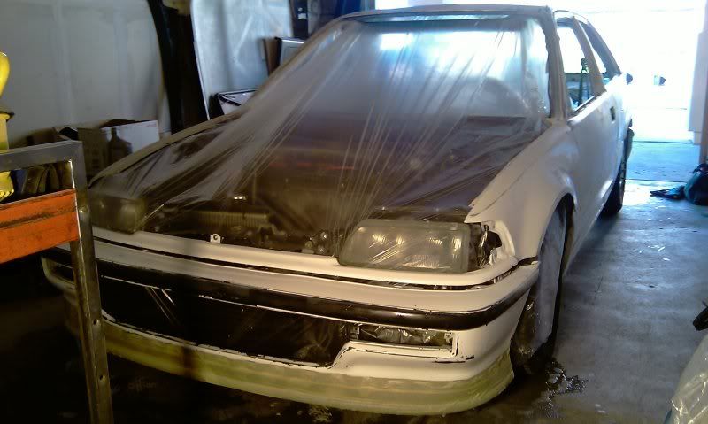

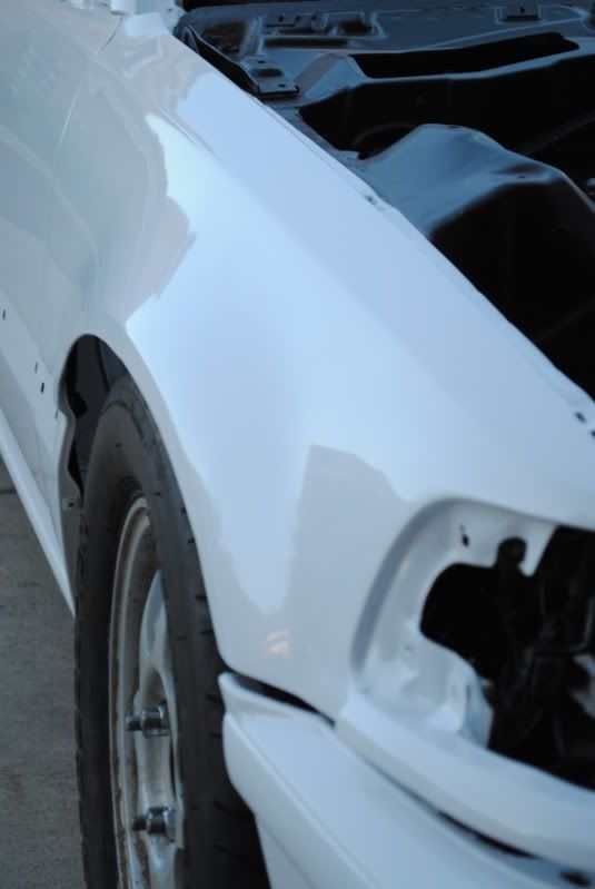

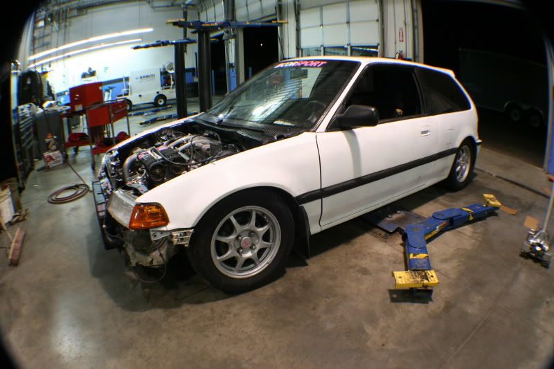

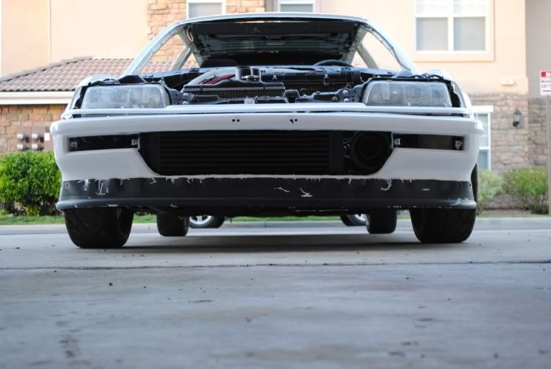

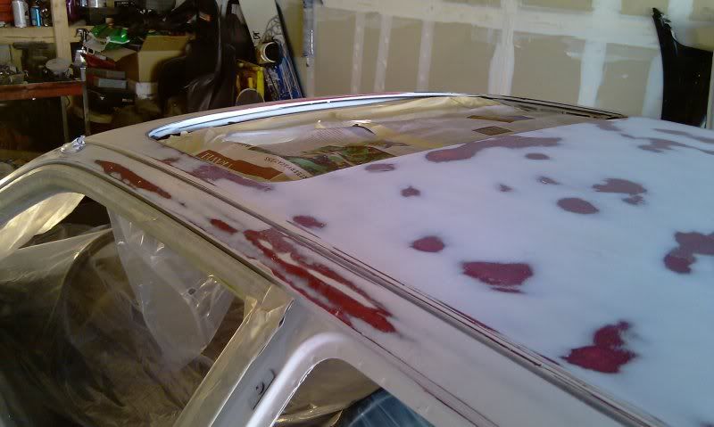

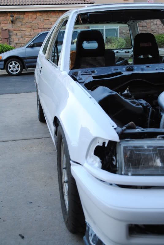

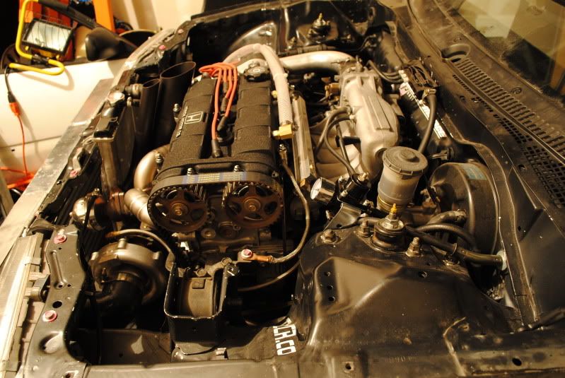

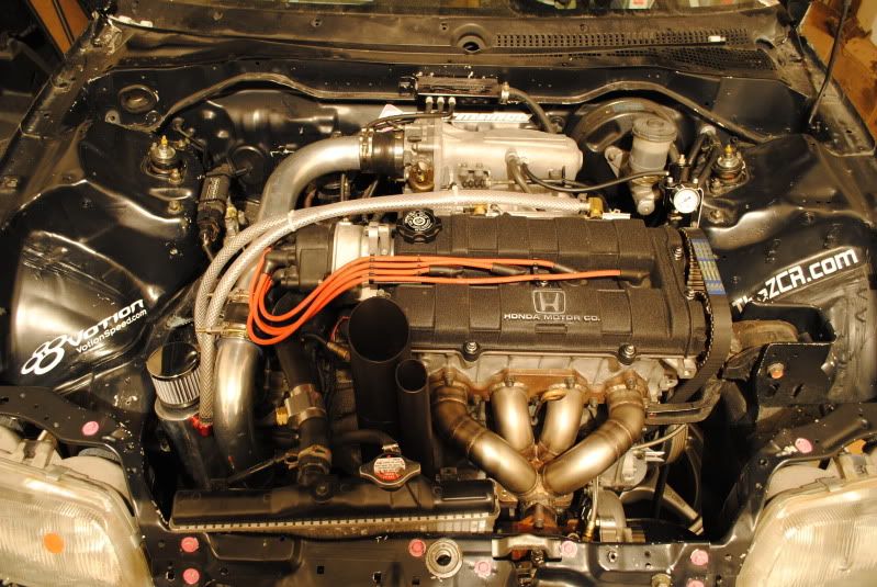

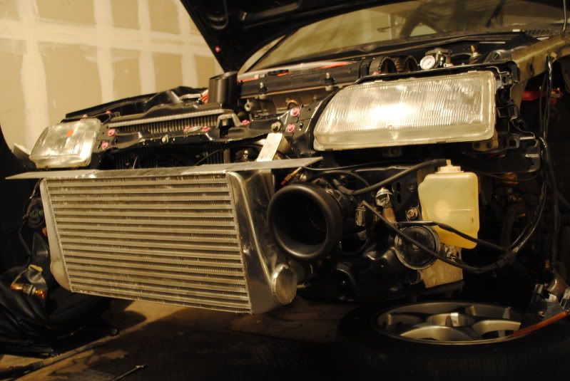

God damn it. I finally got on it and organized my PhotoBucket, and look at this shit. :( Oh well, fuck the old, in with the new. Hoping to have it running tomorrow. I was gonna paint first (some Rusto rolling), but its snowed the other day, and is gonna snow this weekend. So were gonna try and get a little tuning in before the snow hits. Im scrambling today to get it back on the ground.
Old:
And then:
And now:
Looks great so far but is that an ebay turbo? Just fo shits and grins?
PIMP!
theidealone
  • Posts: 670
Yea, eBay turbo. Cus I havent had the money to upgrade that yet, and its still spinnin.
Tried to get it running today, but I have no spark. Trying to find an OBD1 dizzy to borrow, so I can rule out that, or wiring. :(

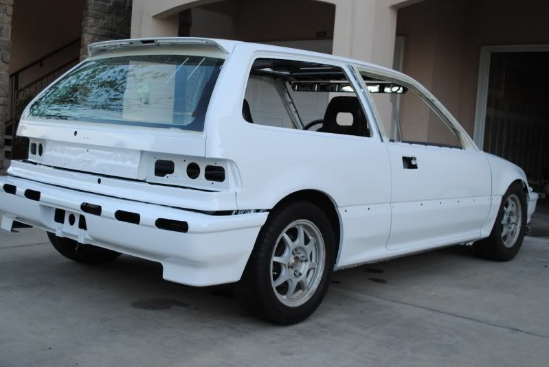

theidealone
  • Posts: 670

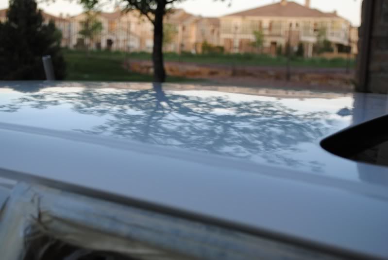

No videos yet, but I did get it running. Full Rusto Rolled paint job too. I still cant believe how good it looks, and I havent even sanded or buffed.
