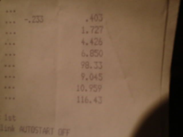

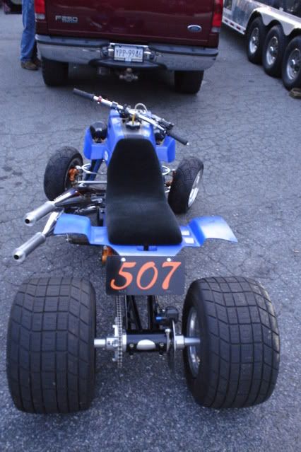

Went to Cecil County tonight.  Still have traction and gearing issues but not bad.
That is all

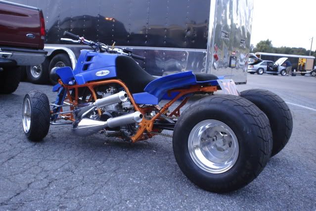

« Reply #27 on: September 26, 2009, 09:24:02 PM »
speficateshuns
I'll see how many I remember:
-610cc Cheetah motor
-Cheetah drag ported jugs
-16mm crank
-Billet Cases
-45mm Carbs
-Billet bowels
-1-4 Override Trans
-+12 swingarm
- -3 +2 A-Arms
-shortened axle w/ roundhouse carrier
-18t front 42t rear sprocket (going to change to 17t front)
-120 octane
I'm probably forgetting alot but the only thing left that's stock is the frame and shift forks.
