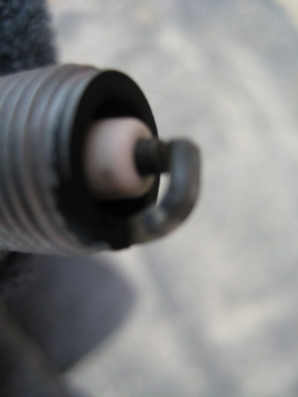

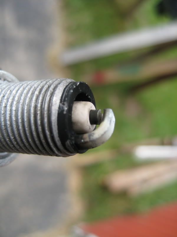

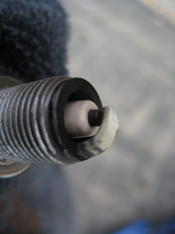

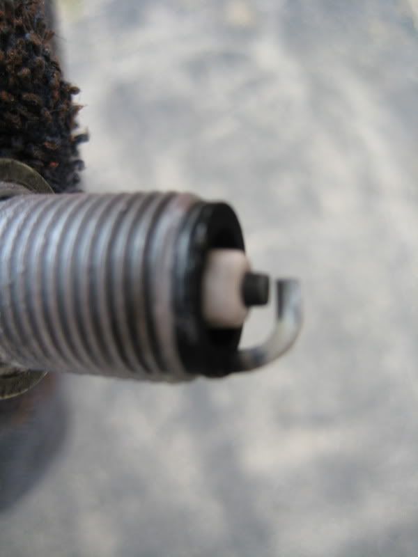

I finally got my setup back up and running and after a new wastegate/IM/TB it was still "fluttering" or surging, so I started adding in timing (alot) and its mostly gone, it seems to pull real hard and boost is almolst 100% steady, only flutters maybe 1-2psi.
I am running it now with a stock z6 timing map with only .1psi per pound retard. this is about 18psi and 11:1 afr
right at the top of a pull I killed the ignition and coasted into my driveway, pulled out the plugs and this is what they look like.

Fluttering?  Vitara engine with smallish Mitsu turbine?
The yellow-ish on the ground strap is oil.  This is common for a lot of Honda engines, if you look down your plug holes your pistons are either wet around the outside (!) or are totally wet all the way across (!!!).  Seek some goddamn crankcase ventilation.
Where the yellow breaks up... breaks up in two places between the 90 bend and the base of the plug well, I'd call the top and bottom clean bands the extents of your heat markings.  Depending on the temperature of the plug, you either need a colder plug or you need more timing.
The clean ceramic up top (on a fresh plug) is good, it shows that the idle and part throttle burn is clean.  Down deep in the well, where the burn reaches under boost, should have a nice golden brown or darker "burn ring," which can be very difficult to see with the hotter plugs as they recess further... you may need an otoscope or to cut the well away in order to see this correctly.  The fact that you have a smoke-like black residue makes me think your injector atomisation is shit, or you have a borderline misfire under load problem - not uncommon in a D-series, especially when you're running s 10.x:1 or lower AFR and it's misfiring smoothly so that the wideband reads 11:1 without the butt dyno throwing alarm bells.  To make any given horsepower figure, compared to any of the other Honda engines with bigger bores, you have to run a lot more combustion pressure... combustion pressure = high plug gap resistance, leads to misfires earlier.
Seriously, dude.  I could do a better job if you told me what engine, what plugs, what gap, hell what setup?

Also, are those plug threads glommed with anti-sieze?  Wipe that shit off.  It's GOOD to have on your plugs as you will wear out an aluminum head by yanking steel plugs in and out a lot, but you don't need much at all.  If that's a layer of anti-sieze, it's going to interfere with the plug's ability to shed heat, as it acts as an insulator.

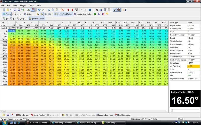

here's a screenshot of my high cam ignition map, it pulls nice and smooth up past 7,500rpm no ignition breakup.
Like I said the timing map is stock except I only pulled .1deg/lb you are saying it needs "more timing" as in advancing it furhter? I will hopefully get it on the dyno this coming weekend.

That's scary ignition timing.  I don't know how you aren't detonating, unless you are so rich you are misfiring in the higher boost.  Or.  Something else is wrong, as compressor surging that is fixed by adding timing is a sign that your timing is too retarded.  Got a Y8 cam in that sucker?
Where is your wideband grounded?
Here's a picture of the eCtune timing for a Vitara motor (that means stock length rod, the FJ long rod Vitara motors are called ABORTIONS aka defeating the purpose) with a T25.  I think the inertia dyno let me down, as this car also compressor surged in the midrange and adding 4-5 degrees into the lowcam (not pictured) as well as 2-3 degrees more in the high cam took care of that problem and the plugs/piston tops still looked tits.  This extra timing was added at a later IAT trim touchup session, and is not pictured.  FYI, car hits 17-18 psi by 3K and tapers to 12-13 psi by 6500-7000K, as well as eCtune does things a hair differently (as does Neptune, or Hyundaidata, etc) so take the timing figures as general idea and not directly applicable.
« Last Edit: October 05, 2009, 08:44:25 PM by Joseph Davis »

Yeah, Neptune with the ign adjustments turned off needs a fuck ton of timing in the maps.
20 pounds, 20 degrees is the rule I've been going by.

Put in a fresh set of plugs, and lean it out some and then post some more pics. Your idle and part throttle fat also? The yellow/white you see on the plugs is cadmium coating that ngk puts on their plugs.
Disagree.  It might be caused by coating + the presence of a quantity of oil, but the engines I see leaving it behind are the ones with wet pistons that burn oil without smoking.  There are plugs that it never forms on, and the pistons are always dry.

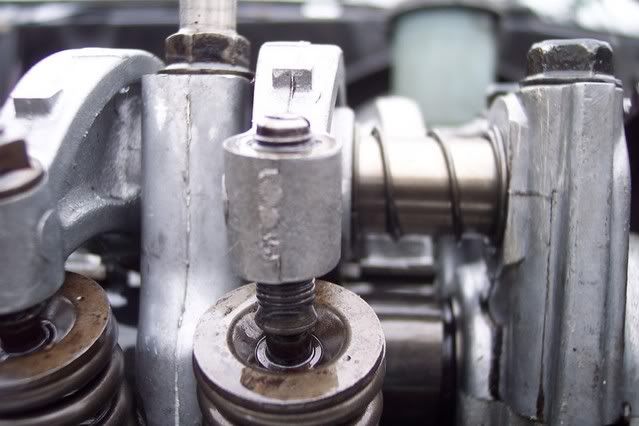

you would definitely be able to tell if you adjusted the valves. you would almost run out of adjustment and only have about half the threads in the locking nut...
pic of how much adjustment a 282 requires

Well I did have to re-adjust the lash, but not a whole lot. Anyway thanks for the responses guys, it has been pouring rain all day and I have to work in a coupple hours so there arent going to be any updates today.
