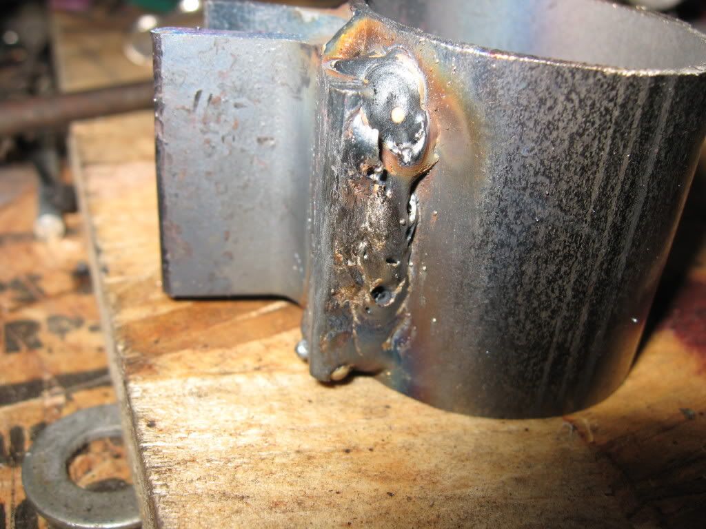

i been having this problem for a while i think it started when i got my last bottle of c25 but might be unrelated, sometimes right away or sometimes not till the end of a bead i get this crater lookin shitty holes in the welds i think it might have somthing to do with gas flow, i have it set around 20 with the trigger pulled, i cleaned my nozzle n shit not sure what else it could be..
heres a bead i put down

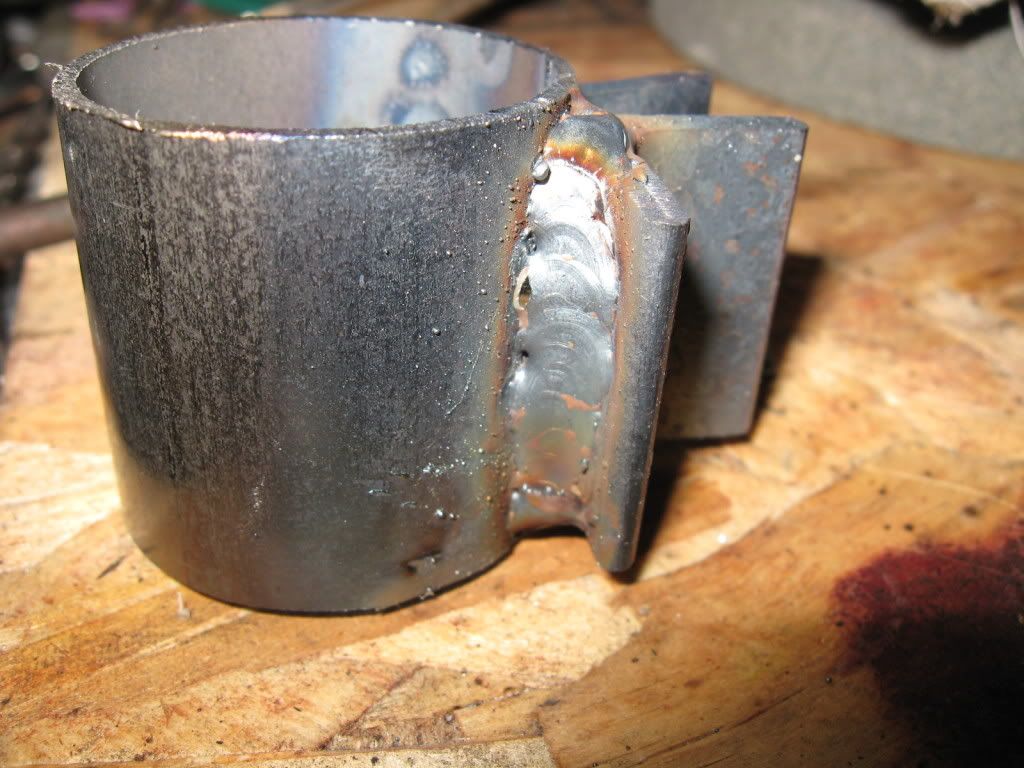

looks like shit, so i do another side right after and it looks pretty normal
Re: getting crap inconsistant welds *pics
« Reply #1 on: March 13, 2009, 07:00:22 AM »
Looks like a wire feeding issue from the pics. Are you using a long extension cord? Can you hear the machine struggle a bit as you move? Hows the ground clamp? Does it get hot while you weld?

no extension, the wire to the to the outlet from the panel is even new, and its not a very long run from the box, machine doesnt get hot at all on the outside at least, clamp looks ok? its a handler 187  and it only has about two 2lb spools through it its not even a yr old
i thought forsure it was a gas related issue cause one time i didnt turn the gas on it looked like shit and had holes like that in the welds but worse, only thing i can think of is the wire spool is to tight or somthing maybe? isnt there a test for that?

Welding without gas looks different.
Im thinking inconsistent wire feed.
Voltage look fine.
Make sure you don't have kink/bends in your gas line and the whip/gun cable/hose setup.

kinda looks like a wire feed issue. try cleaning the rollers with a scotch brite pad and also make sure the spool spins smooth. you want some slight tension but not much

thats not the problem i know it..  a wire feed or gas issue seems alot more beliveable

looks like
a, clean your metel first
b, looks like no penetraition
The 30psi king of rice
7808
  • Posts: 2513
« Reply #9 on: March 22, 2009, 01:39:26 AM »
shit was clean, it just looks wierd in the pics, it happens random on the same piece  so i know its somthing other then just plain poor prep,  and its penatrating exacly how i want it to, that larger tube goes over a fork of a motorcyle and needs to stay smooth inside, i belive its penatrating enough when its not doin whatever it is in the 1st pic

Lets go over the basics. You're welding 'towards' the unwelded section, 15* from perpendicular? Your wire spool nut is BARELY dragging? Your stinger's cable isn't kinked, and you weld with it as straight as you can? Your stinger's cable liner isn't fucked to hell from running rusty wire, etc? Your regulator isn't fucked up or partially clogged? Your C25 gas isn't shit (it happens!)?? Your ground clamp isn't coverd in shit, preventing a good ground?
If it does this even with a good cleaning, it's probably something from that list. If you aren't cleaning, there's a chance it hits some oil/etc that has enough gunk in it to cause some serious crap to form/displace the sheilding gas.

i weld both ways, push and pull, not sure why i just do whatever, usually either way they look good/the same , this just happens once and a while, i can get this holy shit, then do the same thing on the same piece and get different results, i think its gas or wire related not dirty metal, i guess poor ground could be too if its not clamping good..
i dont know how it looks in the picture but that is bare never coated mild steel that i hit with a bench grinder wire wheel before welding,  and i've made good welds on shit thats alot worse looking thats why i think its somthing else.. the regulator is only been on one other bottle sence new and its less then a year old, the nut on the spool seems to be adjusted right so fuck

feed is fine, ground is fine, its the gas
take the machine apart and check all internal connections, check the regulator, supply line & the supply line in your torches lead.
also take the tank back where you got it ASAP and tell them you have been having some major porosity problems with this tank of gas, while your other tank is fine. tank has water in it, or is improperly mixed.

oh and brush that scale/coating off the pipe

btw "clean" doesn't mean clean it with windex, or even a hard solvent like acetone or spirits. It means wire brushings and or grinding down to BARE FRESH METAL. That pipe you were welding looks like it has an alumanized coating on it with massive amounts of scale under that.
grind that shit to bare metal and weld another up.

 just ignore the pipe, i dont know why it looks like that, its mild steel (never aluminized) 1.5" exhaust pipe that i hit with a brush, i welded plenty of that shit with no problem looking like it did
it will do this on any metal, even painted metal i had to grind down bare so its forsure BARE ive had it happen..   ive welded all kinds of shitty shit - this shit is random and will hapen on bare ASS metal

That steel is hot rolled, not aluminized, and if you want good results you should grind it off.

i know what kinda pipe is its, ignore the work piece because it happens on bare clean metal too
i think whoever said porosity called it what it is, i googled some pictures of that shit and its what i was getting, didnt mater how clean the metal was i was welding.. i think somthing else was causing it , i exchanged my gas tank and checked all my shit over on my welder im gona see if it takes care of it..
from what i read, porosity = weak weld -   and i need to get my shit workin right so i can weld on my bike frame
