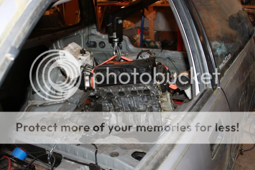

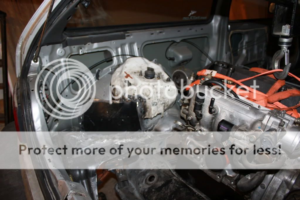

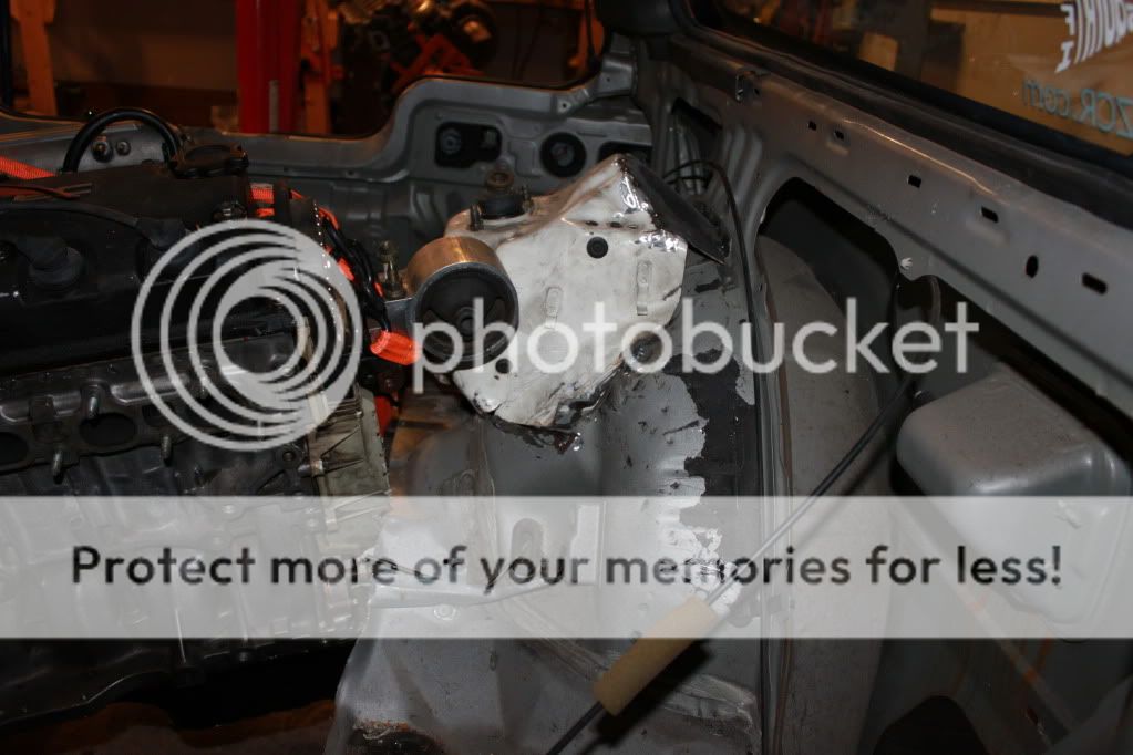

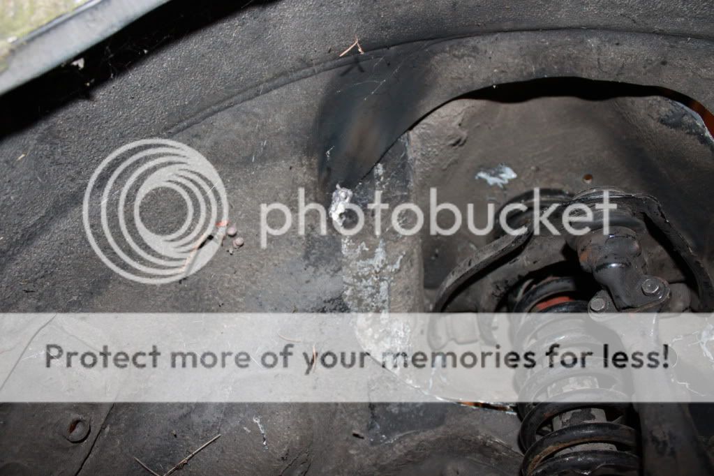

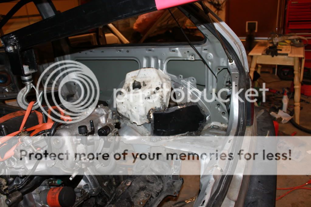

Well, I have been sick as hell for the last 4 days but I finally got out and back to work.  Started working on patching in the sheetmetal around the rear strut towers.  I also decided to toss the engine in again sense I now know where it is going to sit.  Looks like I am going to need to do a big notch in the frame on the drivers side to make room for the crank pulley as well as a little bit of persuasion with a hammer on the passenger side to make some room for the tranny. Good thing I didn't decide to try this with B's  It's already a tight fit.
Also, way harder then I could have predicted, but it is a fucking pain in the ass trying to move the trans and engine around in the back of the car.  I wasn't paying attention and almost buckled the roof with the cherry picker.   I think when it comes down to really stuff the thing in there I am just going to persuade a few friends with beer and pizza to come muscle the fucker in there.  Anyways, off to the picks.

nice project. Could you maybe one just the one alternator up front. Then you wouldn't really need the crank pulley in the back. Just an idea. Keep up the good work.
Re: Double Ds Dual engine monster
« Reply #83 on: October 26, 2009, 12:55:43 AM »
Was already planning on only running one alternator.  I think you still need the pully for balancing though.  Also either need it or need to make something to hole the timing gear on.

Think outside the box...again. Since you have a roof over your engine, secure the front of the car, and use the hoist to pick up the car itself. Lay the motor on some wood (on ground), and lower the car onto it. If you built a dolly for the motor, you could keep it upright ready to bolt in, and move it where ever you need to.
I'm sure more than a few of us have done that with their Hondas, jacked up the front, support it with a few 2x4's in very unsafe locations, and push the engine in from the front or side while praying. :mexi:

Will probably do that later.  At this time I dont want to move the car around to much until I finish getting everything braced and solid.
