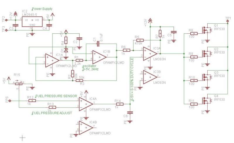

this is the fuel pump control module i'm working on, but it could be used for WI too.
the oscillator section produces a 2kHz triangle wave, 0-5v p-p.
the LM393 compares the triangle wave to a reference voltage. 0v= 0% DC, 5v=100% DC.
the bottom opamp takes a manifold referenced fuel pressure sensor input and a reference voltage that equates to the desired fuel pressure. if fuel pressure is above desired pressure, the opamp's output drops, reducing the voltage on the inverting input of the LM393, reducing fuel pump duty cycle until the fuel pressure is equal to the desired pressure. it's a closed loop system, since the bottom opamp will output the voltage necessary to get the pressure sensor's voltage equal to the desired pressure voltage. the RC filter on the output of the opamp keeps the voltage from swinging too fast.
the output stage is 4xIRF530 MOSFETs in parallel to reduce RDSon. this drives the fuel pump with a PWM signal that measures fuel pressure and increases/decreases pump drive duty cycle to maintain fuel pressure. no need for a regulator. fuel pressure sensor can trip a failsafe/idiot light too if fuel pressure drops off. it's also possible to use the MAP sensor to ramp fuel pressure at higher boost for more flow without using huge injectors.

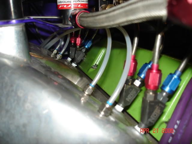

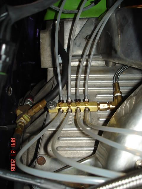

I like the use of nylon tubing and compression fittings there.  JD are you intimate with that setup?  Are their nozzles attached to those compression fittings somehow?  Or are they one piece, the nozzle and the fitting?  And if so, where can I find some?  I was just admiring that pwm controller how-to.  An old fuel pump, a homemade pwm controller, and some cheap brass fittings sound like a sweet setup to me.
Re: Advice needed: want to build water/meth injection controller
« Reply #44 on: April 28, 2010, 12:08:28 AM »
There are nozzles, yes.  Some of the high-end WI sites sell the paraphernalia.
