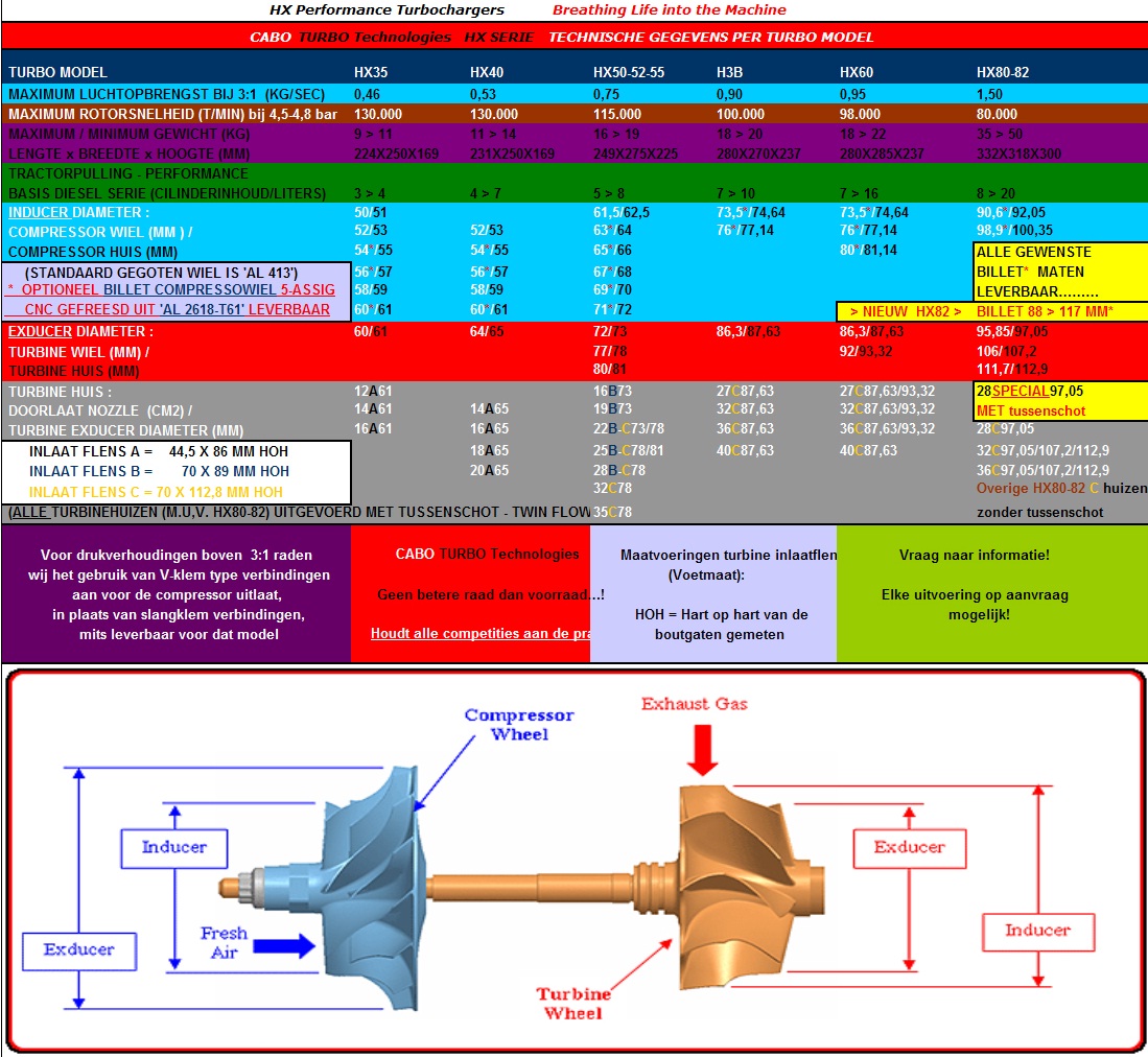

Here is a handy little chart to use.  :noel:

What A/R size is my Holset turbine housing?
Holset don’t use A/R, they, like Mitsubishi, KKK, Trust, and others, use cm2 to measure turbine housing size.
A/R and cm2 isn’t directly comparable, cm2 is a static measurement, A/R isn’t, but you can still get pretty close if you want to compare. On a HX35/GT35 sized turbine wheels, 12cm is generally accepted to be about 0.89 A/R, but the larger the turbo the smaller A/R any given cm2 would be the equivalent of, with 14cm generally being considered to be just A/R 0.80 on GT40/HX40/S300 sized turbine wheels, and conversely, on a tiny turbine a 6cm housing could still be the equivalent of A/R 0.80.
Because of this use your common sense, use your eyes, and do your research. A 25cm HX55 might sound like a super huge housing when you’re used to 9cm housings on HY35s, but a HX55 is practically twice the size and a 25cm housing is actually not that big.
You can use the housing sizes on other stuff as comparisons too. With most Subaru turbos using cm2, and Mitsubishi Evo ones also, you can compare those to the similar smaller Holsets.
And for bigger ones, well the famous Trust turbos used on countless big power Japanese cars used cm2 as well. The T88 34D, a 1000bhp capable unit, like an older fashioned version of a HX55, and often seen on Skylines, Supras, and RX7s, tended to be a 22cm housing, as was the 38GK version. The Trust T78, a 700bhp turbo, so HX40/HX50 size, but older fashioned, was generally 17 to 24cm housings. The Trust T67 turbo, similar to a HY35 in capability, but again, older design, also had similar housing sizes, 8cm and 10cm most commonly, but 12cm and 16cm was also used. Even Trust’s version of the TD04, good for ~300bhp, used a 8.5cm housing.
There's a common list of A/R to CM2 that goes around the internet, and it's spoken about and published by people who make out they're experts in the field, but IMO it hints at how clueless they really are, and it says this...
6 cm2 = 0.41 A/R
7 cm2 = 0.49 A/R
8 cm2 = 0.57 A/R
9 cm2 = 0.65 A/R
10 cm2 = 0.73 A/R
11 cm2 = 0.81 A/R
12 cm2 = 0.89 A/R
14 cm2 = 1.05 A/R
16 cm2 = 1.21 A/R
18 cm2 = 1.37 A/R
21 cm2 = 1.61 A/R
NO! Fuck no. As said, A/R vs CM2 totally depends on the turbine size, and the above is only about right for TD04 sort of size turbines.
In REALITY, it's more like THIS...
HE221W- 6cm- 0.47, 8cm- 0.60, 9cm- 0.68
HX35- 16cm- 0.98, 14cm- 0.90, 12cm- 0.80, 10cm- 0.65
HX40- 18cm- 1.05, 16cm- 0.92, 14cm- 0.85
HX52- 16cm- 0.85, 13cm- 0.73, 11cm- 0.60
HX55- 28cm- 1.42, 25cm- 1.26, 19cm- 0.96, 16cm- 0.78, 14cm- 0.71, 12cm- 0.62
And obviously, any turbos that are in between sizes of the above for their turbines, so HY35, HX32, whatever, you can extrapolate from there obviously...
