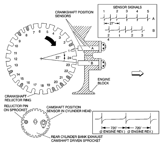

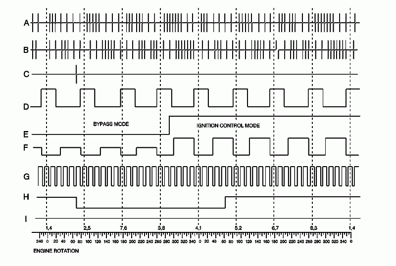

here's the outputs for the N* module.
from here: http://www.lukeskaff.com/car/northstar/theory.html
the trigger wheel is effectively a 24 tooth wheel with extra notches cut into several of the teeth. it uses 2 position sensors, but i believe if one of the sensors fails, the 4x signal is still active, but the 24x signal stops. it allows the engine to keep running in the case of a sensor failure.
 it has a 24x and a 4x crank signal, so the 4x could be used as a ref pulse for a V8 engine. the ECM only needs one edge per cylinder TDC event. it uses a divider in the code to calculate RPM based on the time between the ref pulses and the divider. so as long as it's getting 4x signal per crank revolution it will work.
there's info on using the C3DI coilpacks too, but i can't find it right now.
