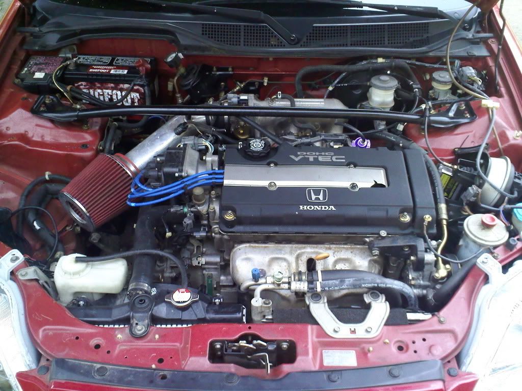

I read somewhere can be a sign of a fuel filter, but just doesn't seem right. However I have noticed this nice purple JDM bling bling supa fast FPR on there. Could it be that the thing is applying too much fuel when it's cold and not warmed up all the way? Can see it here

Those FPR's are the worst pieces of shit ever manufactured from china, ever. Immediately remove and replace with a big exit b-series. I doubt it is your problem, but none the less that thing is a piece of shit and is definitely not helping.

What are big exit b-series fpr's found on?
Re: Car dies on cold mornings
« Reply #10 on: October 30, 2009, 01:42:51 PM »
I have found the 1st gen b16a and 90-93 integras had the large side exit fpr's
Even the newer b series fpr's have a larger exit than d series units.
