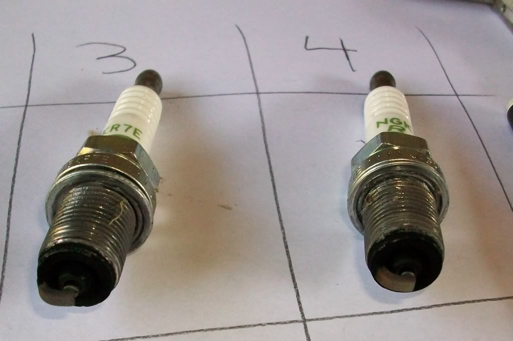

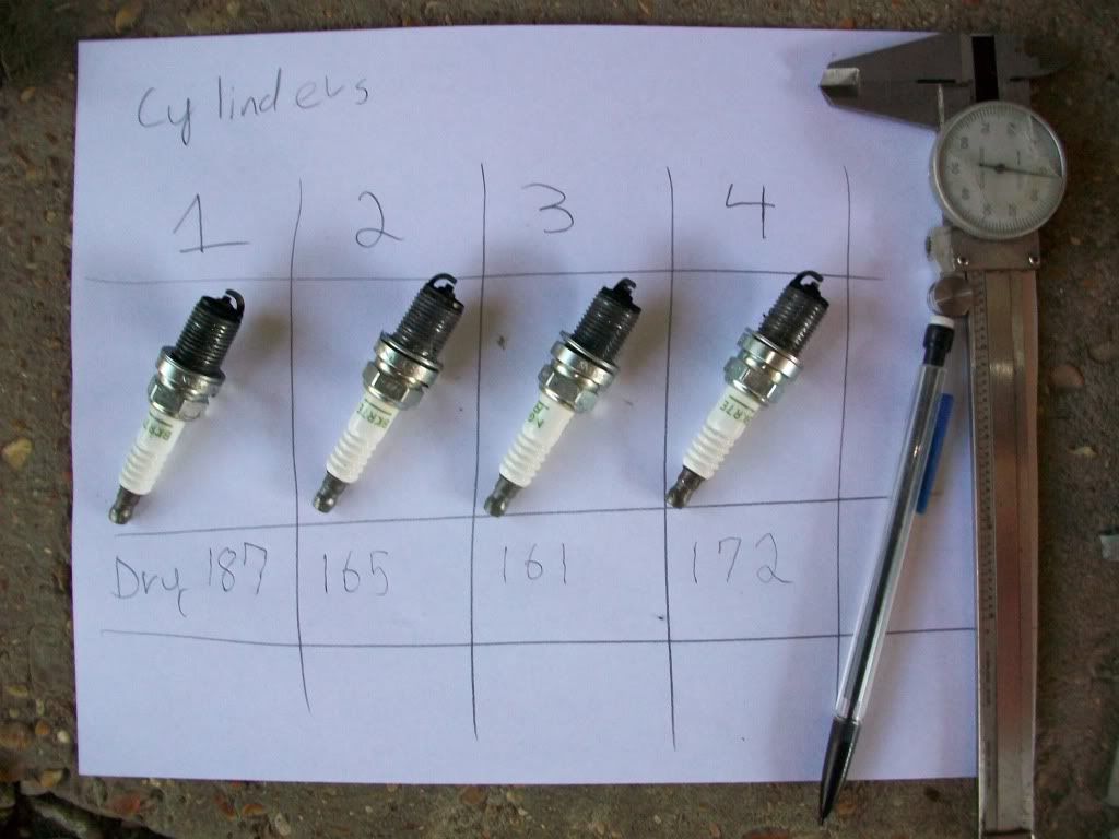

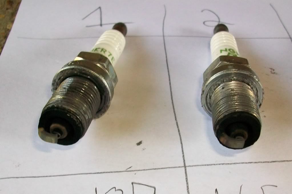

Well, before I turbo'd it the compression was 185 on cylinders 1 and 4, 165 on cylinders 2 and 3. A leakdown test showed the exhaust valves leaked a spec on cylinder 2&3.
Just checked the compression after 10 months of boost. Hot engine, all the plugs were out during the test, throttle wide open.
Compression looks Ok to me. Plugs are black from runing a cold plug rich, but they otherwise look fine.
So, wtf would make it smoke so bad? This morning I was letting the car idle a few minutes and saw a cloud of smoke from the corner of my eye. I almost reached for the fire extinguisher till I realized it was blue-smoke. Got out, and sure enough it was coming from the exhaust pretty bad. Rev'd it up and it blew a good bit out, and sorta cleared up some. I just killed it and went to class.
Then when I got out of class I fired it up, no smoke. Drove it some, no smoke. Boosted the shit out of it, no smoke. Now it's not smoking at all.

7's are not cold for your setup.  You either had an atomisation problem, or much more likely based off of how sooty the ground strap and the well is you were running way too rich.  How did you log your wideband when tuning?

187/165 would be 13%, ideally you'd be at 5-10% variance. Not the best, but it's an abused old motor, by the low standards Miata probably intended for it.
Bad rings lead to a clear-blue smoke while driving, and half-burned oil leads to white-blue smoke. Unburnt particulate oil is sooty black like gasoline. As mentioned before, it's probably some leaky exhaust valves or a slight leak from your turbine. That would lead to whitish oil after sitting for a while, since it would sloooowly leak out.

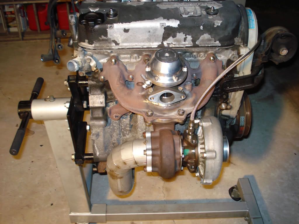

Pat, you're turbo'd aren't you?  Have you checked your turbo?  When my turbo was dying it would leak oil into the exhaust, but it would only be noticeable after stopping and idling for a bit and then you would see smoke when accelerating/revving.

Yes it tubo, new GT3271 10 months old/ ~10K miles on it. zero shaft play, no signs of oil in the compressor discharge. But yeah, it could have been through the turbine. Strangely it has not done it again.
