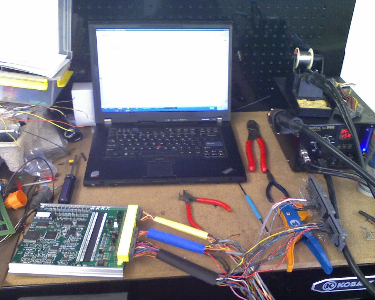

It's pretty easy.  Go to the AEMPower Forums and download the user manuals for the 30-1030 box and for whichever of the K-series boxes is applicable to your chassis.  It lists pin for pinout, make your conversion harness accordingly.  Then flash the 1030 box with the calibration for the K-series box you built the conversion harness for, and get to tuning.  If you fuck anything up I'll give you some money on the AEM.  :P
I just made another conversion harness for the heavyslut St00pra Goforth just traded for, 30-1000 box:
