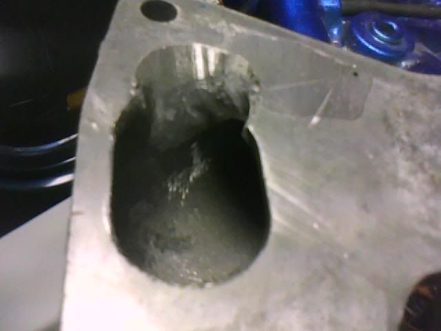

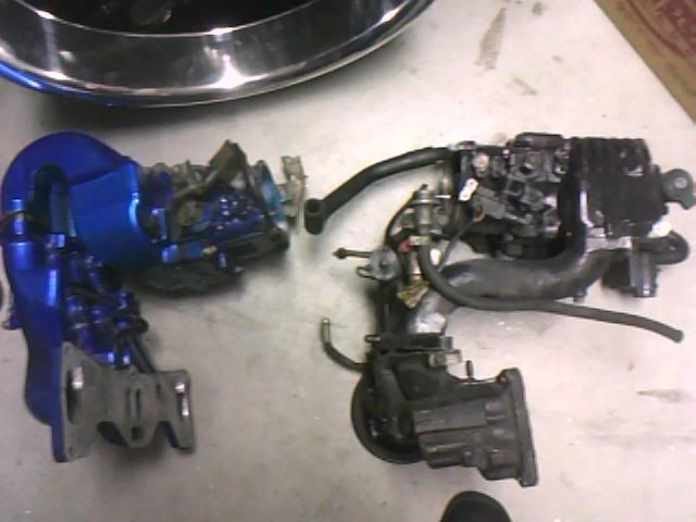

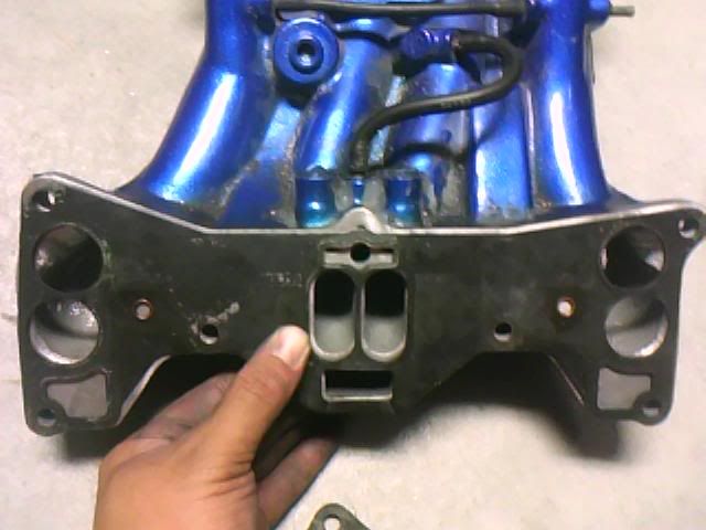

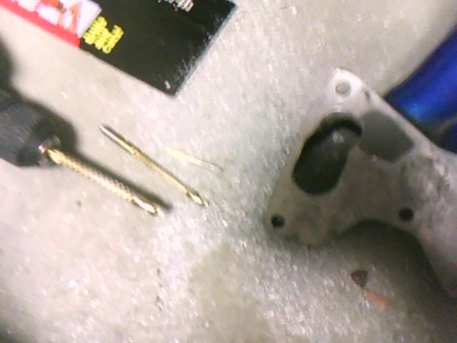

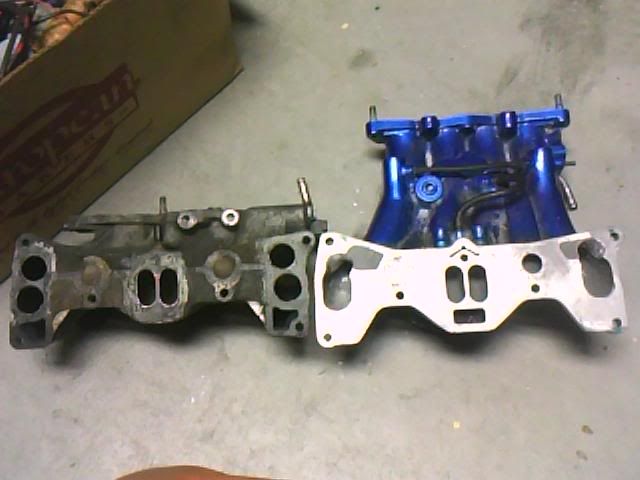

I decided that spending an hour to take off the turbo/ intake manifold was to long. So I wanted to switch from the n/a six port, to the turbo four port intake manifold. So i had to port the shit to fit. I dont have a compressor, so i had to use a drill with a drill-saw bit.
Turbo left, n/a right 5 extra inches of clearance  :o

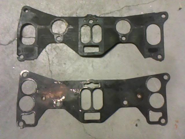

Turbo gasket on top. Have to woller out the turbo manifold to the size of the n/a manifold

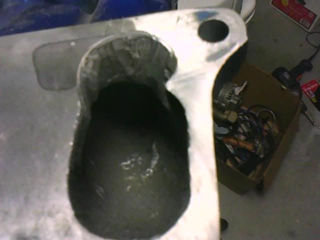

Drill saw cuts through aluminum like butter.
Had to fill in some casting voids with jb weld.
Came out good enough without a die grinder or dremel.

Your porting looks like ass. Why didn't you finish it?
Re: intake manifold porting/swap
« Reply #6 on: November 06, 2009, 01:26:47 PM »
No kidding. In the time he spent taking the pics and posting this thread he could have ported it better.
oinesra
« Reply #7 on: November 06, 2009, 01:31:50 PM »
Well like I said dip shits, all I had was a drill and a drill saw. Plus these wernt final pics, just some I grabbed 3/4 of the way in.
And does it fucking matter? Is boosted, as long as the air makes it into the motor im happy.
