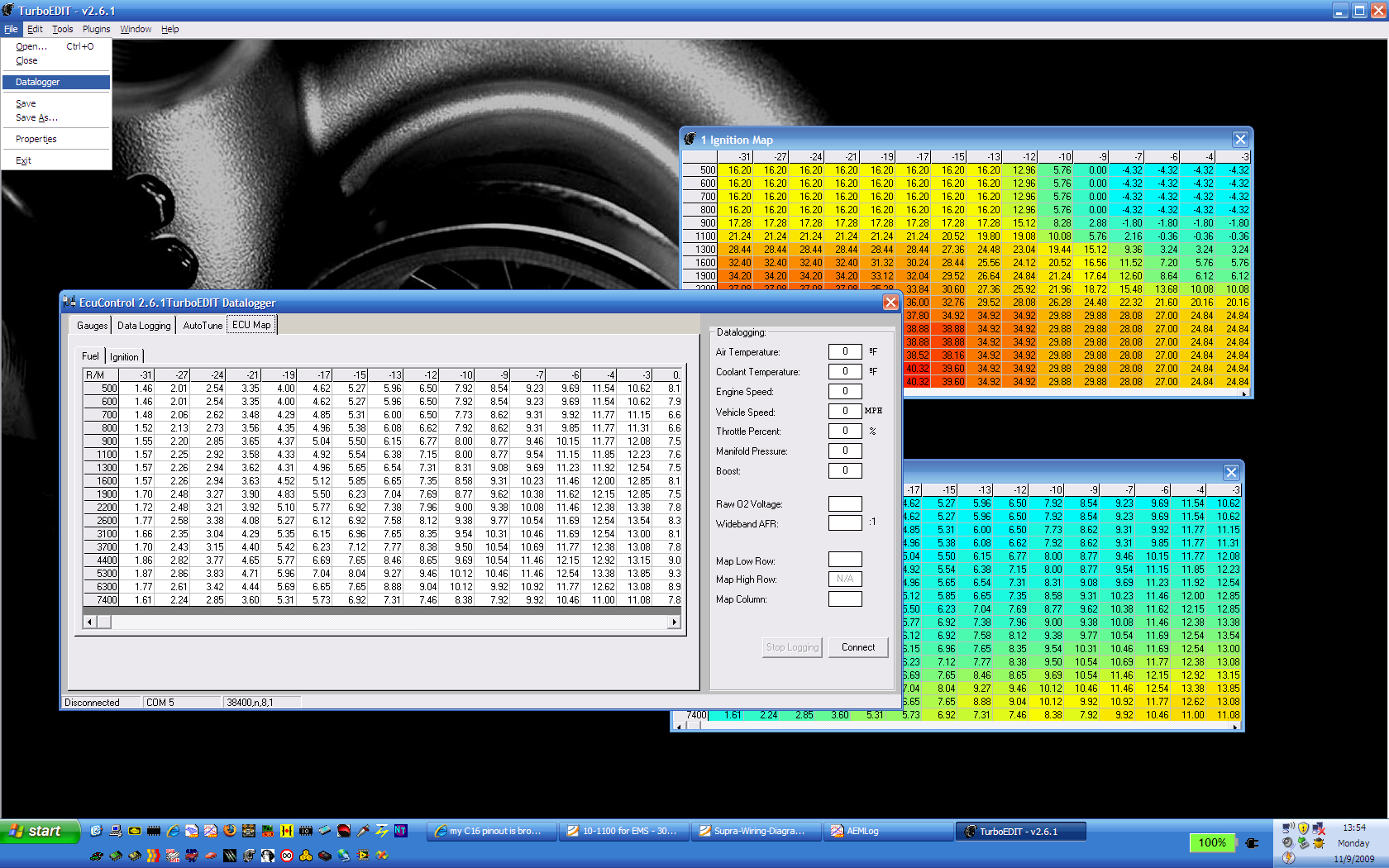

this is what i meant about datalog with ecu control..
with engine working, not value is "reading".

look this vid i just uploaded.
im using Turbo EDIT PRO 3.1.10 with ECU Control plugging, samething as you means.
just notice my AFR in EC (ecucontrol) , doesnt works.
i hope someone can help me about connect uego to my ecu using my wiring shit.

« Reply #22 on: November 29, 2009, 07:48:27 PM »
was fucking map, i made my own basemap and now can get aft in ecucontrol  :yes:
